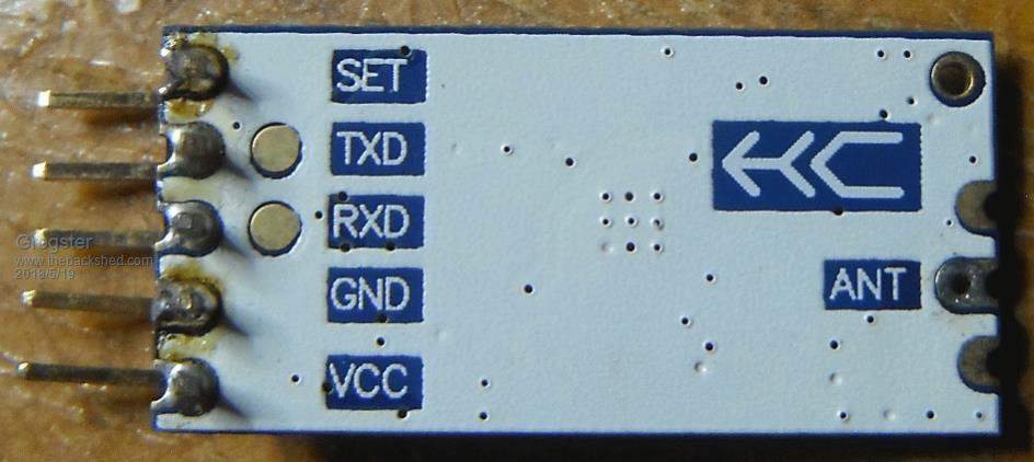

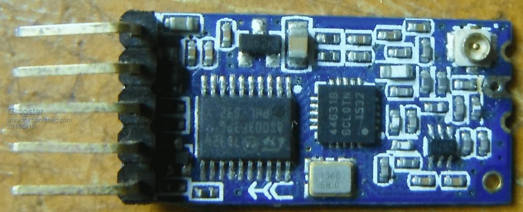

I think Paul is talking about this variant:
I have two of these ones. They have the same thick silkscreen on the bottom and T300 crystal, but DON'T have the web address on the rear. These ones I bought years and years ago when the HC-12 was a kinda new thing available to replace the HC-11. These ones are also spot-on frequency, and were the ones I used to initially find the off-frequency issue in the first place, cos I knew that those two were tested and working fine. They have subsequently been tested again to make sure I was thinking the right thing, and these ones(along with the new genuine ones) always work, and are on frequency when tested.
EDIT: I think these ones are the genuine article(due to my getting these ones years and years ago), but probably just the first production run which is why they don't have the web address on the bottom silkscreen. MHOO.Edited by Grogster 2018-05-20

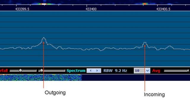

Inspired by Boppa et al I managed to get my RTL-SDR running (my settings will be R/S, I have little idea of what I am doing and it looks to be a different version - I'm running XP).
As I confessed above, I am pretty sure that I have fake & clone HC-12s.
I set up a little test rig (an HC-12 and a MM) that listens to my HC-12 network and as soon as a transmission is received (about every 10 seconds) it re-transmits it.
If I understand the attached picture correctly, the remote HC-12 transmits at ~400Hz above 433.4MHz (shown as "Incoming") and the HC-12 on my test rig is transmitting at ~300Hz below (shown as "Outgoing").
Should they not BOTH be at 433.400MHz?
Andrew
Posted: 03:15am 20 May 2018
Andrew
I am not sure what transmission protocol is used but you are likely to be seeing two peaks from the one device.
You will not have the local and remote devices transmitting at the same time, so if there is a difference, you will see the peak (or pair of peaks) shifting slightly depending on which device is transmitting.
Andrew_G
Joined: 18/10/2016
Posts: 917
Posted: 03:51am 20 May 2018
Hi Jim, thanks,
all my HC-12s are set to 2400, FU2 on the first channel (433.400MHz). I'm pretty sure that the RH "Incoming" peak is the the remote network reporting in every 10 seconds and that the LH "Outgoing" is the re-broadcast from my local test rig - if I turn the rig off I still see the RH peak BUT not the LH one ('cause its not being sent).
(the peaks are a different height because the RH one, which is a split second older, had decayed a little before I took the screen shot)
Does that make sense or am I very confused?
Cheers,
Andrew

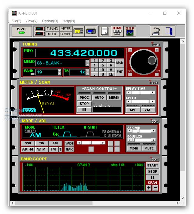

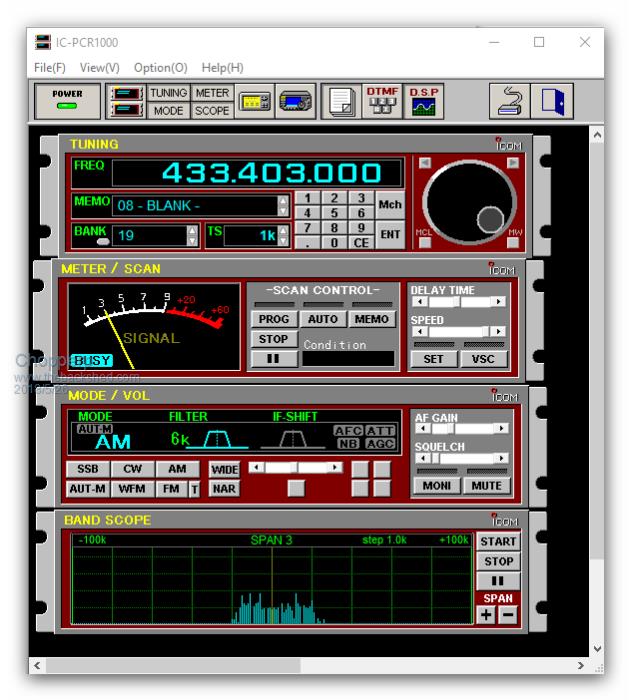

I've borrowed an ICOM IC-PRC1000 Comms Receiver, & tuned to one of my HC-12's on Ch1, 433.4MHz transmitting GPS data once a sec, using the ICOM software.
The frequency spread is about 40kHz & appears to be centred at about 433.403MHz, but according to the meter, the maximum signal level is at about 433.420MHz.
So really none the wiser as to weather it is off frequency or not. Need to compare it with a known good one.
ChopperP

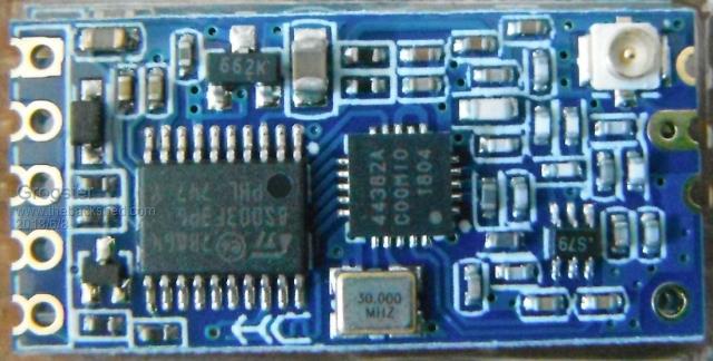

Posts: 10116
Posted: 11:48pm 07 Jun 2018

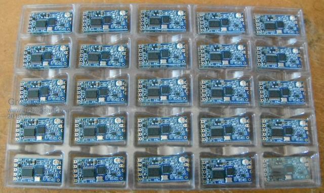

I have received my genuine HC12's from hc01.com.
There are two layers of 25pcs here. One is missing in bottom-right of the photo, as I promptly put one on test.
Interestingly, THESE ones have the crystal marked as "30.000MHZ"!!!!
They ARE spot-on frequency though, as would be expected with the genuine article. So either hc01 tweaked their firmware to work with those crystals, or they are simply genuine crystals rather then off-spec clones or manufacturers duds. Most likely the latter.
