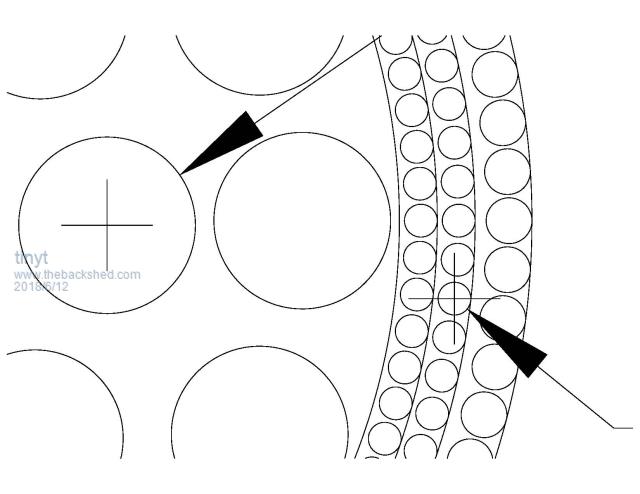

  tinyt said
Ah yes, I started out with such a drawing on my first toroid rewind.
Sadly, theoretical space and practical space for the wires are *not* the same.
You will find it just about impossible (winding by hand) to lay the wires neatly along each other in the toroid hole. A winding machine with terriffic wire tension and controlled advance 'could' do that, your hands cannot.
The layers will also build up more than shown in your drawing, especially if you fit tape insulation between layers.
So, plan for perhaps 5-10% less turns per layer than theoretically possible and space them accordingly. If you find, for example, you 'could' fit 100 turns try for 90 per layer.
If this looks like a winding layer will not complete a full circle of the toroid, perhaps only 3/4 of the way around, space all turns on this layer so they are evenly distributed around the toroid circumference.
I would recommend to wind *one* layer at a time of your secondary, then coat it with epoxy resin, let it harden, then continue.
Yes, this takes a 'lot' longer but you end up with a silent toroid. Individual turns moving against each other in strong magnetic fields is 'not' good. They will move since hand winding does lot lock them in place sufficiently, especially with thicker wire, >1mm diameter perhaps.
Thanks Klaus for the warning. In my sketch, even though I made provisions for the tape layers and the array of wires for the two layers turned out to be the needed 115 wires, you are correct that it is only theoretical.
I will find out when I wind the first added layer.
The original inner layer that I kept which probably were machine wound did not have any varnish. I did not have epoxy resin but I have left over polyurethane varnish, so that is what I used on this layer. Will buy and use epoxy resin for my hand wound layers.

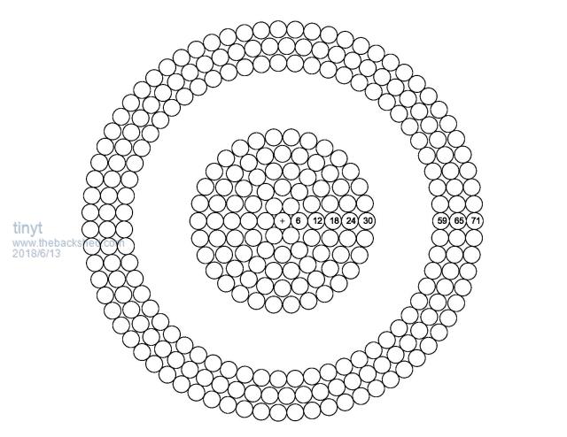

Getting back to the toroid winding thing...
Circles are amazing things, and building up multi stranded cables is similar in concept to winding a toroid, but in reverse.
With a multistranded cable you start out with one strand right in the middle.
The first layer to go over that has six strands which fit perfectly around the middle strand (giving 6+1 = 7 wires)
Now if you fit another layer around all that, twelve more strands fit perfectly around your seven existing strands (giving 1+6+12 = 19 wires)
The amazing thing though, is that every new layer adds exactly six more strands than the layer immediately underneath to the total. The next layer would be 1+6+12+18 = 37 total wires)
The significance of this for toroid winding, is that whatever fits on a particular layer, the next layer to go over that, is only going to theoretically have enough room for six fewer turns than the layer immediately underneath. And that six turn deficit holds for every additional new layer, as the hole area dramatically shrinks.
All that assumes perfectly placed turns and no insulation between layers. In the real world it might be closer to seven, eight, or nine fewer turns per layer depending on how neatly the whole thing can be made.
But its a handy trick to know when estimating what might possibly fit when a particular winding is going to take up multiple layers.Edited by Warpspeed 2018-06-13

Thanks for the tip Tony. I am a visual guy, so:

I sometimes have dreams about this stuff, and I already knew about the six turns per layer rule with bundled cables.
Then one day it suddenly hit me in a flash of inspiration that it must also apply to toroids as well, and it does...
It never works out quite so perfect in practice, but with a bit of an additional safety fudge factor, it definitely gives a very useful insight.

  Tinker said   And there is myself, picturing you sitting there and drawing all those tiny circles one by one....
Is it fun?
Only one of the circles shown were drawn in autocad: click on circle icon, click on drawing window location, select radius or diameter, key in diameter.
The rest were polar arrays of copies of the drawn circle. Was fun to see the 'rithmetic automagically drawn.

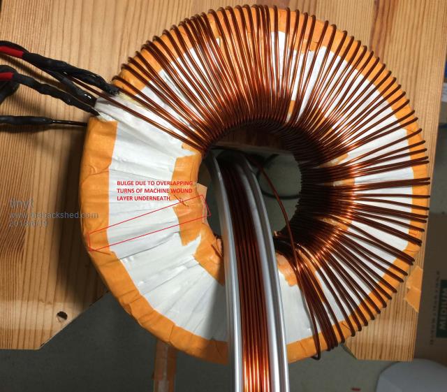

Partial winding of added 115vac section. Because the existing machine wound layer underneath has overlapping turns in several places, I was not able to place all wires inside the toroid side by side. And that is my excuse,haha.
