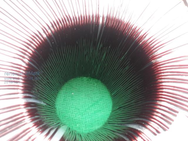

This is the inside of the 3rd winding. Starting to look pretty tight, bit worried if I tried another the turns may need to overlap in the centre and not leave enough room for the primary.
