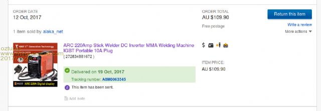

It was this one
http://www.ebay.com.au/itm/ARC-220Amp-Stick-Welder-DC-Inverter-MMA-Welding-Machine-IGBT-Portable-10A-Plug/272834881672?s sPageName=STRK%3AMEBIDX%3AIT&_trksid=p2057872.m2749.l2649
With the extra turn, it works straight away. I took it to 60 amps, but no more as I only put 1.8mm wire on the secondary.... at 40 amps it was fine actually... there is a strong wind inside of it ( fan).

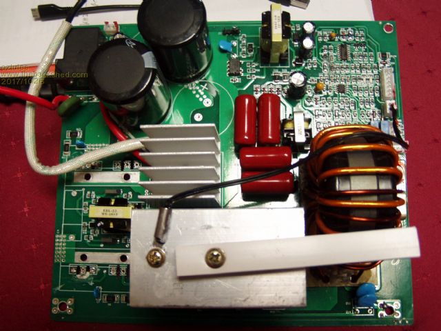

It looks like this:
There are two heat sinks missing, as the smoke managed to dribble out of the igbt's, but it gives a better look at the topology anyway.

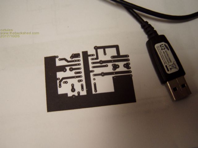

Here is my tentative board to drive it, and get rid of all it's circuitry except for the power and supply circuits.
My never get around to it too.
Note the skinny wire on the tranny... thats the secondary I put on, the thicker one is the primary
Edit:
Thinking about it, it is rated at 220a@28v, even though it is 60voc.... so really only good for 3600 watts in it's real form.
That tiny tranny is a center tapped secondary, so has to be twice as big as a single ended one for the same rating.. ie it is really two transformers in one, but at 50% duty cycles for the secondaries. Due to the duty cycles, I suspect we can scale straight back up anyway.
But 3600/56= 60 odd amps at 100% duty cycle.... so not bad for a hundred bucks I guess.

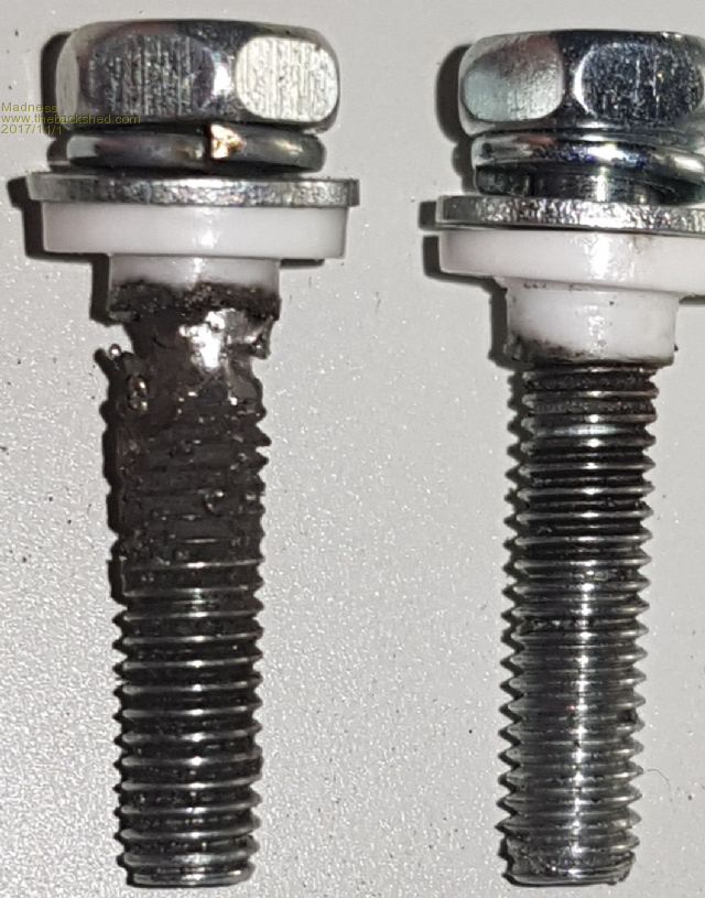

Good news, the Zeversolar GTI is back in action after having just 2 IGBT's replaced. Yesterday I discovered that there was a grounding fault on the PCB with the MOSFETs mounted on it for my charge controller. This is a part of an old inverter PCB that I cut up as a quick way to mount the MOSFETs and associated resistors.
The screws through the PCB which has large areas of copper connected to the source and drain pins on either side of the PCB had arced as per the picture. This was only on one side, the other array did not have any damage.
I don't know if this was the cause of the big failure I had, however, the GTI did not want to operate due to low resistance to ground. It was measuring 3.5m ohm on the multimeter. This fault was not being detected before the big bang, so I think there is a very good chance this happened at that time. Either it caused the failure or was a result of it.

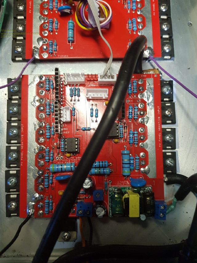

This was not the PCB's I had made I will get back onto getting one of them up and running, they can't fail this way as the MOSFET screw holes are no covered by PCB as shown here.

Arcing plus mosfets means death as a general rule.... so I think you have the reason it failed right there.
New boards look the part too.
