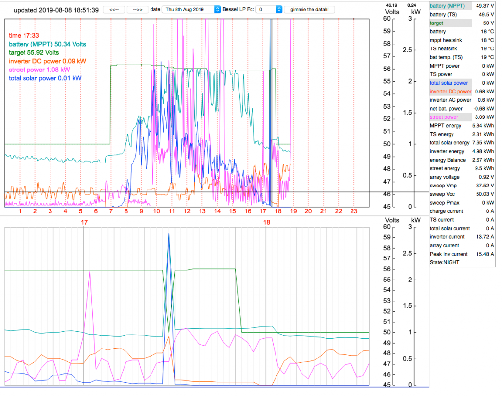

here is the data during the blow. I fitted the spare inverter
a little after 18:00 when I got home from work.
Looking at the lower graph you can see it puked and died
at 17:30, and pulled a few amps. Of course, you need a few amps
to make the magic smoke, and keep it coming.
(my wife _adores_ the stench of what I like to call "scientific progress")
I've altered my logging system web interface.
I like it, now I have zoom into some time period.
Maybe I need to just stick with software and....mutter,mutter..

Why did the solar pulse so high at the same time?

usually it happens, it's an artifact or nonsense data.
The mppt charge controller probably had a hiccup due to the high current
incident when things went ka-pow.
It might have reset or something.
The main issue is I have about 10 hours of desoldering, rebuilding and testing
ahead of me. And when that's done I have zero confidence it won't happen again.
Need to make changes or else it's that old "do the same test and expect a different outcome" insanity.

Poida,Where are the spikes in your data being generated from, and how do you separate the street supply from the inverter output?

  johnmc said  Poida,Where are the spikes in your data being generated from, and how do you separate the street supply from the inverter output?
The pink line (street power) has a lot of spikes.
These are real. That day my wife used the slow cooker, and once it got to temp, it then cycled a bit of power regularly to maintain temp.
Some very singular spikes are when she makes a cup of tea.
This data is so accurate I can tell if we leave a 40W light on by mistake.
I get the street power from counting 1 Watt.hr pulses coming from the power meter.
This is quite noise immune. I put a photodiode over the LED
on the Landis & Gyr meter, locate it with duct tape and close the meter box door.
Cheap Cat 5 cable runs about 30M to the Arduino.
The inverter power is from a current sensor on the DC input and the Morningstar mppt
data I obtain via the modbus/web interface which contains the battery voltage.
I presume I get about 90% efficiency and so need to scale it accordingly in my mind.
Getting the inverter AC output current is a bit of a problem.
What does the measurement mean?
There is of course two AC power values, Real power and Reactive power.
I can get the magnitude of the vector sum of the Real and Reactive power,
by obtaining the product of the RMS voltage and RMS current.
Getting the RMS voltage is easy and accurate, getting the current is harder
thanks to huge noise everywhere if you use current sensors or transformers.
The cheap Din rail modules that measure AC voltage and current are perfect
for the job, and one is fitted to my spare home built inverter. Again I count
the 1 Watt.hr pulses from that and get the AC output power.
Some modules have pulse outputs for Real and Reactive, mine only has Real.

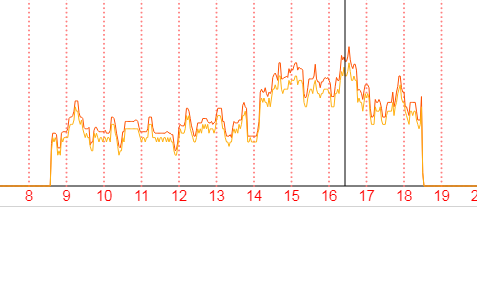

here is the DC power and AC output power from last Sunday.
The peak DC power is 0.95kW, the AC power from the module is 0.83kW
just to the right of the vertical line.
Near enough to 10% loss.
There seems to be a constant offset on the DC power curve too
and when that is removed things might look better.
Around the time of 0.95kW I recorded peak DC current of 55A when a fridge
started up.
I only really care about the power drawn from the battery.
The charge balance of the battery is my primary concern.

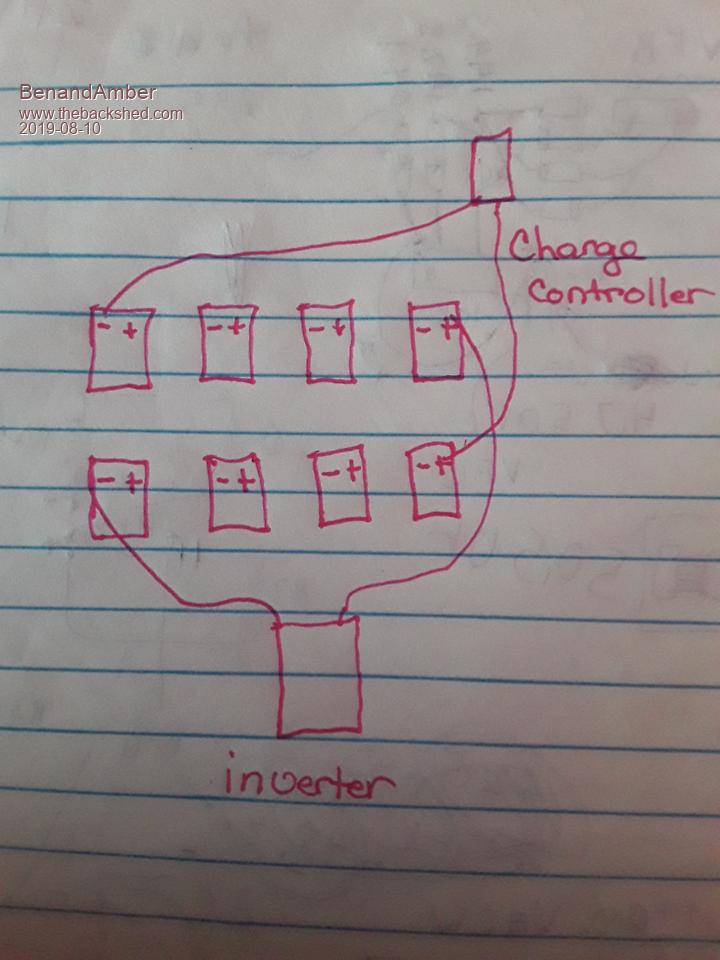

I don't know if this is good or not
Was going to use a busbar but got scared when everybody warned me
So did it like this
What u guys think

Posted: 04:09am 10 Aug 2019
B & A
I don't think it's going to fly, let alone blow up.
Others here will help better than I can.

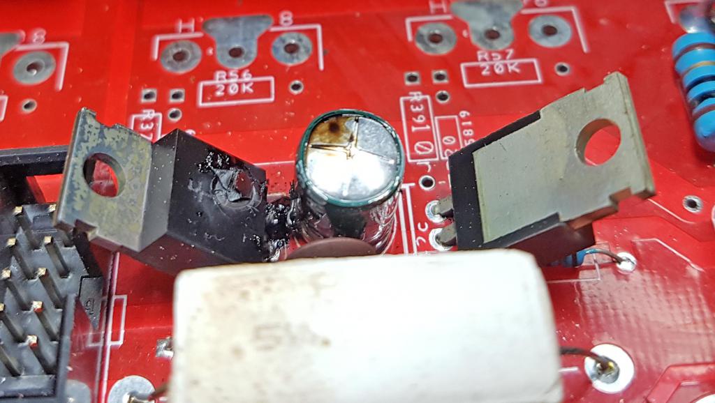

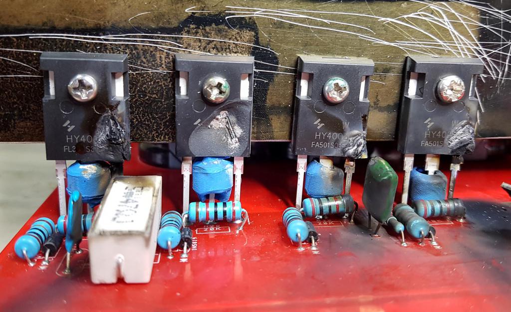

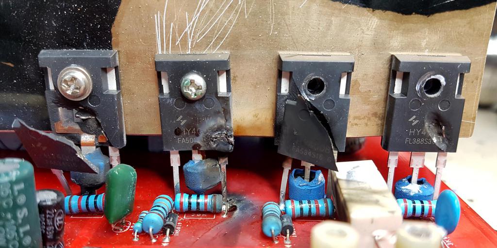

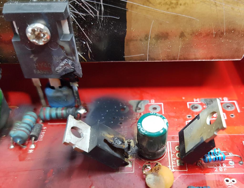

And it's time again for our most favourite type of post:
Disaster P0rn.
The low side MOSFETs were punished this time. They must have upset the Gods.
OF course the high side MOSFETS were blown too. They just stayed in one piece.
The low side TIP41/42 pairs suffered.
And the caps did not have a good day either.

renewableMark
Joined: 09/12/2017
Posts: 1679
Posted: 07:42am 10 Aug 2019
I just noticed how much your fets overhang the heatsink.
Any chance you're getting a hot spot on them causing them to go bang?
