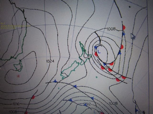

A Storm is rolling through at the moment with gusts here over 80kmh,
Turbine has put out over 2.5kw peak now. the single stator high voltage inverter maxed out at just over 1kw before turbine maxed out, should have got the 1.5 kw model for that stator.
I would be getting close to 3kw if I had the 1.5kw high voltage model. Can not say enough about how good these blades are,when a big gust comes through the turbines blades sound like a turbo prop planes blades winding up at an airport lol,
Output for the last day is 8 kwh.

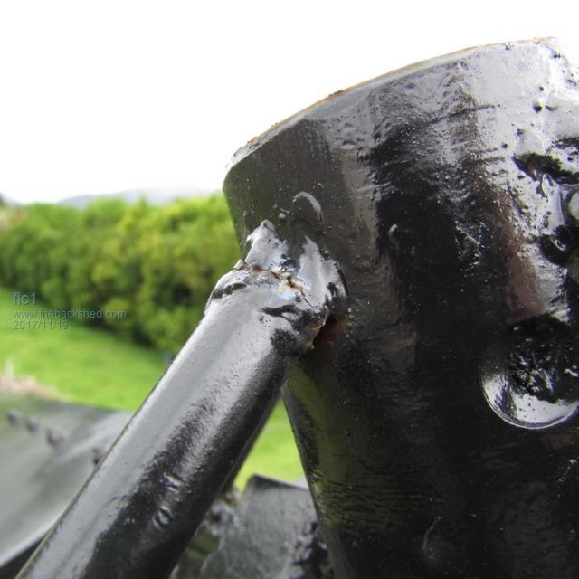

More howling winds here,Turbine getting workout again, decided to check hub, and not really suprised to find a small crack on a blade sapport strut , easily fixed.

flc1 - Where is this crack? Does it mean taking it down to repair?
flc1
Joined: 20/11/2011
Posts: 242
Posted: 09:05pm 27 Nov 2017
Hi KS,
Its on one of the sapport struts for the blades,just welded it again,
I don't think I added enough weld when I built it,
and not shutting it down in 80+ kmh winds and watching it get a thrashing in that last storm didn't help .
