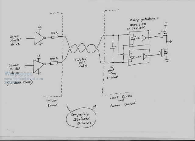

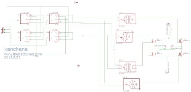

Just had another brain storm of how to more simply provide dead time using the inverse opto isolator trick. Just place a capacitor across both the opto isolators.
That slows down the transition time through zero, where both opto isolators are off, and increases dead time from 50nS (no capacitor) to maybe 2.5uS with 10nF.
The gate drivers have fast Schmidt triggers so this does not slow down the edge speed.
Easy to get any dead time you want, and its symmetrical both ways.
The whole circuit gives very high noise immunity, completely isolated grounds, cross conduction protection, and now adjustable dead time as well, and with only one extra component.
Noise immunity could be an important factor where the heat sinks are "live" and switching up and down very fast at relatively high voltage, and the gate driver cables are quite long.

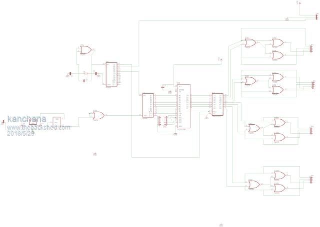

I was playing with eagle , still not finished the board
Nice Now I can get rid of the 74HC73 and add the new method of dead time control .
Regards kanchana
Posted: 10:16am 23 May 2018
In my case that will eliminate the need for sixteen flip flops or eight IC packages, a very worthwhile improvement.

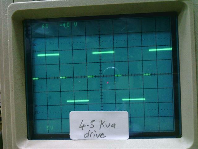

Andrew, the first one of these step inverters I ever built (now almost forty years ago) used a 68H05C8 processor with 16K of internal eprom. It used three inverters giving 27 voltage steps peak to peak, with fifteen 1K lookup tables. Still have that original inverter around here somewhere.
It worked very well for what it was, only 500 watts with 10v to 15v dc input. It was just a toy really, but it certainly proved the original basic concept to be very sound.
Thirty two lookup tables is certainly very workable, and 1K lookup tables provide more than adequate 20uS time resolution for any number of inverters.
My latest effort powering my house right now uses 256 1K lookup tables which is vastly more than is really necessary. probably 64 or 128 lookup tables I suspect would not make any noticeable difference.
The transformers must be designed to provide the required voltages, and the required output voltages for each transformer will be different depending on the number of inverters you plan to eventually have.
Assuming we are designing for 235v rms final output, which is 333v peak.
If you only plan to build a single transformer very crude square wave inverter, it will obviously need to have a 333 volt rated secondary.
A two transformer inverter will need to reach the same 333v with both secondaries aiding, and have a 1:3 voltage relationship. So the big one will be roughly 250v and the small one 83v.
Three transformers also need to add together to provide 333v peak, in ratios of 1:3:9. So the big one will need to be 231v, medium transformer 77v, and the small one about 25.6v.
Four transformers, big one 225v, medium 75v, small 25v, tiny one 8.3v. That also adds up to 333v with relative secondary ratios of 1:3:9:27

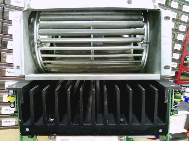

When the hinged lid is down, the heat sink fins are vertical and it passively cools through convection.
I have a 240v ac powered digital temperature controller mounted on the front of the lid that displays heat sink temperature.
That can start up a pretty potent 240v centrifugal air blower salvaged from a Rinnai gas room heater.
This LED temperature display also indicates that 240v is present at the inverter output.
There is a picture of the blower mounted beneath the heatsink on the previous page of this thread.
The blower blows horizontally into the centre of the vertical heatsink when the lid is down, so the air splits, half going upward, the other half blowing downwards straight onto the transformers located below.
Flow areas through the blower and through the fins are a pretty good match, and it provides very effective and silent cooling. Its an unusual way to cool a heatsink, but it works amazingly well both freely convecting, and forced air cooled.
This shows relative sizes and flow areas of blower and fins.

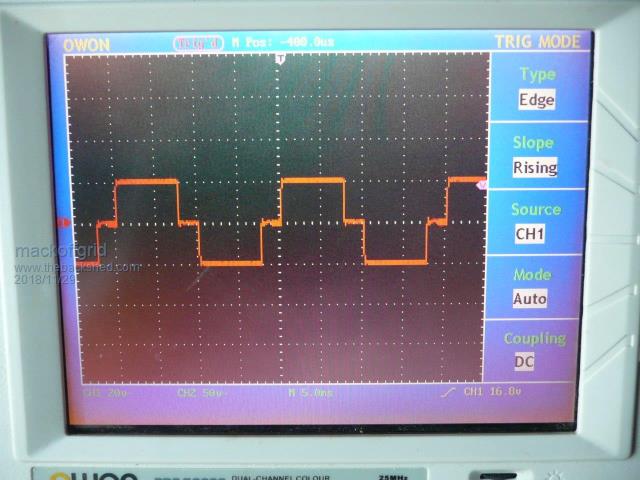

I'm very Pleased - I run up the transformer today ; No problem at all.
I incorporated a 2 button inputs, Start and Stop, that are latching to help in the power up and de-powering, made my life much easier, as I have no spare FETs to blow up. Ordered 100 lot last week :-)
Here is a photo of the transformer output. That 20v represents 219v which is pretty right since the test battery voltage is about 1v too low.
Im not bothering with load test yet, I'll build the 2nd transformer, by then I'll have more fets.
Posted: 08:47am 29 Nov 2018
That looks excellent.

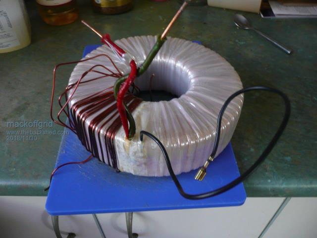

I stripped down the #2 transformer and I'm going to re-use the inner winding as the secondary (110 turns of 4.9mm2).
I have left the screen on this transformer. I understand the screen is meant to capacitively couple the 2 windings but isn't it meant to be a single turn connected at one end only ? This screen looks like the Aerosharp screen where they wind a laminated copper tape around the core creating another winding?
Posted: 07:42pm 30 Nov 2018
I have never attempted to fit a screen to a toroid myself, but I did suggest at one time it may be a solution to the occasionally observed "kink problem" for the guys running unipolar PWM.

I have my No#3 transformer core. Its out of a latronics GTI. It has a 32v winding at about 4mm2 but unfortunately its on an outer winding.
What's your thoughts re: leaving the old 240v winding (and a aux 20v winding they use for fan) on the core and wind my new primary over the top of it all?
Posted: 03:19am 01 Dec 2018
The core is probably larger than it needs to be for #3, but that is good.
I suppose its a question of is there enough room left for the new extra winding ?
