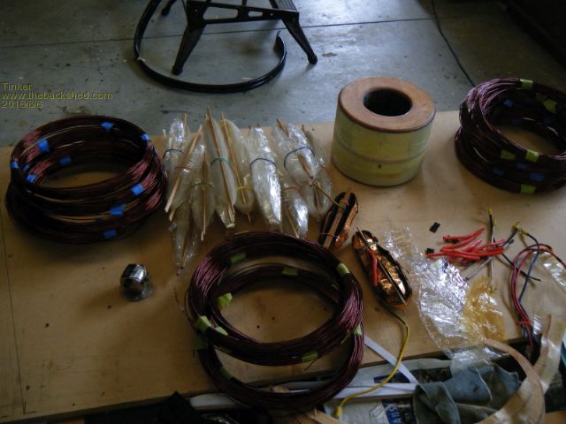

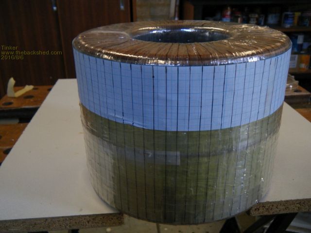

here is a little more progress on the cores.
I ended up with a pile of stuff to recycle.
The two cores were epoxied together to make a twin stack. I used a fiberglass cloth with fortified epoxy in between them to make up for the slightly uneven surfaces.
With my single core project (tinkers inverter project) I had not bothered to round the corners of the core and regretted that when winding the first layer of wire on.

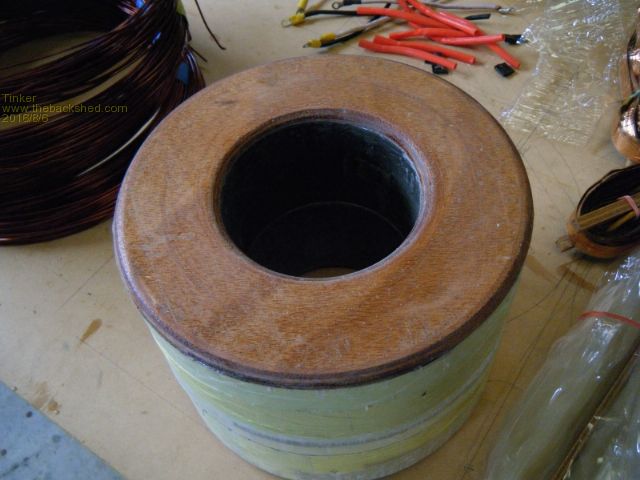

This time I made two disks from 6mm plywood and epoxied these onto each end of the core.
This was easy to do in my lathe but, of course, the stack becomes 12mm higher that way. This may be too much for those who try to use the original Aerosharp 3Kw enclosure to house their inverter.
For my project, that enclosure was way too tight already when I fitted my single core toroid inside, so this time I'm using a different enclosure. It will also allow me to mount the twin stack toroid with the mounting bolt vertically oriented, so that the heavy weight rests on the bottom rather than being suspended from that single bolt.

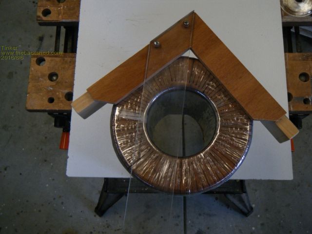

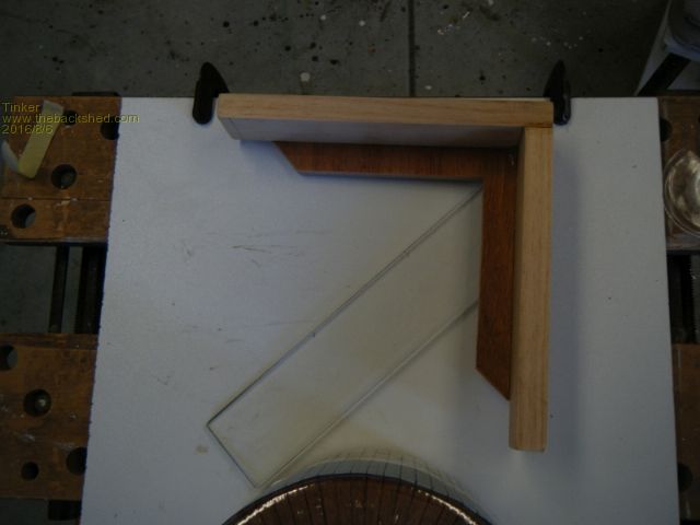

I marked my core in a different way than mentioned in madness's thread.
Using this home made device to draw the radial lines.
Oztules wrote a great post, somewhere among the 60,000 words he wrote on this subject, on how to wind a toroid core.
The gist was to wind the wire two turns side by side, then a gap for two wires before the next two turns side by side. That is on the outside of the core. Through the hole the wires have no spacing between the adjacent turns.
Doing it that way naturally aligns the next layer of turns into those gaps so the winding proceeds in a neat fashion.
But, the wire *must* lay radially and not skewed sideways over the core ends, this is why the radial marks are important.
So my twin stack core is now ready for winding the 4 in hand x 100 turns of the 230V secondary onto it.
Let the fun begin

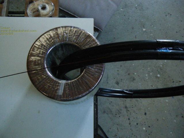

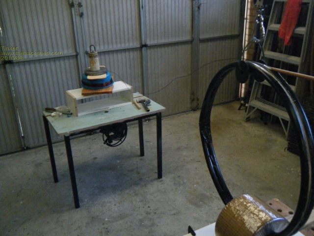

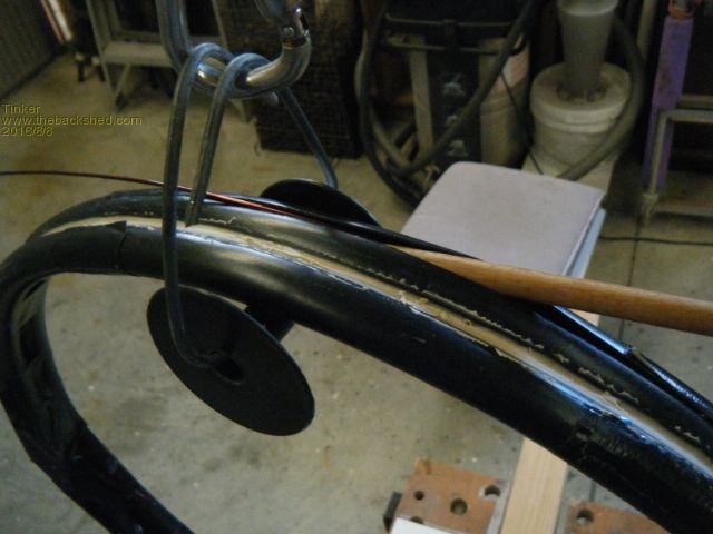

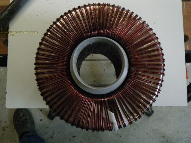

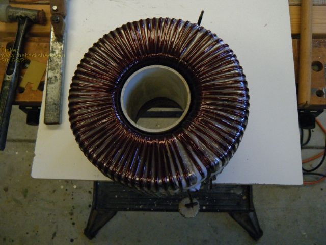

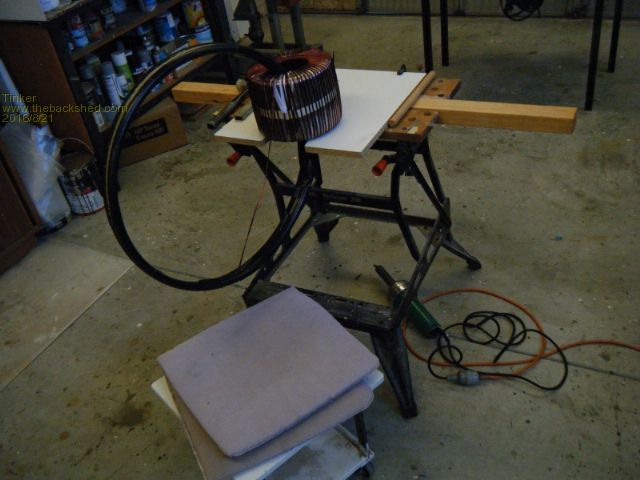

Faced with winding my double stack toroid core a decision on how to go about it had to be made.
I really liked the fishing reel method I pioneered in 'tinkers inverter project' but this type of reel has too small a diameter for a double stack core.
I required something like it but bigger. But what?
Perhaps a ring made from that black split conduit? No, its too flexible.
A ring made from black 19mm poly pipe? Yes, that might work.
Then I had another lightbulb moment, how about two rings? They would be stiffer and let me wind two hands of wire at once.
How hard could that be?
Well, somebody had to try it to find out.
So I set about making this contraption.
I wound some gaffa tape around to hold the two rings (about 600mm diameter) together. Then I used a stanley knife to saw a split around the outer rim of each ring.
After this the rings were a bit flexible so I tried to glue them together as well. But nothing seems to stick to that black poly something material. What you see in the picture is something like liquid nails, it too does not adhere well.
Anyway, I started loading these circular wire dispensers, one at a time.
The wire spool sits on a rotating table (cake decorating bearing)
I used a dowel to slide along the slot to open it so the wire could be loaded.
Once both dispenser tubes were loaded with wire they were markedly stiffer and I started the winding job. The lines I marked on the core for the wire spacing were very helpful.

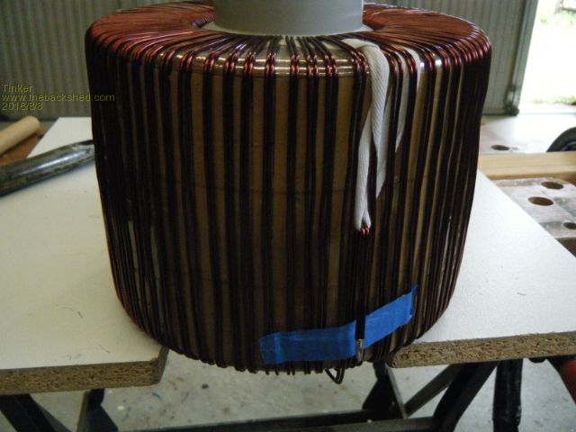

A comment about this spacing; Measuring the inside diameter of the prepared core I could calculate how many closely spaced turns I could fit there. But its too optimistic to assume the wires will be really close spaced. I learned that the hard way when doing the single core toroid. So I used a spacing of 2mm per wire for a 1.8 mm diameter wire. I also used an inside core diameter of 2mm less.
That worked remarkably well for me.
There was room for 76 turns of 2 in hand wound simultaneously. So there would be an overlap of 24 turns to complete the first part of the wind. By sheer coincidence there was just about the right length of wire loaded in my dispenser. I knew the wire was not long enough for 100 turns and I had to splice it somewhere.
But this way I could stop the winding job at a convenient place and insulate the first layer.

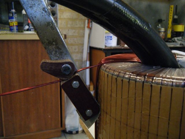

The gadget shown above is something I made to tension the 2 wires at each turn. It works but I wish I had made the cam lever twice as long or more. My thumb got sore having to push the cam down hard to lock the wire. The fabric loaded bakelite (Can't think of the trade name for this) I used works well. Its hard enough not to groove but does not harm the wire enamel.

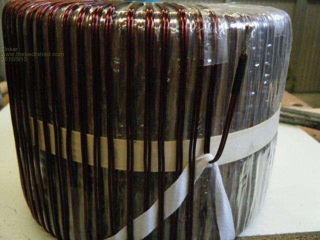

This is how the first layer looks like:
The plastic plumbing fitting in the center hole is there to push the wires firmly out while I epoxy the wires there. I do that from each end which locks the inside of the turns solid. I also did insert a bit of 2mm whipper snipper cord between the last and first turn to keep them spaced apart.
After the epoxy has cured a full cover of mylar tape will go on to lock the outside of the turns in place.
This pic shows the wire start, I soldered the two wires together to keep them that way. The spliced on wires will be done on top of the mylar tape.

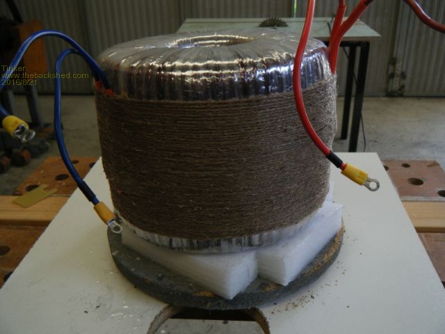

Oztules, I hope you are reading this as I would appreciate your advice.

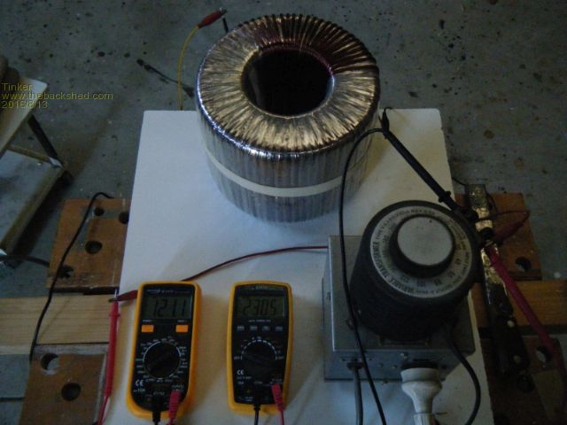

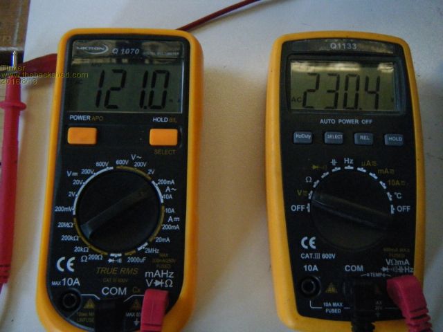

Before I started dismantling my Aerosharp toroid core I measured the core excitation current at the 230V winding. It was 71mA when the input was exactly 230V on my variac.
Now I have finished winding the 100 turns, two in hand, of the 230V secondary. Another 100 turns still to come, to give me 100t of 4 in hand.
I thought I should power it up and see if everything is OK.
The twin stack core demands an excitation current of 120mA when powered from the same variac set to 230V.
That is around 28VA, does this sound in the ballpark? I could easily add more turns at this stage if you think that might be worth while.
A picture of the test:
Close up of the DMM's:
Oh, just out of curiosity I put a temporary short turn around the core to see how much different the meter reading is.
Cranking up the variac slowly, the current shot past 1 Amp at around 150V when I stopped as the variac is not rated higher. The short turn gave the magic smoke signal by then.
So, it is *very* obvious if anybody gets a shorted turn at their rewinding exercise .

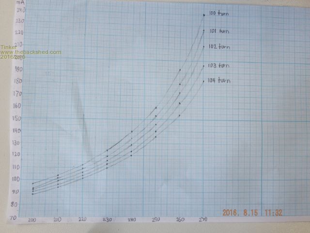

oztules
Joined: 26/07/2007
Posts: 1686
Posted: 02:52am 13 Aug 2016
Ok Tinker. I'm not an EE but this is what I see and want you to try.
Simply we have twice the core mass than you had before, so i think your doing well... less than twice for twice the core.
I think your thinking you are near saturation or worse, and this is what is causing it.. I don't think so..but it is easy to test as you have a variac.
I think if you move the voltage higher ( to 240, 250 260 ) you should see a linear increase if your away from saturation... if you see a sharp non linear rise, then your nearing saturation... so should be easy to spot.. and at saturation it will be awful.
If you look at the graphs of a transformer, you will see it is non-linear as you get nearer to saturation.... this is why i think as above.
If you see that it is rising exponentially fast as you near 230-240v, then I have fouled up the calculations, but i think your in the sweet spot.
Now you can tell us what happened. If it is too close to saturation, then more turns... but I hope not.
So if your still in the linear part of the curve your doing fine.
EDIT... just realised you said 100 turns, so i assume you found 1.2v/turn on the original single core.. I seem to remember 1.14 for mine, but that may be the inspire one.... too many cores... too small a memory... If yours was 1.14, then we may be a bit skinny.
Epoxy cores.... well I have seen and fixed several high end inverter torroid transformers, inc aust made name brands. When you see how they are wound, you have to wonder why so few, it is terrible, relying on thin films of insulation between high differentials is staggering. The vibration will get them eventually, but it takes longer than I would have thought, but it happens eventually.
EI types never fail from that, usually just overloaded and burn up, the potting precludes the vibration attrition.
If you put a few thousand volts through torroids, as a general rule they will fail in a few seconds to a minute ( micro second pulses spaced a second apart ), as the interwinding potentials are too much too close. EI will run for many many minutes.
This is extreme insulation testing.... but tells you a lot about the winding safety.
And finally, if your using the old wire after straightening, then there will be micro fractures in the enamel... the epoxy will help make our reworked wire much less prone to failure.
.............oztulesEdited by oztules 2016-08-14
Posted: 11:38pm 13 Aug 2016
Thanks oztules,
You may not be an EE but you are doing much better than some EE's I met during my working life when it comes to explain things electrical in simple terms the average bloke, like myself, can easily understand.
And you saved me a lot of money in the bargain by posting your expertise on making one's own LF inverter. That was a big ticket item for me, holding up the conversion of my house to off grid electricity. Thanks to you my house is now 95% running on solar power.

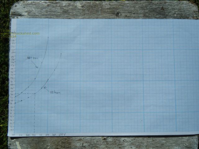

Anyway, I did your suggested test and it was most revealing. It appears that my toroid will be magnetised at what you called the "sweet spot".
I attach the results in graph form below.
Out of curiosity I tested what would happen if more turns were added. An offcut of wire gave me 7 turns, these were just roughly wound around the core for the test.
The extra 7 turns greatly increased the magnetising current, see the graph.
So its not better to have more turns, there is indeed an optimal number. Something else new I learned from you.
Unfortunately the pic did not turn out too sharp. I took it outside in the sunshine as at macro setting with a flash the blue graph lines washed out ccompletely.
The X axis represents the voltage, from 200V to 270V.
The Y axis represents the current (in mA) from zero to 300mA
The lower graph is from the 100 turns.
The upper graph is with 7 added turns.
Your comments are appreciated.
oztules
Joined: 26/07/2007
Posts: 1686
Posted: 04:15am 14 Aug 2016
"Out of curiosity I tested what would happen if more turns were added. An offcut of wire gave me 7 turns, these were just roughly wound around the core for the test.
I don't understand this at all... it should not have happened, it should have gone down, not up.. more turns should always be better for lower current as it is the amp-turns that give the magnetising... more turns= less amps...
So I can't explain the results.... unless the turns were running the wrong way perhaps.. other than that I have no idea I'm afraid.
The bottom lines tell us we are close to perfect for 230v operation... we are still basically linear, but as we go higher voltage we start to become less linear, so we have the best combination of wire resistance and mass and current.
Less turns would have been a disadvantage ( higher magnetising current), more turns would be more resistive losses under high load, so we are in the sweet spot.... that was what I was alluding to.
Sadly.. again....the second ( top )curve makes no sense to me, unless you had a drop in frequency, or the 7 turns were counter wound, so behaving as 93 turns not 107 turns... I have no idea.... no explanation... I'm sorry.

Where in the circuit did you measure the current.. input to the variac, or input to the transformer secondary..... wondering if the variac introduced losses if it is auto tranformer type, rather than resistor.
If you measured the input to the transformer winding only, then variac losses would not be counted... and I am still lost.
............oztulesEdited by oztules 2016-08-15
Posted: 06:07am 14 Aug 2016
Hi oztules,
The current was measured after the variac, at the input to the toroid winding.
But you may have a point with the counter direction winding. I'll re check that and let you know - its quite possible I got confused, happens frequently I'm afraid
I'm glad to know my 100 turn decision was the right one, I'll leave that as it is and let you know the result of the extra temporary turns re test.
Your comment:
"Glad you got a working inverter out of all of this. What sort of power have you seen out of it, and does it work as you had hoped. "
Well, this one is still in progress, its going to be an upgrade from the single core toroid I started last year and which now powers my house's GPO's. It did almost 2000KWh by now, with no problem. But the fans runs often as the power jack modules inside the original Aerosharp enclosure take up a lot of room and restrict natural ventilation.
So I hope the double stack version in progress will solve that, especially with the big Aerosharp heatsink outside a bigger enclosure.
Posted: 11:18am 14 Aug 2016
Mine ended with 98 turns on the secondary, I measured the current as you have done on my completed torroid and it draw 140ma according to my meter. However I don't have a variac, I just used a 2400 watt fan heater as a resistor in series.
Posted: 10:46pm 14 Aug 2016
OK, I admit it, I goofed
Looking at the picture of the end of the winding you can see how.
I should have known from the current that I'd connected the extra turns backward. My excuse is that it has been a very long time since I learned about transformers during my apprenticeship and have not dealt with them since until recently.
Anyway, I conducted a series of tests with additional turns and drew graphs to show what happens to the magnetising current.
So I conclude that for my size double stack core and for a 230V secondary 100 turns are just OK. 102 turns would be better but not by much unless one wanted a 240V secondary.
I hope that graph helps some inverter builders without a variac. But these cores do differ somewhat in size, the single core inverter I built previously only had 190mm OD, the ones above were 203mmOD. All were salvaged from Aerosharp 3Kw inverters.

Posted: 12:04am 15 Aug 2016
Thats better, makes perfect sense now..... whew.. thought I needed to relearn
everything.
Yes it is about right with 100 turns. The 20ma saved by going to 104 is probably false in the end, as the idle current is paid only once, and does not increase with load... the R loss does, so thats the one to keep an eye on really... as well as getting near saturation, without over doing thing... ie sweet spot ( 4 turns is 2% of your losses when you put the foot down)
One could argue both ways I guess.
It shows the rule of thumb is only a bit conservative, not a lot, so thats good too.... well done.
I go for 230 not 240 mostly... just to relieve the unit a little bit from big resitive loads.. ie they work almost as well, but you may shed a few hundred watts at 10v lower for a 3kw element.. the batteries will like the lower loads
..........oztulesEdited by oztules 2016-08-16

A little bit more progress....
I believe I can do a better job with anything if I'm in a comfortable position to do it.

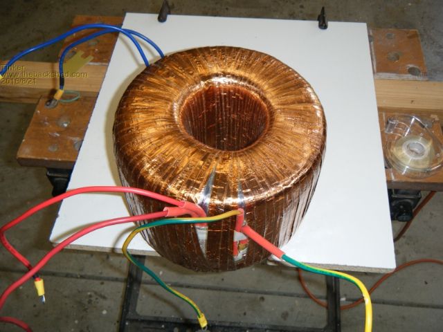

So, here is how I wind my toroid core:
You can see I do that sitting down on that little stool on castors. With the core oriented this way there is no heavy lifting involved, just sliding it round over the work table cutout.
My winding two in hand at once idea worked better than I had hoped. I would certainly do it that way again should I be mad enough to start another inverter .
The poly tubes have a big advantage over the bicycle rim idea that has been mentioned.
The wires are *inside* the tubes and so cannot jump out if one lets the wire tension off. With the fishing reel thing I used on my single core I always had to stick a bit of masking tape over the rim the keep the wire on.
Not so with the "circular shuttle". I just pull out sufficient wire for a turn, complete it, tension it, pull out more wire, and so on.
The process is quite fast once a routine is worked out and, since the wires proceed two by two on the outside of the core, doing that with two separate wires (for two in hand) makes a lot of sense.
I wound one complete circle around the core, which turned out to be 76 turns on the first 2 in hand layer and 74 turns on the second.
I stopped winding after the first layer and epoxied the inside (hole) wires plus the top & bottom.
To push the wires in the hole out against the core an offcut of PVC pipe was used. This can be easily adjusted to size by cutting out a small segment. That pipe has to be waxed first, to stop the epoxy sticking to it.
Only just enough epoxy to wick down halfway was brushed into the little 'well'.
Once the epoxy had gone off I knocked the PVC pipe down until it formed a 'well on the other side, turned the core over and epoxied that side.
Then the layer was covered with the mylar tape. After this the remaining wire was spliced on to wind 24 more turns on (first winding)to complete it.
The epoxying was repeated after each layer.
So I ended up with two identical winding's, each two in hand of 1.8mm diameter wire.
I tested after each stage for short turns, much easier to correct then as when the core is completely wound.

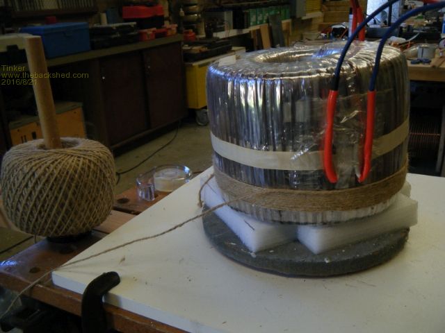

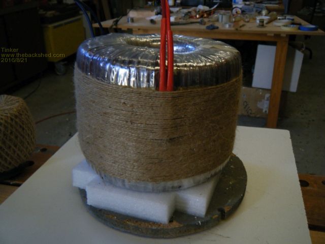

The epoxying locked the wires in the hole tight but those on the outside were still too lose for my liking. It is quite difficult to tension the wire there sufficiently, this would be easier if the core's outside was a little barrel shaped.
So I would suggest to wind two or three layers of epoxied 50mm glass scrim tape around the join between the two cores, to introduce a little barrel shape before starting the winding process.
I used a different solution, which can be done afterward, and it produced a very solid outer layer.
Just cheap natural fiber twine (jute) was used, it works like a boa constrictor on the wires under the mylar tape. It does not slip as synthetic twine would and soaks up the epoxy very well.
I quickly found that leather gloves were a good idea, even so I got a little blister from that work. But it was worth it IMO.
The finished job.
And now epoxied.
Another test, to see if that twine belt made a difference, followed.
My twin stack core had a faint hum when I tested the two winding's if they had an identical voltage, before the twine was wound on.
So I connected one winding to 230V and a 2.4Kw kettle to the other. I could not detect any hum, quiet as a mouse. This made me happy as the single core inverter I made last year does hum a bit (but not annoyingly)if it has some load on it.

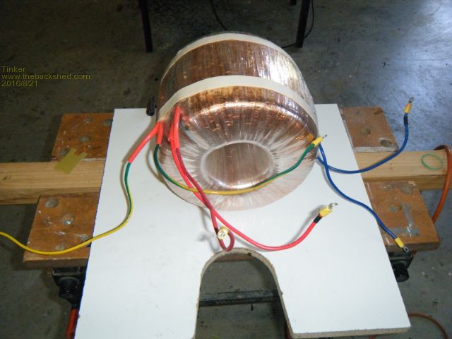

Next came the foil static screen. I had two of these copper foil strips, one from each donor toroid. Both were needed as one strip barely made it halfway round the toroid, if wound on with a minimal overlap.
Again I tested for shorted turns, it would be hard to spot damage to that flimsy foil tape otherwise. Also, tested if the two foil runs had no connection to each other. They will terminate at a common earth point.
More mylar tape and my double stack toroid was now ready for the primary winding.
This will commence as soon as I had sourced a suitable wire.

The poly tubes got quite tatty by the time I finished with them and were held together just by the gaffa tape. I since experimented with superglue and it does stick that tube, I wiped it first with acetone. Supergluing it together would make a much better double barrel 'circular shuttle', in addition to the gaffa tape.
Cut a V notch at each start & end of the slit in the tubes, to allow the wire easily transit the section where the tubes meet. The slits are unlikely to align 100%.
I used 600mm diameter for the 'circular shuttle' but 800mm would be better. My shuttle was a little tight towards the end of the winding process, a bigger diameter would help. But, as it is flexible, its not a job wrecker as a bicycle rim would have been.
Plus, two bicycle rims would never fit side by side in the toroid hole.
