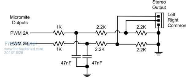

Great use for some spare MX150s.
Working well on a MX150.
I'll need to add the output filter.
Cool. :')
Edit: Nice with a filter.
Edit-2: Good on the MX170 too.Edited by astro1 2018-10-22

I also tried an MX150 - it works like an MX170.
CircuitGizmos is right: Fs and Ss don't sound good. SAM on website sounds better...
@astro1: What kind of filter did you use?

Filter as per MM+ manual, page 24.

Hmm,
I think the filter in the MMBasic-Manual is a low-pass filter plus a voltage divider.
Maybe one resistor (1k) and one capacitor (47nF) should be sufficient.
For Frank (Online calculator, german):
https://www.electronicdeveloper.de/FilterPassivTiefpassRC_1O.aspx

Frank N. Furter
Joined: 28/05/2012
Posts: 1186
Posted: 06:02pm 21 Oct 2018
@twofingers:
Thanks a lot! Did you know this site?
http://www.sengpielaudio.com/Rechner-RCglied.htm
There are many good calculators on this site:
http://www.sengpielaudio.com/Berechnungen.htm
... and for all English speaking:
http://www.sengpielaudio.com/calculator-RCpad.htm
http://www.sengpielaudio.com/Calculations03.htm
Try it out!
Frank

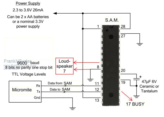

The new SAM runs satisfactorily on a MX150 (on Micks Backpack170).
The only limitation I found is the text length (~100 bytes).
I guess a buffer issue - not a bug.
Pinout for 28-pin is:
console as per MM2 Tx_µC on pin 11
Rx_µC on pin 12
audio output - pin 7
audio Gnd (my setup) - pin 8
busy output (active high) - pin 17

Hi I've been keeping an eye on this thread, more from general interest than an immediate need, but a need may arise...
I have run foul of fully understanding the incremental changes that flow through a 10-page thread.
I have a mixture of "understandings" and questions:
U - Peter M has engineered the code so it can be flashed (via MPLAB/PicKit3) to a 28 pin MM170?
? - is the bottom of page 8 his latest version?
U - it will take text typed (say via TeraTerm) and speak it?
U - it can't take input (say from buttons) and speak prepared text? (eg speech confirmation of keypad presses)?
? - is a way around this to have say x "messages" stored in a text file (edited by hand) so that event y calls up and speaks message y?
? - what components are required (especially speaker)
? - is there a simple circuit (I'm sorry but I couldn't follow the "Holy Water" one)
? - if not this, is there a sensible way to "announce" key-presses or switch activations?
Many thanks, Andrew

Hi Andrew,
  Quote  Peter M has engineered the code so it can be flashed (via MPLAB/PicKit3) to a 28 pin MM170?
- YES (and there is a hex version for a 32MX150 also available)
  Quote  is the bottom of page 8 his latest version?
- YES
  Quote   it will take text typed (say via TeraTerm) and speak it?
- YES
  Quote  it can't take input (say from buttons) and speak prepared text? (eg speech confirmation of keypad presses)?
- Hmmm, you need a Micromite or Arduino etc. to send the text to SAM. Otherwise you would have to rewrite the code from page 8 (which would be possible).
  Quote  is a way around this to have say x "messages" stored in a text file (edited by hand) so that event y calls up and speaks message y?
- You can save your various texts in a Micromite (or Arduino) and respond to a keystroke or event to send the text to SAM via the UART (9600,8,N,1). Otherwise you would have to rewrite the SAM code.
  Quote  what components are required (especially speaker)
- you need only a flashed PIC32MX170 or PIC32MX150 and a small active loudspeaker. The sound should be better if you use the filter (as described in the Micromite Plus manual):
  Quote   is there a simple circuit (I'm sorry but I couldn't follow the "Holy Water" one)
- You only need the circuit as described in the Micromite manual as "Basic Circuit" (even if SAM is not a Micromite). The "terminal" is now the Micromite or an Arduino, the connection with Pin11 is not absolutely necessary. Audio OUT is on pin 7 (and if desired: BUSY on pin 17)
  Quote  - if not this, is there a sensible way to "announce" key-presses or switch activations?
- I would use a Micromite to react to the keystrokes and then send the respective text to SAM.
FrankEdited by Frank N. Furter 2018-10-28
Andrew_G
Joined: 18/10/2016
Posts: 917
Posted: 09:31pm 26 Oct 2018
Hi Frank,
Thanks for your explanation and your time in putting it together.
It really is quite simple (but possibly near my limits).
I can even envisage the Tx/Rx being via HC-12 (or similar) - many possibilities.
(Many thanks to Peter too for his work in re-writing the code and posting it).
Regards, Andrew
