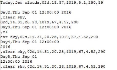

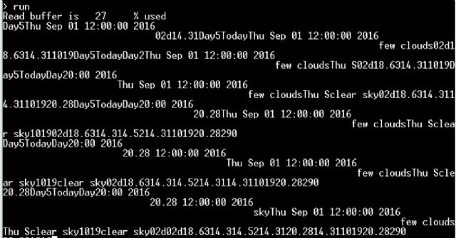

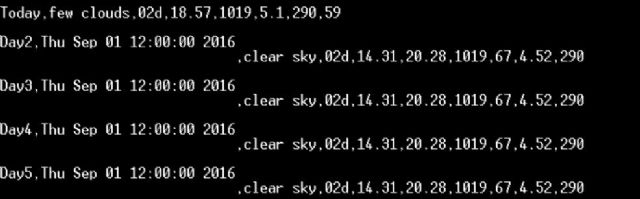

Here's how the info looks when viewed on Terraterm
and
here's how the info looks viewed on the MMEDIT console
The Function seems to me to be stripping the commas from the received data?
AND it also doesn't clear the count when it receives new data from the com port, it just adds it all up till it crashes
Edited by lew247 2016-09-01
