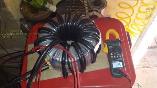

well Ive been kinda busy, but finally got a chance to wind on the primary on the weekend. At first I was going to wind with 50mm as OZ suggested but that meant that I would have go out and purchase some more cable..... and since I nearly have half a roll here of 35mm at home I pondererd on the idea of winding 35 and 10mm side by side. Now I know thats not 50 mm but it probably is close enough for the job. In theory it should work but I thought id run it by you guys and see what you think. Is it unbalanced? I powered up the secondary with 240 thru a 60w globe and checked the voltage at the primary end. 15.25v Is this the right voltage we are looking for?
Also been checking ebay for the main board and controller but can never seem to get the two at the same time ...one or the other is out of stock ( 8000w 24/220) and Id rather have them both delivered at the same time. At this rate it will be way after christmas before I recieve them. Just waiting on a reply msg from PJ.

cross section area
35mm2+35mm2=2450=49.4mm2
50mm2=2500
35mm2+10mm2=1325=36.4mm2
so 2 in hand 35mm2 is a good option
I am sure someone will correct me if I am wrong
the traditional calculation would be 24v/1.41 = 17 volts
the actual inverter calculation allows for voltage sag and the PWM closed loop current control.
so 250v @ 16 to 1 turn ratio = 15.625 volts
I guess inputting 240v on the secondary would give 15 volts on the primary so you are pretty close to the mark!

I agree with Yahoo2.
For 24v, even 3kw (which mine runs or 2-3 hrs a day at time in the mornings, is 120 amps or more, for me it is ony 60 amps, so not a big deal for 35mmsq.. @48 v )
As you have plenty of 35mm wire, 2 in hand is the go... only 3-4 meters per winding too.... so not a nightmare to do.
Your boards will run 3kw-4kw indefinately, so you want the tranny to run happy too, and you want as small a sag as possible when running hard, or your fets work harder than they need.

I should have put some extra detail as explanation in my post for the calculation method for those like me, who forget.
My area calculation is square the wire sizes then add them together and square root the total.
the 1.41 figure I plucked from nowhere to get the 17 volts AC is a rough estimation of the rmsVOLTS (area under the curve)of converting DC to AC Sine wave at mains frequency.
in the third paragraph 250 volts is an allowance under heavy load with the inverter running at full throttle. under light loads when the batteries are getting close to full charge, say 29 volts, the inverter controller is adjusting the output voltage back
4% for the sag allowance and about 18 - 25% for the variation in battery voltage.
in the 4th paragraph we are just checking that the transformer ratio of 16 to 1 for a 24 volt system is correct by comparing the measurement on the primary to a known/measured voltage on the secondary, in this case mains electricity (i am presuming it is at 240 volts).
that about covers it Cheers!

In not sure if I can fit in 2 in hand of 35mm2 neatly. I tried just a single run of 35mm and I was about 3/4 away around the inner hole, so thats why I added the 10mm2 which fits ok with a bit of space left over. I also have some 16mm2 as well, so I could remove the 10mm and replace it with the 16mm, ending up with a neat wind and no overlapping.
Seems like my calcs were wrong. I always assumed that in my case 35mm2 and 10mm2 would add up to 45mm2, or 35mm2 and 35mm2 would equal 70mm2 . Think I need to go back to school!! Could there be a problem by having 2 different sized cables?.....OR...... am I better to have a 2 in hand 35mm that dosent look so preety, but works?
I probably should of mentioned the voltage input yesterday, so I did some rechecking. Mains voltage thru a 60w lamp to the secondary is 235v and the output on the primary 15.56v. Is that close to the money?
Thanks Marcus

Marcus, I also find that 2 in hand 35mms2 is in fact 70mmsq...cross section.
Given that 35mmsq will handle 140 amps ok, twice would give you some room, as your peaks will exceed 200amps on may occasions I suspect.
2 in hand will get you some clear space of 300 amps and more short term.
It does not need to be neat... nice but not necessary, the wire needs to go through the hole... and thats it.
Perhaps wind one layer then the other, length will be different, but it is only turns of wire going in the hole that counts. There will be a slight phase change with the two different length wires, but it is academic, not practical in nature over this length ( different in single phase inducton motors though)... this should be fairly neat I think.

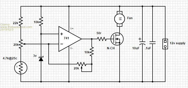

  Gizmo said   Drew this up. Its really just Oz's circuit with some component changes. Next time I have the inverter off ( unlikely to happen soon, been running for weeks now without missing a beat ), I'll measure the values of the pots to give a starting point.
The mosfet can be any power N channel fet, I usually source mine from retired computer UPS's.
Edit: I may revise the component values later, I did remember one of the pots was pretty close to the end of its adjustment.
I just bread boarded this circuit for a 24V fan (got those at 1/2 price) and it works well with just a minor change.
For those who are interested: I replaced the zener diode with a 6V2 type.
Used a 10K NTC thermistor from Altronics (looks like the one on the PJ heat sink).
I used a LM 318 OP Amp and a 3055V mosfet - had both of these on hand.
I adjusted the pots so that the fan stopped at room temperature (~27 deg C).
Fitted a small heatsink to the NTC thermistor and warmed it between my fingers so the fan started up - did minor pot adjustments to get it do that repeatedly.
Waited until fan stopped (had the thermistor heatsink in the fan's air stream),
then held the soldering iron to the heat sink, the fan started up flat out - removed soldering iron and the fan stopped after a while.
I measured the feedback (pot + 10K resistor) and the total was 27K. Replaced feedback pot & 10K with 27K resistor and the circuit worked fine.
Thanks again Glenn for posting the circuit, I will now lay out a small PCB for this.

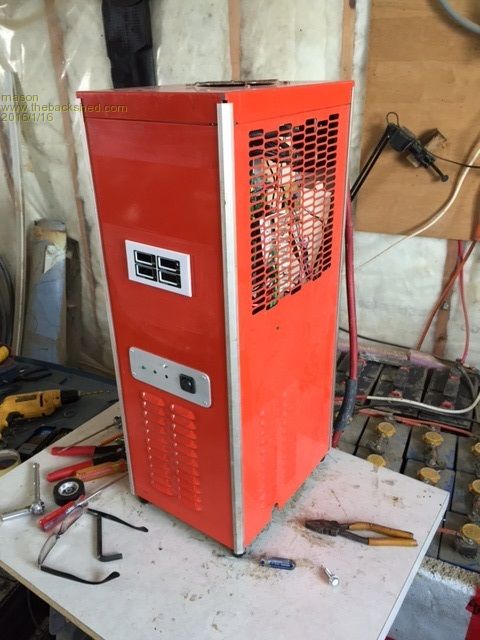

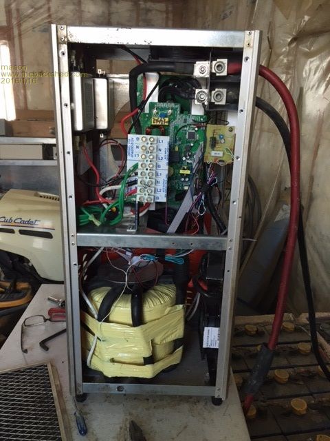

My Oz-Inverter is 24volts 10000watt- 220 60hz split phase, I used a old air dryer encloser, the transformer weighs 75 lbs so I thought this floor mount enclosure would
work the best.

Good tall enclosure. It will help a great deal in getting the heat out of it.
I'm really liking that enclosure.. and these inverters generally... tough as nails.
Nice big transformer too.
............oztules

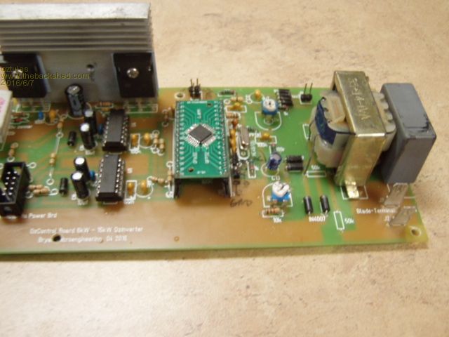

Running this at the moment.
2016-06-07_064438_80109d.pdf
