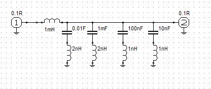

"All of my switching ccts employ full spectrum bypassing up to 100MHz on the input. [ie lots of different value caps in parallel, pF to 0.02F with at least 1 value per decade]."
I would suggest doing a circuit analysis on multiple capacitors in parallel with their associated inductance values. The more different values caps in parallel the more frequencies that they do not bypass. You might be unlucky and not bypass an important frequency.
A free circuit simulator like RFSim99 is easy to operate and tells you where you might have problems.
The usual cure for this problem are small value resistors in series with specific caps to reduce the effect of unwanted resonances in the bypass system. These can only be found by circuit simulation.

I do not have an L meter. You cannot simulate unless you can specify components values.
If you look at many of the ccts posted you will notice a lack of adequate high frequency power supply bypassing.
I think you will find most readers are looking for help with issues and would have some difficulty programming a simulator program. It would be helpful if you were to provide some examples as well.
Many a Circuit design exhibits poor performance because layout of the final design introduces undesirable effects. A simulator may predict something will be OK, but when we backshedders come to build it, well you can can guess an outcome.
There is an issue with SMPS and the like is that poor design and building can result in undesirable RFI. The production of efficient switching and modulation creates other technical problems that need to be adressed as well. These problems are one reason I am reluctant to offer cct designs for general use.
I use an iterative process using a CRO to determine the best component values that achieve desired results.
My rule of thumb is if a component does not get hot while performing the desired function and the CRO trace shows a sharp switching waveform and my TV and radio don't suffer then the cct is working well.

Gordon,
Correct, you either need to measure the inductance of the capacitors you are using or get someone to do that for you. Chip caps these days usually have that information in the datasheet, but you are more likely to be using leaded components.
Also, how these caps are physically wired will have a huge impact on the resultant spurious parallel resonant behaviour.
The other way to gain insight would be to do a frequency sweep of your bypass system using a spectrum analyser with a tracking generator. Perhaps, a friend in radio comms is needed!
Here is one RFSim99 example below. You will see the series resonant notch of the 100nF cap with 10nH internal inductance to be 5.0MHz and the a similar notch for the 10nF and 10nH part to be 16.0 MHz.
The key point to notice is the parallel resonant frequency of 11.8 MHz, here you have NO bypassing. Some maths will show that the 10nF/10nH cap is resonanting with the internal inductance of the 100nF cap.
The trick is to put a small resistor, in this case about 0.5 Ohms in series with the larger cap to reduce the "parallel resonant peak" to a much lower level. Of course, making this resistor too large reduces the effectiveness of the bypassing afforded by the 100nF cap.
Also, 10nH is possibly a bit low. From memory typical polycarbonate caps, as used in most switch mode supplies are more like 20nH. And, as a "rule of thumb" each 1mm of connecting wire adds another 1nH to the equation. PCB trace inductance can be estimated published data or measured as well.

Your info confirms my findings about the value of the series inductance. I have pretty well sussed the RFSimm program. I calculated the approximate series inductance with the ceramic chip capacitors that connect to the groundplane. The program calculates the 1.6mm pinning wire out at <1nH. I use large pads at the filter end of the inductor and the chip caps bridge the gap to the heavy screen track that is pinned to the groundplane on the other side of the board. The only caps that have leads are PCB electro's of 10,000uF and 1,000uF. I estimated the series inductance of these to be <2nH. When I have my boards done, the ground plane will be pinned every 5mm with plated through holes, to connect the ground between both sides where they overlap, [basically no extra cost], so the resistance to ground will be very low with the resultant very low parasitic inductance. The ground plane effectively places a parallel capacitance to ground for every printed circuit track as well. Too hard to calculate all the interactive effects. Remember there is a huge series inductor with caps effectively on both ends.
The cct employs a complex low pass Besel filter on the output.
Here is something like the cct. I scanned from 1kHz to 1GHz with only a tiny low pass at 1kHz. Basically only DC comes out. I used 0.1ohm, the minimum for the input and output Z
The input filter is similar.
It helps to have a very low effective series inductance with the caps. Other designers on thebackshed may not use the same techniques as me, so their ccts would behave differently.

Remove the 1mH inductor and look at the 4 capacitor combination with 0.1 Ohms on input and output. No bypassing at 84kHz. Now the ESR of the caps will reduce that "peak", so you are seeing a worst case scenario.
If the noise is generated at the input (before the 1mH inductor), looking after the inductor will show very low or no noise. But if the noise source is at the output end AND happens to be at 84 kHz it won't be bypassed to ground. Now, maybe this is not important in your situation.
How did you attach the RFSim99 image?

I have thought about your comments a little more and I can see where you are coming from. I think my bypassing reigime can be streamlined with a simpler cct. I will add a larger main cap, 30000uF for the main carrier reduction and a trial and error on the prototype for the edge switching harmonic.
It is alwayws a tradeoff between switching speed and component sizing.
