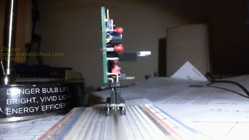

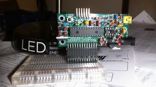

Ok... Just got back from Lou's place, after spending the afternoon getting the stuff organized. Lou managed to get another DFN stuck on using a mag-lamp and a good bit of luck.. So, I think it's going to be doable. The good news is the boss at work let me take off a week so we can get a double teem thing going on these units. One thing I would like to try is using a fitting jig to make sure the part is sitting just right. I was thinking of using a tiny drop of that lock-tight SMD glue to stick the part to the PCB, let it dry, then try soldering it. I hope it would be an easier operation without worrying about the part moving around as your moving the iron around. Anyway, I fitted a right angle male connector to a finished board an plugged it into a 200 to 300 center converter board.
Mounting it vertical seems to leave plenty of space on the vector board...
I also managed to locate a female connector that could be used if the board was being used in the stacking configuration... So, I will take a look at getting all the numbers and pricing stuff done Sunday after church. Then Monday we will give it a go making a small group of ready to go units for shipping out...
