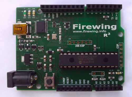

Firewing R2 board is another great option, as is designed from the ground up for PIC24H/PIC32MX 28pin dip case.
http://firewing.info

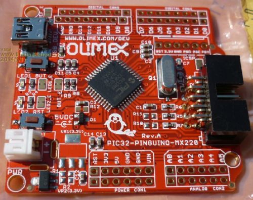

Serge Vakulenko said that the pic32prog now supports the MX1/MX2 variants, but I guess something is not working, as I bricked mine, I guess ... As I said, the pic32prog continues to detect the micro, it programs it, verifies it, everything is ok, but the burned firmware is not working (the initial firmware is not there anymore, and the new one doesn't show up).

Posted: 04:52am 17 Jan 2014
You have no ICSP pins so how did you program it?
vasi
Joined: 23/03/2007
Location: Romania
Posts: 1697
Posted: 04:59am 17 Jan 2014
This is an old picture, just after "unboxing". I have sockets soldered in place.
Elvish name: Mablung Miriel
Beyound Arduino Lang
Posted: 06:37am 17 Jan 2014
Oh, OK.
