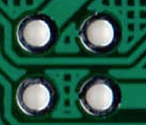

One constructive criticism is that the Pad holes that are GND are fully connected to the GND plane (Polygon fill) and that might make it difficult to get enough heat into those pins to solder easilly.
See the Right hand Pair of these pads , below, to see what I mean.. They are connected to the Polygon GND fill but only by small traces (usally 4 , top, bottom, left and right) to the large GND fill.
This allows the pins to be soldered without a lot of heat being applied.

Actually not a great photo but was a quick scan... If you like I will cut and paste from Protel to show what I mean.

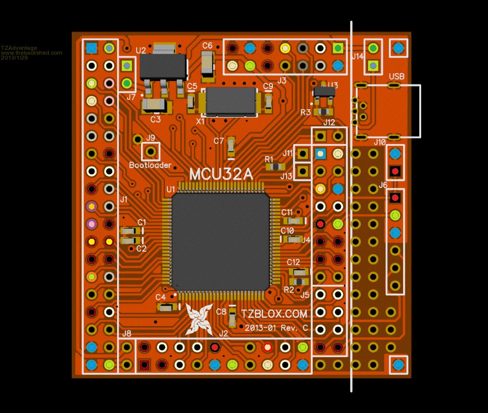

Thanks for the feedback.
I fixed the 0.1" grid. I had to move one connector to have more space for traces but i found another way to route it (all manual as autoroute does not give good results).
The footprint for the caps close to the regulator are on 1206, for smd that is already rather big. :)
For C1, i routed the board with a 0603 as that as the size for a X5R, making it bigger will require major rerouting and searching the web i found a few alternative brands with the same 0603 footprint.
The copper pour is now with thermals. Have to clean up some manual routed traces that interfere with that.

When you use reflow would large copper contact not be better, like when used on a hot plate?
Or is the 4 spokes a good compromise for smd parts.
For through hole i have experienced the advantage of thermals. :)

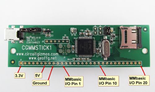

That is only slightly more board area than the CGMMSTICK, and you placed a 100 pin chip instead of the smaller 64-pin. Good job!

I moved the supervisory chip to another place and that will allow an even smaller versions of the board. Everything is on 0.1" grid.
The cut of line will be right next to the connectors, cutting of the micro usb and icsp. It will then be 50x40. :)
Good if space is a premium.
Still allows usb and icsp connection through the existing connectors.
I have dropped the diode that protects if you have usb and external power at the same time and replaced it with a header so that a choice can be made to use diodes or a switch.

Few hours later, eyes half closed. :)
Moved some parts around, made a cutoff area if you don't want USB and ICSP on the board and added a mini 'sea of holes' or maybe better named a 'lake of holes'.
Added headers to breakout the USB pins.
Color coded the pins in use by maximite. (
Light green/dark green center = 3.3v
light green/greyblue center = 5v
blue/blue center = vss
White = PIN1-20
Darkred = Arduino pins
Grey = SD card
Yellow/Red/Green/Blue = VGA,
Black/Red center = reset
Edited by TZAdvantage 2013-01-29

Posted: 11:30am 28 Jan 2013
Very impressive.

Hi TZ,
I am no expert on Reflow solder.. (In fact I am not an expert on much these days) but you did say that it was for Proto and Production.. I was commenting on it from a hand soldered perspective..

Believe it or not , but the board i designed started out as single side.
I found out however that putting in the decoupling caps and the crystal made it impossible. The crystal has its own caps, ground planes and similar length traces to minimize the influence to and from other traces/parts.
The traces would be too long and the size of the board would at least be double when using single side.
I then made the decision to make it a double sider and put on all the parts that are absolutely necessary for a working PIC32. Then put on the headers to get everything on a 0.1" grid for through hole use. Having space available i put in the 3.3v regulator, supervisory, USB and iscp.
Designing some i/o now is very easy and can be done on a vero board or single side home made boards.
The arrangement of the headers is not with an Maximite in mind. They are grouped according tothe peripherals in the PIC32. Especially I2C,SPI,Serial Port A,B and E, CAN and a 16 bit PMP port suitable to control a LCD or large amounts of IO like LED arrays.
MM uses very few of these as VGA uses most of the SPI/Serial/I2C peripherals and uses bitbanging to compensate for it. Others who would like to program in Assembler or C would rather use the peripherals directly and this board allows that as every pin can be used as you wish. As such it is for me a direct replacement of the UBW32 which is a nice board but the shape is too long for all of my final products that i have in mind to make. That shape is perfect to put it in a breadboard, but my board using female headers would be sitting next to a breadboard and offer the same ease of use.
In short my feeling is that single side can be done, but in the end it is not as reliable as a double sided and i doubt it will be cheaper.
