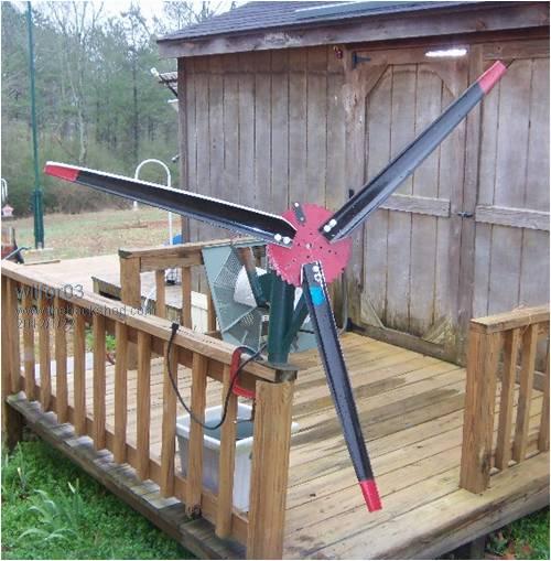

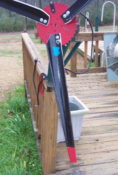

  isaiah said
WILFOR03 Tell me more about your blades maybe a picture what size pvc did you cut them from?
Did you remove the encoder and break in the back of the motor?
Isaiah
Made these from 4" PVC pipe from Lowes. Cut it into three sections 36" long, then
measured off 1 3/4" on the right side (tip), ran a paint tape down to the opposite
bottom corner (root)for a straight line to cut on, then rounded over the leading edge
and feathered the trailing edge for a knife like shape. Whoala....took maybe a half
hour for all three. Balancing takes a lot longer than building them.
I've built these with only testing in mind, wooden(chainsaw) blades will follow
once I like what I'm comfortable with. Here's a couple pictures for ya. Hollar if
I can help with anything else......
Oh, yes, I did break open the servo when I first got it. The break was locked on it
so I broke open the motor, pulled the brake assembly off (heavy bugger! )
and pulled the encoder guts out at the same time. Not really that much of a hassle,
either. Beefy bearing in these things, too!

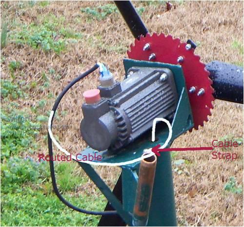

  isaiah said   wilfor03
What do you do with the drop wires? do you drop them through the mast pipe or let them dangle on the outside.IM working on some Idea's for a new mount .
Hey Isaiah....
I just route my servo wires through a cable strap on the motor mount, then down through
a 3/4" hole through the bearing on top of the tower pole/mount and then into a 20a male/female extension cord plug (down about 2' inside the tower pipe). The plugs are wired together with coat hanger straps and electrical tape to keep them from wiggling apart. Just a quick change way of swapping out motors when I want. Been working for over a year now pretty well.
Hope this helps you out a bit 'n let me know if ya need anything else.
