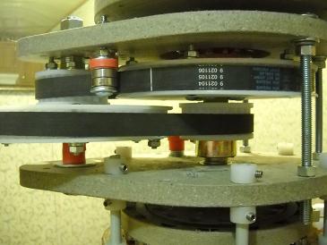

Hi, I agree with what your telling me. Suggestions and comments are always welcome. When I made the pulleys I rounded off the teeth to much. The weight of the mag rotors is about 20 pounds and there is a lot of force being applied to the teeth on the pulleys to start the mag rotors spinning. Using a wider belt and machining a better pulley to match the profile of the teeth on the belt should solve the problems. Thank you for all the suggestions.

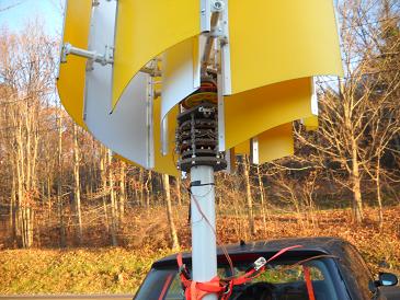

Hi, I pursuing the timing belt and grooved pulley approach because they are using the same technique to replace the chains on bicycles with timing belts. It offers very low bearing load and zero maintenance. I made some test pulleys out wood with larger teeth and a much better fit with the belt profile. I am very happy with the new test pulleys performance. I have gained valuable experience from the earlier attempt so it has not been a wasted effort. All comments have been very helpful, thank you. I am continuing with the modifications and I will post road test results when available. Thanks again and enjoy the day.

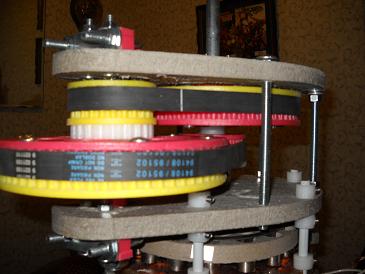

Greetings, I finally found the correct timing belts. I had to make new pulleys. I purchased them for a auto parts store and the sales person told me they should be replaced every 60,000 miles The teeth are very large and the belts do not stretch. All the problems have been resolved and I do not for see any maintenance problems. Please disregard all earlier posts about timing belts. I am using a standard configuration for one direction operation. Enjoy the day.

With about the same size pulleys it now has a 7: 1 ratio. I am not sure why but that is the way it worked out. I use a software program to generate the tooth pattern, it is low cost and works well. If you search for wooden gears you can find software. I am fabricating longer blade spokes so the blades will clear the offset belt drive. I will post road test result when available. Enjoy the day.

That setup is looking good, it should spin easy.
Well done.

Posted: 07:32pm 04 Nov 2011

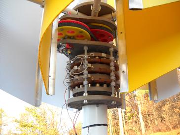

Results from todays road:
The inner set of blades are still to close and hit the transmission pulley.

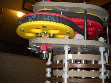

I was able to do run the test using the just the outer blade. I noticed a improvement with the cut in voltage at a lower MPH. Shortly after cut in I heard a ratcheting sound of the belt jumping the teeth on the pulley caused from the movement of the idler pulley. I have to move the inner set of blades to a location where they will clear the pulley and improve the design of the idler pulley. Hope to road test again in the need future. Enjoy the day.

Hi, yes that is what is happening. I mounted the idler on a straight post and it solved the problem. I still have to move the inner blade mounts out another inch and hopefully I can try another road test today. Enjoy the day.

Greetings, results from today’s road test :
the idlers need to replace with a better design. The force the belt is placing on the idler’s is great and pushes them away from their ideal location. I am also taking the time to cut better cogged pulleys that will fit the belt pattern better. The results of today’s test indicates once the problems are solved with the idlers that larger blades or blades with scoops will be needed. Comments welcome.

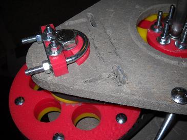

govertical
Joined: 11/12/2008
Posts: 383
Posted: 05:10pm 10 Nov 2011

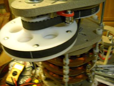

Project update: Using a suggested method, I removed the idler pulleys and fabricated a u bolt mount to adjust the timing belt tension. It is very smooth and quiet. If the belt does not stretch there should be no maintenance required. Will post results of road test when available. Enjoy the day.

Simplicity at it's best!As you've said "if the belts don't stretch"Cheers Rastus

Greetings, results from today’s road test:

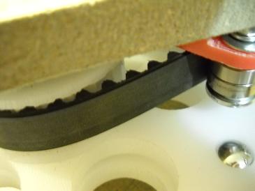

at 5 MPH it started charging @ 0.5 amps. The belt again started skipping at a 2 amp output. I tighten the belt and started over. At 4 amps output the belt started skipping again. At that point the belt was so tight that it caused a increase load on the bearings and to me it did not make any sense to continue. I was expecting to see 8 to 9 amps @ 20 MPH because of the 7:1 ratio but only had a 4 amp output and the belt was still skipping. From today’s test results I am concluding that auto timing belts at such a high geared ratio can not handle the forces being produced and the current blade configuration started to stall at a 2 amp output caused from the accumulative load of the belt drive and the PMA. The current system looks good in the picture but does not perform well. It is a learning experience and a first attempt. I am fabricating new blades and reducing the ratio of the belt drive. Comments welcome.

Hi, thanks for the suggestions. I was able to exam my PMA and belt drive more closely after the road test and I found that the main shaft was flexing off center as I tighten the timing belts. This allowed the belt to walk over the teeth on the pulley. The more I tighten the belt the more the center shaft was pulled off center. I have to include another bearing above the bottom pulley to prevent the problem. I also believe that the small pulley is to small and not enough teeth on the belt are engaging the pulley. I did find out that my current blade configuration does need to be improve. I purchase some 6 inch pipe and I should be able to configure a C rotor style blade or J shape blade and do another road test in a few days. Thanks again and enjoy the day.

Interesting results. I would not try a larger than 6:1 ratio with any belt type if the pulley sizes are to be kept manageable (sufficient No. off teeth to engage the belt on the smaller pulley).
