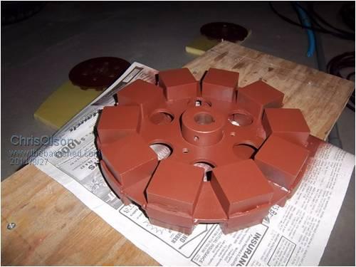

I plugged Glenn's results into my spreadsheet and he's getting exceptional flux density in the air gap with his setup. I'm running the air gaps at 17mm on one stator and 20mm on the other one, and I'm getting only about 2/3's of what he's getting (around .2mT).
I too have gone to running a wider air gap and either throwing more speed at it, or a few more turns of wire to prevent contact between the stator and rotating assembly in operation.
I like Glenn's design but on a bigger and more powerful unit I would be worried about the mechanical stress on the stator mounting it in the middle. The torque on the mount is substantial, as it is, when you mount the stator on the outside.
When you get to 2 kW of power output at the stator @ 70% efficiency the stator assembly is providing about 67 lb-ft of braking torque to the rotating assembly @ 300 rpm. I could work out the stresses on the stator casting and mount when it is mounted on the inside like that, but I suspect that the mechanical working limits of a fiberglass casting would be exceeded at that power level if it were mounted on the inside, unless some sort of reinforcement was added to it.

ChrisOlson
Joined: 19/01/2010
Posts: 60
Posted: 03:11am 27 Aug 2011
  mac46 said   Hello Glen,
I can see that there are a few folks that are picking you'r project apart.
Few folks are building generators with ferrite magnets so Glenn's project is quite interesting. I'd like to find out more about those magnets he's using because he's getting more flux density in the air gap than my gauss meter showed my ferrite blocks had at the surface of the magnet. I used C5 blocks and they're supposed to be about .35 mTesla in the core of the magnet, which is about 1/3 of what a N42 neo is. And that's about what I got in the air gap - 1/3 of what the neos are.
I used a larger (50mm x 50mm x 25mm thick) block that has twice the surface area, and twice the thickness of the neo magnets I normally use, so I ended up not having to use three times the turns of wire. But Glenn's design is quite amazing using the two magnets per generator pole.
Chris
off-grid in Northern Wisconsin, USA

ChrisOlson
Joined: 19/01/2010
Posts: 60
Posted: 12:11pm 27 Aug 2011
  Gizmo said  The way I see it, any flux that takes a path from one magnet to its neighbor is wasted,
Yes, I suspect you're right. I had to "scrunch" my magnets closer together to get 10 poles to fit on 280mm rotors and I may be losing a bit of magnetic performance at the inside corners where the magnets are about 8mm apart. See the attached photo of the center rotor to visualize what I mean.
I know another fellow from Ireland that built a 5 meter machine using two 50mm x 25mm bars arranged in a "tee" configuration for each generator pole. He also got good results by using more than one magnet per pole.
