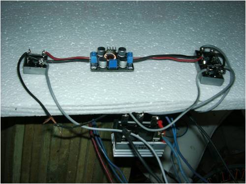

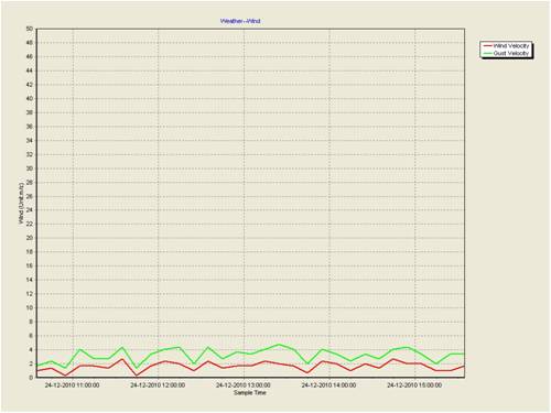

The rain stopped for a few hours today, so I decided to fit the boost modules to the mills to get an idea how they would perform.
The results where quite pleasing, I had steady slow wind speeds as shown in the graph below.
The boost modules are set for 26.5 volts DC output and work from 5 Volts AC input to 32 volts AC. They cut in at four volts AC, as thats enough power to get the boost circuit activated and 75 ma output into the batteries at cut in.
At 10 volts AC the module delivers 1 amp at 26.5 volts at 12 volts AC it delivers 2 amps at 26.5 volts and 15 volts it peaks at 3 amps, at this point the GTI is cutting in and sync's so the mill is loaded a bit heavier. When the load voltage goes above 26.6 volts it shuts down
During the testing at the wind speeds shown the Boost module went from 100ma to 3 amps
Once it got to that level the doubler circuit started to come in with 1 + amps so there wasn't any appreciable gain in amps from the module.

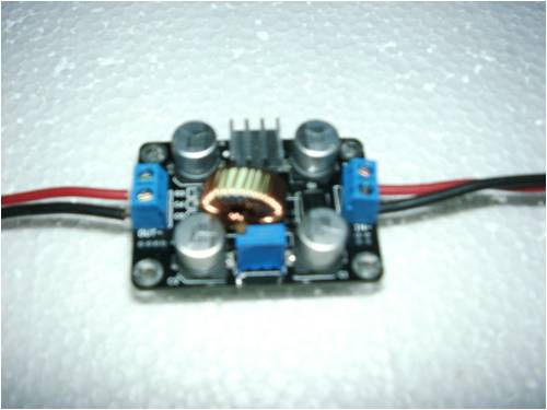

As its rated at 3.5 amps continuous or 5 amps intermittent with current limiting at that, it is working well within it's specifications. If the batteries where to drop below 24 volts it would max out and and current limit.
The arrangement of the module is a separate 3 phase bridge to feed it and a single bridge on the DC output to isolate it from back feeds from the battery or other charging circuits. Seems to work well and no smoke so far.
As you can see it is quite small about the size of a matchbox. cost around $15 on fleabay, which worked out less than the cost of the components, not to mention the circuit board, I could have built one but my eyesight isnt to good in these little things.

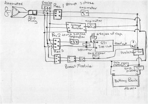

I have been doing experiments to get the best low speed power out of the mill as it does a lot of spinning around without putting any power into the battery, so here is a mud map circuit as to what I have been fooling around with as documented in the previous post.
After reading the post I decided that it was a bit difficult to understand and a simple circuit would help.
Sorry for the poor quality of the diagram as I had to do it by hand after playing with a circuit drawing program with no success,I had hoped to make it look good and clear but, my well below average computer skills let me down, and there wasn't any grand kids within Cooeeee, never around when you need them.
Hope you can make some sense of it.
All the best

This is a cut and paste from fleabay, the unit is a current limiting device, there are some available with a LM2577 but they don't have current limiting, they are a bit cheaper.
LM2587 DC-DC Step-Up Module Input 3-24V Output 4-35V

The circuit in the booster supplied isnt the same as in the info sheet they have designed a circuit to do the job.

Its a neat little doover and I think has the ability to extract the last few milliamps from the mill.

Thanks Bob for the info and thanks Pete for the link - I have ordered one now. One can never have enough gadgets , besides, the geared up VAWT I have can do with any help available to get an earlier cutin to my 24V battery bank. I do have the capacitor doubler arrangement but that moves the needle of the 0-5A output meter off the zero peg only in the gusts. The mill is turning most of the time the wind blows.
Bob, studying your hand drawn circuit I notice you have placed what appears to be another rectifier at the output of the booster module. Could you confirm it is indeed a bridge rectifier and if so why rectify the DC output from the module again?
edit, re reading the original description of your set up I see it is for isolation. If the battery bank is always connected then the gadget would never see more than battery terminal voltage. I would put a small fuse (5A) there instead.
BTW, the battery volt meter is best connected directly to the battery terminals, not ahead of the Amp meter.
KlausEdited by Tinker 2010-12-27

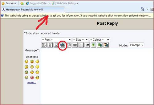

[quote]one day I will have to learn how to do it.[/quote]
Its easy Bob.
See photo..........
Click on the icon in the circle.
You might get a bar asking you to allow scripting at the top of screen, click on the bar and then click on allow scripting in the dropdown menu.
Click on the icon in the circle AGAIN, this time you will get a popup window.
Enter the link address (copy and paste) into the box, click ok.
Then enter the address again in the next box, click ok.
Thats it ...job done.

One is guessing the post rectifier is only there as a blocking diode to prevent feed back, and any single 3 amp diode would do, but Bob used a bridge module for simplicity of use.
The boost module only looks to be 90% efficient so has a reasonable loss, but 90% of what you didnt get in the first place is still better than what you had.
Pete.

The setup is a bit haywire to to allow testing for final setup, the reason for the extra diode bridge is to isolate the booster from both directions, also to stop a small reverse current, that I think is caused by the regulator voltage divider.
It should work on your VAWT providing it is doing over 10 volts AC when spinning as that seems to be when the unit starts to produce some usefull current, it works below that but only makes a few milliamps.
I have some 5 amp and 15 amp circuit breakers coming as I dont like changing fuses.
I also have a 16 amp unit coming and will see if it can replace the capp doubler as well on my next mill, time will tell.
The big bridges are a bit of an overkill but cheaper than smaller bridges.

That module you are changing dc to ac to activate the module then it changes back to dc.? Could it be wired to run on all dc?.
I may think about one for my mill to boost up some of the below cut it to use full.

The reason for the 3 phase bridge in front of the boost module is that if you connect to the existing dc then it causes a loop through the module and it wont charge, as the voltage has to be lower on the feed in side than the regulated output side for it to work. The input voltage is DC as it has the rectifier in front of it, which in effect is direct across the AC from the generator.
There needs to be around 10 volts AC from the mill to get it to work so check your output from the mill, it will work lower than that but for a very small current, mine starts at 5 volts AC but only delivers 100 ma.
All the best
