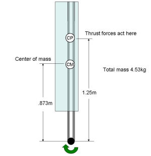

Here's my next model. I kept hitting a brick wall with the stresses getting way too high given the initial assumptions. Go figure, I think any 3.2m dia rotor spinning straight into 65 mph winds at 1000 rpm would fail. Let's take a step back and I am going to 'suggest' some initial conditions. A lot of people have made suggestions and comments and I am trying to incorporate them.
I am trying to model right when the turbine starts to furl. It is seeing the wind perpendicular to rotor at this point. The thrust forces should be highest here. Once it furls it should be slowing down or in a perfect world holding perfectly steady, right?
This model also uses a sched 40 3/4" steel pipe as the internal support rod. No metal rod and thin walled tubing as Oz has suggested.
Assumptions;
- 1.5m alum extrusion over 1.625m sched 40 steel pipe
- Furling speed for the turbine is 15 m/s (33.6 mph)
- Rotor dia is 3.2 m
- TSR = 5
- Rotor Cp is .30 which has an associated axial induction factor (a) of .019
this means that the rotor is capturing 30% of the power in the wind. Betz limit is 59%. Gen and other losses don't matter at this point.
Determine how fast the rotor is spinning at furling point
rpm = (TSR x windspeed x 60) / (pi x D)
rpm = (5 x 15m/s x 60)/(3.14 x 3.2m)
rpm = 448 rpm
convert to radians/sec
w = (2 x pi x rpm)/60
w = (2 x 3.14 x 448rpm)/60
w = 46.9 rad/sec
Calculate the centrifugal forces
Fc = M x R x w^2
Fc = (4.53kg) x (.837m) x (46.9rad/sec)^2
Fc = 8331 Newtons = 1873 lbf.
Given the cross sectional area of the pipe of .000214 m^2 we can calculate the tensile stresses in the pipe.
tensile stress = F / A = (8331 N)/(.000214 m^2)
tensile stress = 38 MPa = 5511 psi.
Calculate the thrust force
As Oz and I were discussing I am going to use a rotor Cp of .30. The rotor will capture 30% of the energy in the wind. This is reflected in the thrust equation by the axial induction factor (a)= .091
The Thrust equation is
Ft = 2 x rho x velocity^2 x a(1-a) x Area
Ft = (2)(1.223 kg/m^3)(15 m/s)^2(.091)(1-.091)(3.14)(1.6)^2
Ft = 366 Newtons = 82.3 lbf for the rotor
Ft = 122 Newtons = 27 lbf for each blade
Does this not look a lot more realistic Oz? Given the lower wind speeds and the departure from the betz limit things seem to reflect real life much more.
Determine the bending moment this force applies to the blade root
I am applying the force at the 3/4 point of the blade towards the tip
M = force x distance
M = 122N x 1.25m
M = 152.5 N-m
Calculate the stress in the pipe at the root
c for the pipe is the pipe radius. moment of inertia (I) is 1.54x10-8
stress = M x c / I
stress = (152.5N-m)(.0134m)/(1.54x10-8)
stress = 132 MPa = 19.1 ksi
We can now add the stresses together
total stress = centrifugal stress + bending stress
total stress = (38 Mpa)(132 MPa)
total stress = 170 MPa = 24.7 ksi
So where does this leave us?
Just buy redefining the question to reflect more realistic circumstances we see that the The stresses from centrifugal and bending moment forces come in at about 24.7 ksi. This is about half the yield strength of mild steel. The highest forces occur right where the pipe connects to the hub.
Perry
Edited by Perry 2009-12-02

To accomadate Oz's suggestion that there is a runaway of 1000 rpm under no load conditions and no real thrust forces we have;
Fc = M * R * w^2
Fc = (4.532kg)(.837 m)(104.7 rad/sec)^2
Fc = 41582 Newtons = 9348 lbf
stess = F / A
stress = (41582N)/(.00214 m^2)
stress = 194 MPa = 28.1 ksi
So the centrifugal forces become 28.1 ksi.
Once again, the pipe will hold if the hub will.
Perry
oztules
Joined: 26/07/2007
Posts: 1686
Posted: 09:50am 01 Dec 2009
Your a wizard Perry.
This seems to be more in the realms of what I would anticipate. I think a single supporting member is simple and less likely to fail from poor assembly and stress points. My hubs are made from 14"x 8mm mild steel disks (x2) so my hub would definitely hold these forces in check. The turning center is a 4000lb trailer stub axle... easily rated I should think for this application. It would only see thrust and turning moments from yawing the hub/blade assembly.
Do you have a feel for the magnitude of the yaw forces when turning this gyro in the wind? I'm told that they are of similar magnitude to the thrust.... but of an oscillatory nature.
I suspect that the reason this was said, is that in this application, the thrust is related to the furling/yawing system... as the thrust increases, we furl out of the way.... or the tail exerts less turning moment on the mill than the mill exerts on the tail via the offset.
I find it difficult to see how to equate the spinning mass to what the tube and the hub would see. I guess it depends on the rate of turn involved...controlled by the weight of the tail and the pivot angle used. How do we quantify that.... it all gets a bit murky about now.
Well done again.

Okay, I'm getting thrust numbers that agree with Perry's. I'm using a completely different method - I integrated the series of lift forces along the blade given the velocity, angle of attack and wind inflow (with same correction factor "a"). I hope this offers some confidence, seeing the similar result from a very different method.
I've also tried a few other scenarios. For example, the same rotor with the same incoming wind could be turning at different RPM's depending on the load the generator imposes:
Vw=54kph w=200RPM Cp=0.14 X=1.4 Thrust=49 pounds
Vw=54kph w=300RPM Cp=0.23 X=3.4 Thrust=77 pounds
Vw=54kph w=400RPM Cp=0.23 X=4.4 Thrust=83 pounds
Vw=54kph w=600RPM Cp=0.16 X=6.7 Thrust=84 pounds
Or I can set the wind speed higher and see what happens:
Vw=100kph w=600RPM Cp=0.24 X=3.6 Thrust=275 pounds
Vw=100kph w=1000RPM Cp=0.21 X=6.0 Thrust=298 pounds
I can play around and find even worse situations, and the thrust can get up to 400 pounds. Thrust is loosely related to Cp, but after a point it breaks away and it still gets larger even as the Cp gets smaller.
Steven T. Fahey

Don't feel so dejected! As I said before, this isn't impossible to calculate and I have shown you all the formulas and calc's in the last post. You should be proud that your gut instinct is so close to what the math bears out.
Sparweb pointed out a lot of good info and a very complex way to look at it. If you'd like you can delve into it on that level but as he said, his numbers tended to match mine which are derived from a simple energy balance equation. As I said in my first post on this thread, everyone was saying the math was too complex to figure out. The reason I got involved was to prove this wrong. Step one is to strip away all the speculation and complexities. Sparweb has added a lot of complexity with that last post that departs from this. In the end, his reasoning is right and the answers come out similar to mine.
Steven,
The thrust force from a rotor is indeed very dependent on the Cp of the rotor. The thrust force is a reaction to the energy captured from the wind. A high Cp captures more energy and the reactant force is higher. Newton figured it all out for us years ago.
Add to that the formula for turbine thrust forces has the Cp right in it as an input.
There are cases when my method breaks down, like when furled. But for all the circumstances I can think of, the thrust force will never be higher than what the equation yields. Which is in the spirit of determining the max loads in a simple manner.
Also, Steve, your example of the turbine running at 1000 rpm with no load blows up my model. Then again, This condition assumes that something electrical and your furling has broke. At this point your turbine is probably already destroyed anyway.
I am confident that my numbers are solid.
Perry cringes hoping Flux or Hugh don't post here that he has been wrong all along.
PerryEdited by Perry 2009-12-04

This thread has gone well beyond where I could ever have imagined it would go. The longer it gets, the more complicated things seem to become. It makes for interesting reading, but for us old hands-on folks, it's just reading for the sake of reading. I have no idea what it's all about.
As regards all this, might I make a suggestion?
Since the stresses are each a function of differing materials, differing moment arms (fulcrums) and expanding stresses as distance from the hub increases, why not concern ourselves with merely the final third of each blade? By that, I mean use a solid-rod blade shaft (or a tube or carbon fiber or wood or whatever), but attach the "blade" at a point 2/3 the distance from the hub to the wing tip? There's not much power to be lost regarding the inboard 2/3 of the blade, so why complicate things by having a complex curve incorporated close in?
I think similar power could be attained from moving the force area of the blade outboard. At that position, a feathering mechanism, which starts steep, then "feathers" to a less-steep pitch would assure starts in low to nominal wind, but also assure higher speed once the whole thing is whirring around like a blur.
An analogy might be to view a canoe paddle. Which makes more sense, a big long full-length blade or just a small flat blade near the tip?
Using a feather-to-greater-speed mechanism will likely scare some folks, but a furling device can be used to handle over-speeding and yaw stresses would more-easily be handled by a homogeneous solid (or hollow) shaft than a complex extrusion.
This started out being about extruded aluminum blades (I think!) and that is light-years ahead of anything I could come up with. Why not use that idea, but augment it into such a manner as to minimize the stresses. Using a "section" acting as a paddle on the end of a round shaft sounds like it might have some merit.
You already know I'm all about "simplest is best" and while this may be "too" simple an approach, still it beats the heck out of having to be a graduate engineer, trying to figure out all the 'what-ifs'. Although I know and am grateful for those more clever than I (graduate engineers), the trial and error method in my estimation seems to run a pretty close second here!
Hope this helps. If not, I hope it is at least more 'interesting reading'!

Yes MacGyver it has evolved quite a bit. Sorry if I got a little heavy into the math and I hope this isn't construed as showing off or hijacking this thread. Phill asked for some help and I thought I would chime in. I did try to take the time and spell out all the formulas and include all the units/etc so people could follow along and use the info for their own good.
Having said that, Do I believe what I have written will stop people from trying what seems to be right? No. And I guess on some level that is a good thing, right? This is after all a hobby and a big part of that is on the fly creativity.
In their book, the Dan's have a great quote;
"A week in the lab can save you an hour at the library"
Perry
