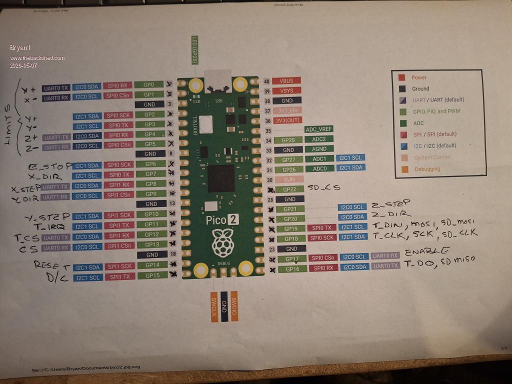

Now thinking aloud about the pin assignments
As we are now upto 4 axis with 3 pins being enable, step and direction, 12 pin's.
6 pin's for the limit switch's, one for the E-Stop and one for the motor via a relay board.
Now for the E_Stop if it is Active Low a N/O external switch could be used so an external switch can be used for the E_Stop.
14 pin's if we use a SSD1934 LCD so we are now upto 34 pin's as I do think the ILI9488 3.5" LCD is too small to use as the interface so YES Peter's big 2350B board will be the best one to use.
To use the Brain Trust on this forum whats the biggest LCD screen we can use on SPI so the pin count can be reduced so a 2350A pico could be used.

Posts: 3429
Posted: 12:42am 07 May 2026
  Quote  As we are now upto 4 axis with 3 pins being enable, step and direction, 12 pin's.
Would connecting all Enable inputs to 1 Pico pin help?

Posted: 01:04am 07 May 2026
Morning Guy's well just ordered that 4" LCD   and just got a message those pico 2 chips are ready to be picked up so let the fun begin.

Posted: 03:13am 07 May 2026
G'day,
Good thinking Phil, looking at Stepper.c it would appear the stepper enable pins are always activated / deactivated together so we simply enable one axis only:
if (stepper_drivers_enabled)
 if (stepper_system.x.enable_pin != 0xFF)
   gpio_put(stepper_system.x.enable_pin, 1);

Hi Lyle I found a good picture of the pico 2 so just mapped out some pin assignments
This leaves GP26, GP27 and GP28 free so what do you think mate.
Now I am using my big breadboard for testing where I have 7 off push buttons to mimic the limits which did work a treat when I was using your sample code when I was testing the Y axis.
Got a big job to redo the breadboard and solder in the pins on the pico2 so that will take some time.
For the SPI LCD pinouts I got them straight from the pico manual
Regards Bryan
