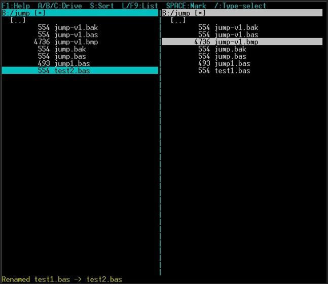

I am using FM more and more now that it's there. Discovered a little update thing. When I have the same library open in both windows, and rename a file, the filename does not update in the other window.
/Peter63

Posted: 02:45pm 19 Apr 2026
I checked FM. It works well.
I noticed a few things.
- If you start a .bas program from FM, it cannot be stopped with Ctrl-C; it only works after pressing Ctrl-C 3 times, after which it returns to FM.
- From FM, you can start it using Select and F2 EDIT. This works, but I tested it with an RP2040/16MB and it takes 3 seconds to start, and with an RP2350/16MB, it takes even 6 seconds.
The question is, what causes this delay?
> help fm
' FM                             'File Manager
' Speed ​​up FM via USB version:    OPTION BAUDRATE 921600.
' Arrow keys/Home/End/PgUp/PgDn:  Move      selection.
' ^E/^X/^U/^K/^P/^L:              Move      selection.
' TAB/LEFT/RIGHT or ^S/^D:        Toggle    Active Panel.
' ENTER:                          Open      Directory Folder.
' ENTER:                          .BAS      RUN/Execute. END:3 x Ctrl-C to FM.
' ENTER:                          .BMP/.JPG/.PNG/.MP3 Play audio.
' F1:                             HELP      Explanation of FM commands.
' F2/^W:                          EDIT      Edit selected file.
' ESC/F1/F2:                      Close     ESC Editor. F1/F2: Save and to FM
' F3/^R:                          Set       Filter.
' F4/^T:                          Clear     Filter.
' F5/^Y:                          COPY      Copy files marked with *.
' F6/^O:                          PLAY      PLAY STOP output.
' F7/F8:                          +/-       PLAY Adjust volume.
' F9/ L:                          LIST      Retrieve file after selecting LIST.
' F10/^B:                         MKDIR     Create folder.
' A/B/C:                          Change    Active Drive. A: FLASH B: SD C: USB.
' SPACE:                          Highlight Highlight(*)/Unhighlight.
' *:                              Highlight All.
' \:                              Clear     Highlighting.
' DEL/^]:                         DEL       Delete X record delete.
' G:                              GO        To path or folder.
' L:                              LIST      Retrieve file after selection LIST.
' N:                              NEW       New.
' ^N:                             Rename    Rename.
' D:                              Dup       Duplicate.
' M:                              MOVE      Move.
' /:                              Type      Select (name sort, ENTER open, ESC cancel)
' ESC:                            ESC:      Cancel or close FM.
' CTRL-C                          Ignores in FM except at end LIST.
Jan.
