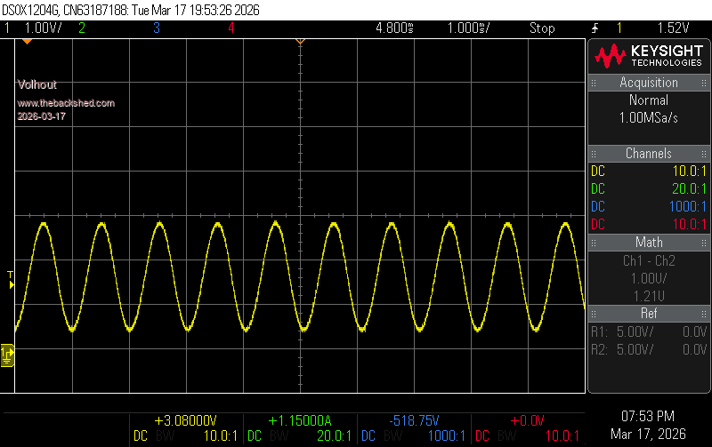

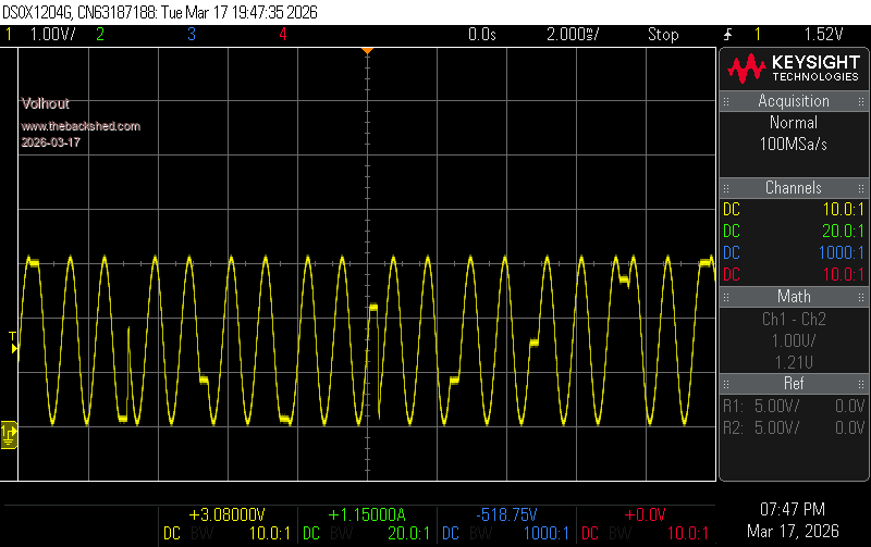

Posts: 6253
Posted: 12:35pm 17 Mar 2026
Peter,
Could you please undo the changes in RC4/RC6, where calculations where taken out of the HW interrupt. The earlier versions had a nice soft transition to the next sinewave. rc6 does not have that anymore.
This is a varying frequency tone on rc2, using Frank 's program. Nice sine waves with smooth varying tones.
Play volume 100,100
For z=1 To 4
For n=980 To 1020
 Play tone n,n
 Pause 2
Next
For n=1020 To 980 Step -1
 Play tone n,n
 Pause 2
Next
Next z
Play volume 0,0
'Play stop
Pause 200
Loop
RC2
This is the signal of the same program running rc6 (the improved version you fixed for frogger).
RC6
The change is definitely a step back. Please undo this change.
Edited 2026-03-17 22:38 by Volhout

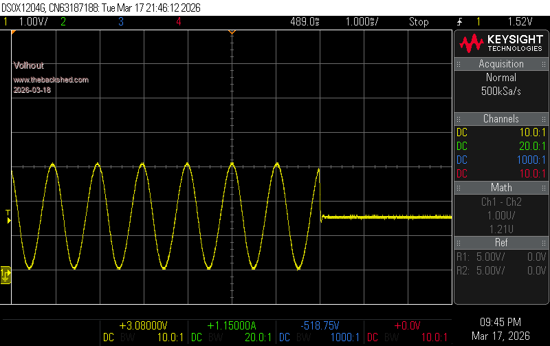

Posts: 6253
Posted: 02:26pm 17 Mar 2026
Hi Peter,
That was confusing... the previous was a microcontroller binary, this is a VGA binary.
Getting closer, there are no irregular transitions between the sine wave changes. But the VOLUME 0,0 is very abrupt, not as smooth as in rc2.
