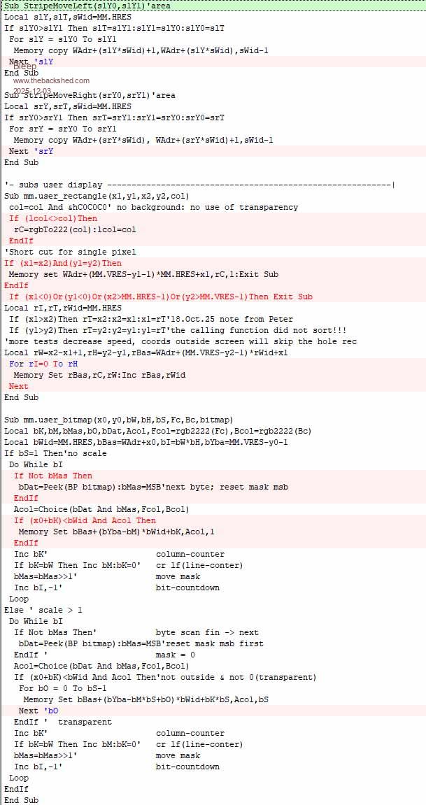

Interestingly if you are trying to squeeze the last bit of speed, changing the way you do end of line comments makes a noticable difference, so instead of:-
bYba=MM.VRES-y0-1          'calc outside loop
bMas=0                     'init val to read byte first
bI=bW*bH                   'all-count
bK=0:bM=0                  'init
Do This
bYba=MM.VRES-y0-1'          calc outside loop
bMas=0'                     init val to read byte first
bI=bW*bH'                   all-count
bK=0:bM=0'                  init
I assume this is because the parser continues looking for code until it find a comment or line end?
Also Next loops are faster without the return lable so:-
 Next i
Next j
Do this
 Next 'i
Next 'j
No idea why this might be, try it in your StripeMove routines, in some places as in after a Next, if you put the comment immediately, when you save the code the editor inserts a single space, again not sure why?
Regards Kevin.

also if "IF then" are only in one line
If lcol<>col Then rC=rgb2222(col):lcol=col
If (x1=x2)And(y1=y2)Then Memory set WAdr+(MM.VRES-y1-1)*MM.HRES+x1,rC,1:Exit Sub

thanks to Kevin's(Bleep) suggestions, I found a few more areas for optimization and have also incorporated his improvements into this version.
Kevin suggested making the “last color” global, and he was right. The ‘static’ variables worked, but they were slower than the “global” variant.
Since color conversion seems to be time-critical, I have now used a pre-calculated color table.
I have no more ideas how I could further optimize the “USER driver.”
I think this is the final version.
Hub75UserGen.zip

I've tested you latest driver all looking good, thank you, I have been able to speed it up a little, my speed test is to run all of your checks from the driver, removing all the Pauses, I also add a load BMP of 128x64 then StripeMoveleft the whole screen 128 then Blit load the same BMP and Blit Write it across the screen in steps of 16.
With the driver as above it all takes 30.3Sec, if you make the changes below it drops to 28.13sec.
I have unrolled some 'If' statements, for whatever reason it makes them faster, maybe it is to do with whether the 'If' succeeds or fails most of the time? also removing the loop identifier on Next for the StripeMove subs improves them. :-)
Hope this is of help.
Regards, Kevin.

Hi Kevin,
Thank you very much for your support, ideas, and testing for this project.
I have incorporated your changes. I wasn't aware that the move function was used so much. I've made a few more changes here.
Sub StripeMoveLeft(slY0,slY1)'area
Local slT,sWid=MM.HRES,sDec=sWid-1
If slY0>slY1 Then slT=slY1:slY1=slY0:slY0=slT
Local sSrc=WAdr+slY0*sWid,sEnd=WAdr+slY1*sWid
For slT=sSrc To sEnd Step sWid:Memory copy slT+1,slT,sDec
Next ' slY
End Sub
Sub StripeMoveRight(srY0,srY1)'area
Local srT,sWid=MM.HRES,sDec=sWid-1
If srY0>srY1 Then srT=srY1:srY1=srY0:srY0=srT
Local sSrc=WAdr+srY0*sWid,sEnd=WAdr+srY1*sWid
For srT=sSrc To sEnd Step sWid:Memory copy srT,srT+1,sDec
Next ' srY
End Sub
I can't explain why it's faster when the loop-start is on the same line as the statement and the “next” is on a new line. Maybe Peter can say something about that.
The collected improvements in zip.
Hub75UserGen.zip
