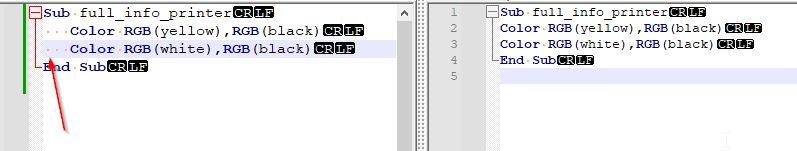

At left - will crash LIBRARY SAVE becouse of spaces in before Color RGB(yellow),RGB(black)
Sub full_info_printer
  Color RGB(white),RGB(black)
End Sub
This LIBRARY SAVE and also properly LIBRARY LIST
Sub full_info_printer2
End Sub
This will LIBRARY SAVE but...
Sub full_info_printer3
End Sub
... LIBRARY LIST will show
>library list
 Color
>_
P.S. One space is enough to call crash
Edited 2025-03-19 06:44 by electricat

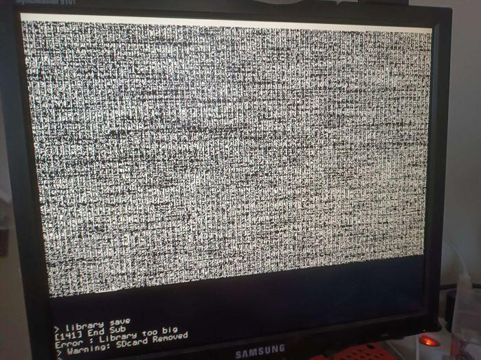

I`m afraid to be so boring, but... another sad observation.
Freshly cleared/flashed latest RC5
LOADed help.bas .. success
LIBRARY SAVEd .. success
OPTION RESET ...success. (Library deleted according to manual.)
OPTION DISK LOAD .. success(wanted to check if OPTION Fn saves/loads chr$(13) )
LIBRARY SAVEd ... FAIL!!! .
Video screen partially overwrited with data and errmsg
>library save
[141] end sub
Error : Library too big
I`m attaching file used:
help.zip
Edited 2025-03-19 17:59 by electricat

The manual needs correctly - changing options does not clear the library so you need to use LIBRARY DELETE
Edited 2025-03-19 18:22 by matherp

  Quote  LOADed help.bas .. success
Sorry but you are pushing the limits of what the system can protect against. I've no idea what is in your OPTION DISK LOAD file which includes information about the library.
I don't intend to look at this further other than to implement Gerry's fix for the COLOR issue.
Delete the library before resetting options and make sure you only disk save the options when the library has been deleted
