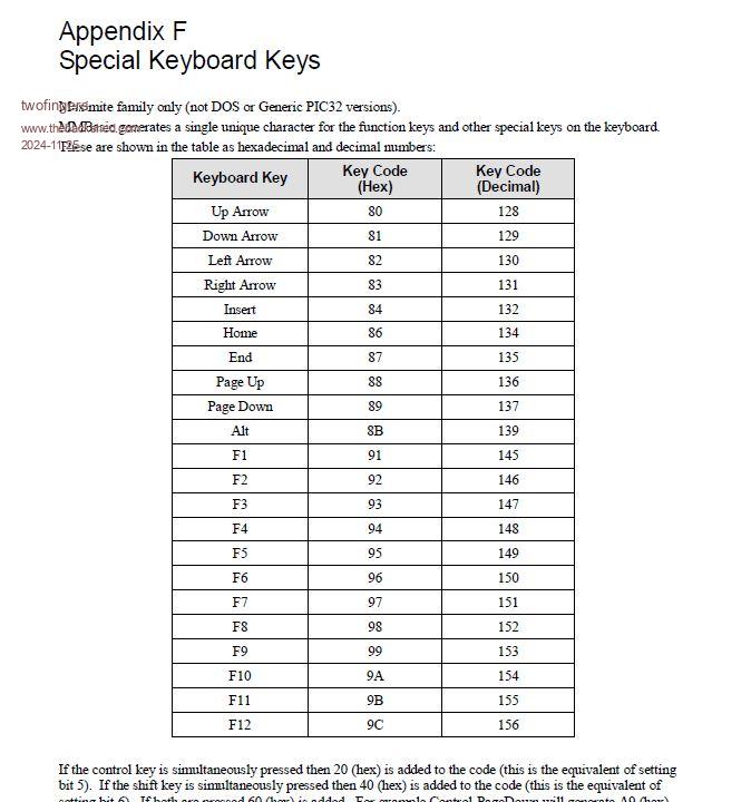

Posted: 12:51pm 24 Nov 2024
My keyboard is only connected via Teraterm. Unfortunately, switching with the ALT key does not work.
I have therefore temporarily replaced the ALT key with the backspace key (chr$(8)). This means I can also use the ALT-F keys.
FM v1.12, Line #69:

BTW. I can't find a table of "Special Keyboard Keys" in the manual. Am I just blind?
From the Maximite Manual:
Edited 2024-11-25 02:19 by twofingers
