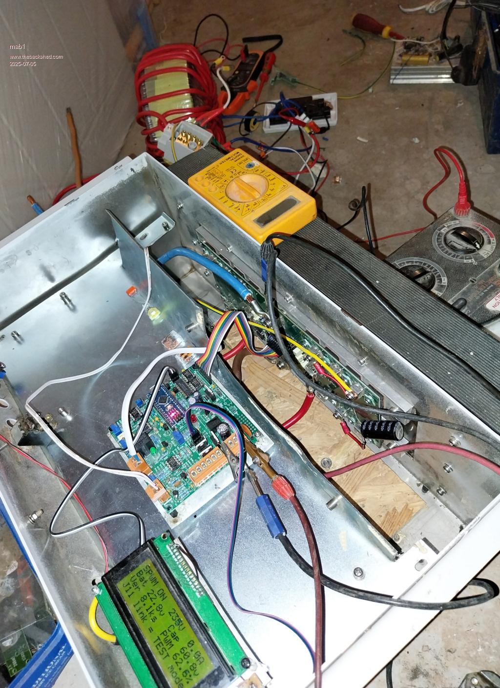

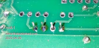

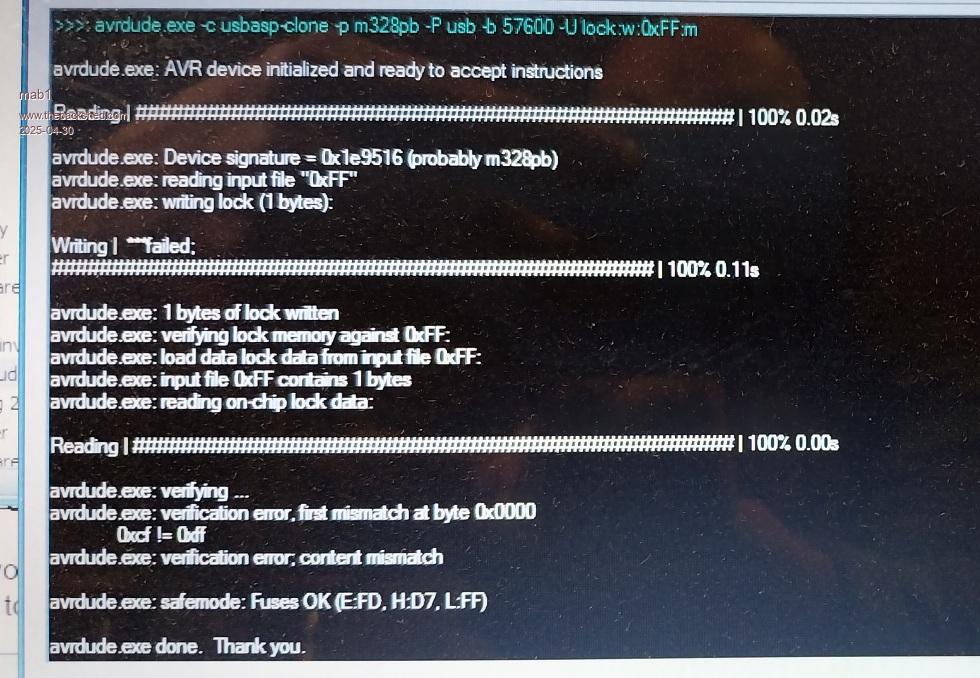

1st: I traced the problem on the WG30 power board (fault no output from one of the 12v isolated power supplies). I'm a bit embarrassed about it though.
Doh!    I must be getting old.

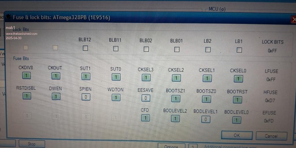

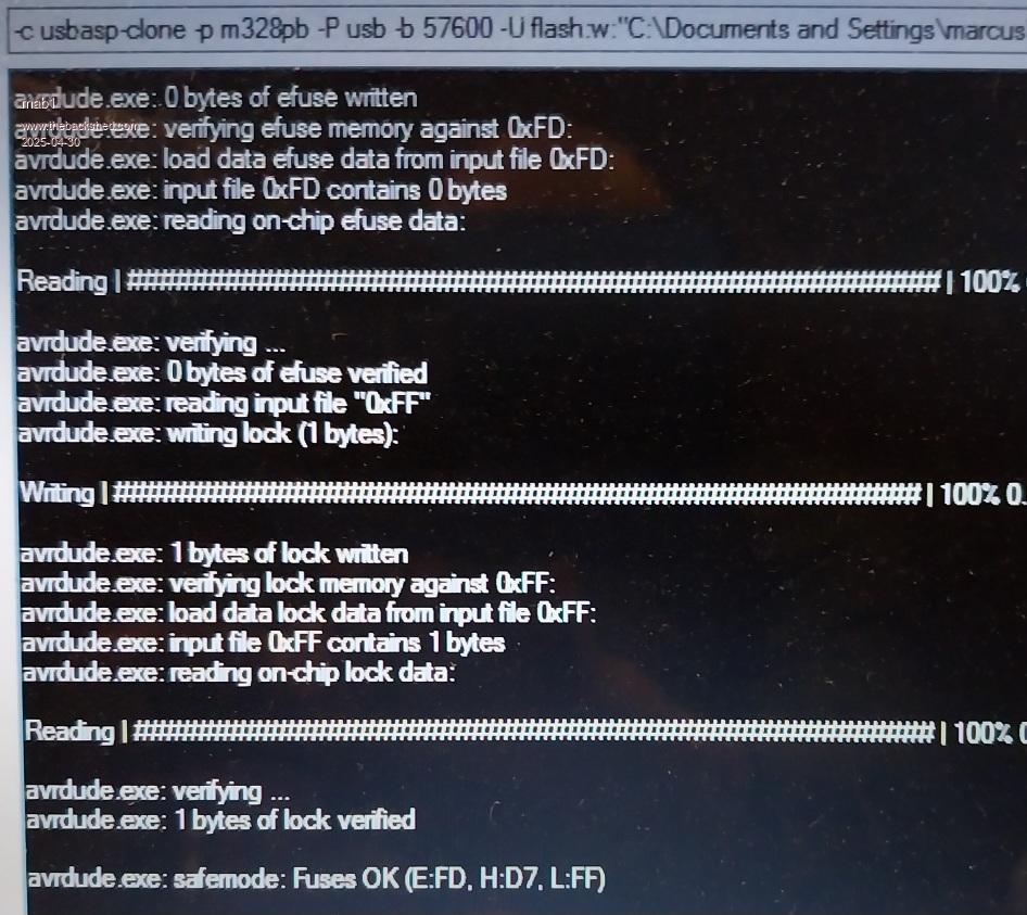

2nd: I found a version of zadig ( V2.2XP) which runs under xp (the version 2.7 included the win32 driver, but zadig2.7 won't run on win32   . Once I'd run that and set the right driver, avrdudess2.17 could see the usbasp
So I plugged in the 2nd nano we've been trying to set the fuses on in terminal on the imac. Read the fuses and clicked the bit selector:-
So it looks like your imac command lines worked after all   and it was already right.
I plugged in the 1st nano with just the hex file, that I didn't try setting the fuses on - and it's bitselector map was correct too
Just as a sanity check, I plugged in a fresh nano - straight out of its wrapper. Checked the bit selector, and the lockbits were set 0xCF
Tried to set them using avrdudess and got the same error I was getting on the imac yesterday:
Tried it a couple of times but the error seemed to repeat. So set the tick boxes to set lock when programming and uploaded the hex file. That seemed to set the lockbits :
But I don't know how the lockbits got cleared on the original nano - unless uploading the hex file on the imac erased them anyway?
No matter though - it looks like I can (finally) use either avrdudess on winxp or command line on the imac

Great to find such an easy fix on the Power Board, although I bet you were secretly  happy to find that pin floating
Yes that is common problem with programming the Lock bits, when you upload the HEX with standard settings, the Flash is Erased first.
So, to erase the flash, the Lock bits are set to FF, after the upload, unless some other command is sneaked in, they remain off.
I found earlier versions AdrDudess do not return/display the Lock and general status bits correctly.
Normally you press each READ button twice (to be sure) and then press Bit Selector to display the results, but sometimes it's still incorrect
The Important Fuse Bit is EESAVE, it must be 0, this preserves your Settings when you upload a new Hex file.

Slow progress: it isn't just winding the transformer though - the process of taking the inverter off the workbench and building it into some sort of enclosure, thinking about ground planes (been reading about other folks noise/interference suppression work) all takes time. I've decided to build the inverter into the aerosharp box ( the transformer won't fit, but everything up to and including the chokes will: the chokes and kilovac relay are under the ally plate).
I've wound a primary on the aerosharp 3kva 250/230v transformer to get up and running. 400mA idle at 42v in with 230v out of the 250v winding.
Also, I'm transitioning from 24v to 48v with this inverter, so I need to build a 48v battery (done   ) and start converting/ transitioning all the solar mppt (one poida mppt ready   ) and diversion controllers over to the new system, all whilst keeping the existing system functioning until I've reassured myself that the new setup is robust.
The plan is to start with the new inverter / battery and one solar array, and start testing with various loads, then transitioning more and more sources / loads over to the 48v system.

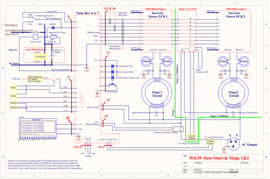

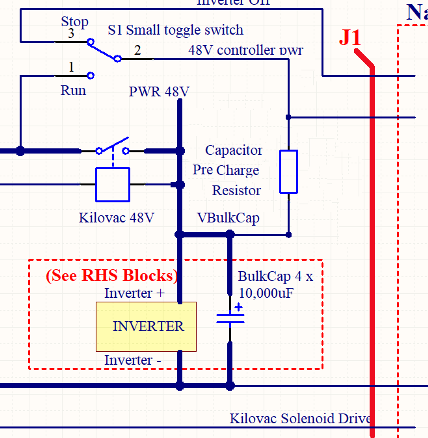

Having attached the cap boards with caps to the power board, i did have an issue:-
when i turned the inverter off, the brain board (WG39) seemed to be getting enough power from the capacitor bank to cause the nano and display to power up momentarily and keep cycling on and off until it fades to a flickering of the leds (i have installed Wiseguys 5v reg with monitor function, so must be that which cycles on and off? or the kilovac economiser cct?).
I'd followed Wiseguys schematic i found somewhere(copied below) for the on/off swt and cap precharge (10ohms), and when turned off the power appears to pass via the precharge resistor, then kilovac solenoid, to the Solenoid Q5 protection diode, D14, to +48v on WG39.
I have solved the issue by putting the +ve supply to the kilovac solenoid on the other side of the diode (i.e. +48v pin 2 of J1, but that does mean it is pulling power from the +48v cap on WG39 when you switch off   . Is this OK?
Is there a better way of connecting the on/off swt, precharge resistor and kilovac that i've missed?
In answer to the question of the voltage rating of my forklift fuses: i believe they're 72v   , although they don't have it printed on them.

KeepIS
Joined: 13/10/2014
Posts: 2287
Posted: 12:20am 15 Jul 2025
The Nano should not appear to restart with a standard 5v regulator.
Check the "Low voltage cutoff" and "Restart voltage" settings in the Menu, IMHO 10Ω may be to low a value.
FYI This is how mine is wired:
Note: I use a 30Ω resistor and the Kilovac positive "MUST" connect to the the Cap Bank, IE. After the precharge resistor.
_
Edited 2025-07-15 10:38 by KeepIS
mab1
Joined: 10/02/2015
Posts: 290
Posted: 01:05am 15 Jul 2025
Thanks,  your schematic doesn't have the diode, so presumably when you switch off the nano and display remain active until the cap bank has discharged.
To be clear, when mine was cycling on and off, the inverter wasn't coming on, just the display showing 'off', then going blank and re-initialising.
I'll follow your schematic then   ; I didn't really like having the solenoid pulling the input of the 12v reg down, as I've killed voltage regs in the past by pulling the input down faster than the output can fall.
Coincidentally,  I broke one of the legs off the 10ohm whilst fiddling, so it's now 47ohm

Posts: 3421
Posted: 01:57am 15 Jul 2025
  Quote   I've killed voltage regs in the past by pulling the input down faster than the output can fall.
The standard protection for that condition is a reverse diode from input to output.
wiseguy
Joined: 21/06/2018
Posts: 1335
Posted: 03:30am 15 Jul 2025
  mab1 said  I didn't really like having the solenoid pulling the input of the 12v reg down, as I've killed voltage regs in the past by pulling the input down faster than the output can fall.
The sequence at turn off is toggle switch turned to off, inverter ramps down, solenoid opens - there is no path to ground that I can see via the solenoid after ramp down and solenoid drive to ground (via FET which just turned off) opens.
I agree with the sneak path diagnosis via the solenoid catch diode - gotcha!
The KeepIS modification is probably the simplest cure, I'm not sure why I had not experienced the display toggling off and on at shutdown, but maybe my 24V solenoid and DIY economiser add on somehow negated the effect, or maybe I miswired it
Good to see your inverter coming along.
