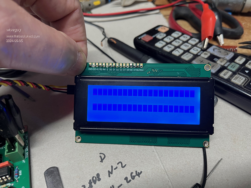

Not sure if I have good news or bad news but I KNOW what is causing the LCD code failures that Dex is having. Here is a picture of my crashed display - it took me all of 5 minutes to nail the cause.
I connected up a controller and an LCD nothing else, then I put a 150R resistor on the + input lead. And set my power supply to about 6.6V in - I also monitored the controllers 5V line which was about 1.8V when the crap hit the fan.  As I toggled the input voltage up in 10mV steps I got to a point where the Nano LED just turned on dimly, as I toggled up and down in a few 10mV steps bingo the TX LED on the Nano suddenly flickered busy and then when I applied 16V my display came up with black blocks that could not be cleared.
  KeepIS said  Trying to discharge the cap bank with resistance is not going to make any difference, the cap bank is below 12v when this happens.
I believe I was right in my assumption that at low voltages where logic etc doesn't behave well could be causing the issue. Despite protests that you doubted whether my theory was right and you categorically stated that a resistor to continue to discharge the Caps instead of allowing them to spring to life briefly could not possibly help I beg to differ.  This was occurring below 7V in.

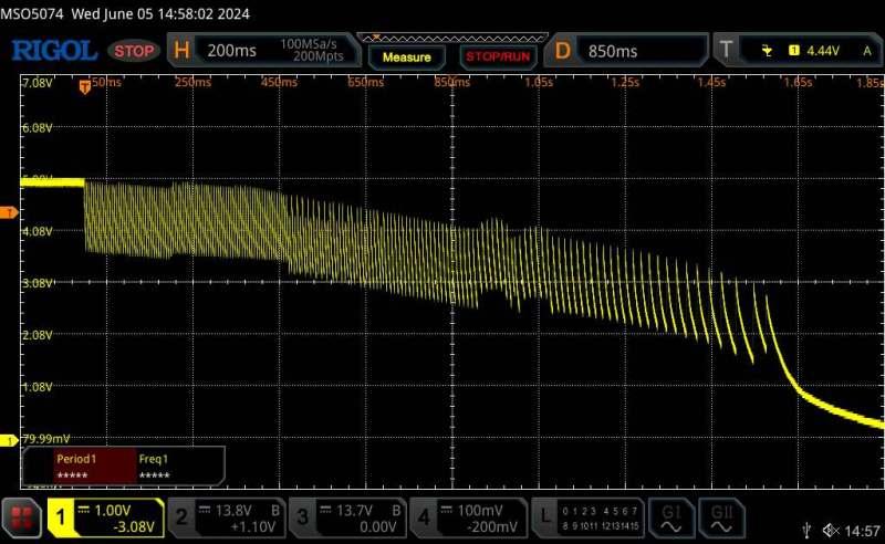

The results of my Controller - 14V input, some capacitance on the output of the 14v supply:
The current is low and 100uf on the 5V output gives a +5V decay of over a second.

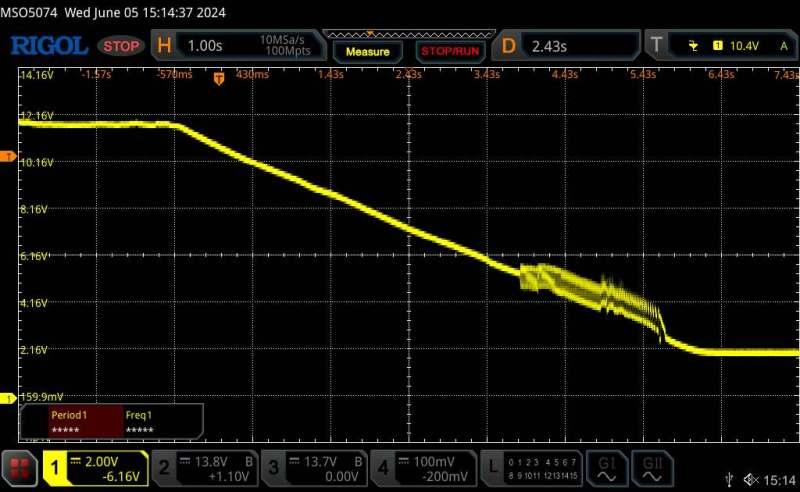

It might be the 12V regulator, but it's interesting that the switching waveform only shows up right when the +5v voltage drops, could be back feeding through the 12v reg? OR feeding through the 5v regulator.
Sawtooth frequency varies from 139Hz to 67Hz as it falls.
EDIT The 1 second fall on the 5v output may still be influenced by the 12v regulator producing output all the way down to 2v? either way a small bit of bleed on the 5v might fix it. I'll try later this evening.
12V reg output:
5V reg output:
Edited 2024-06-05 16:50 by KeepIS

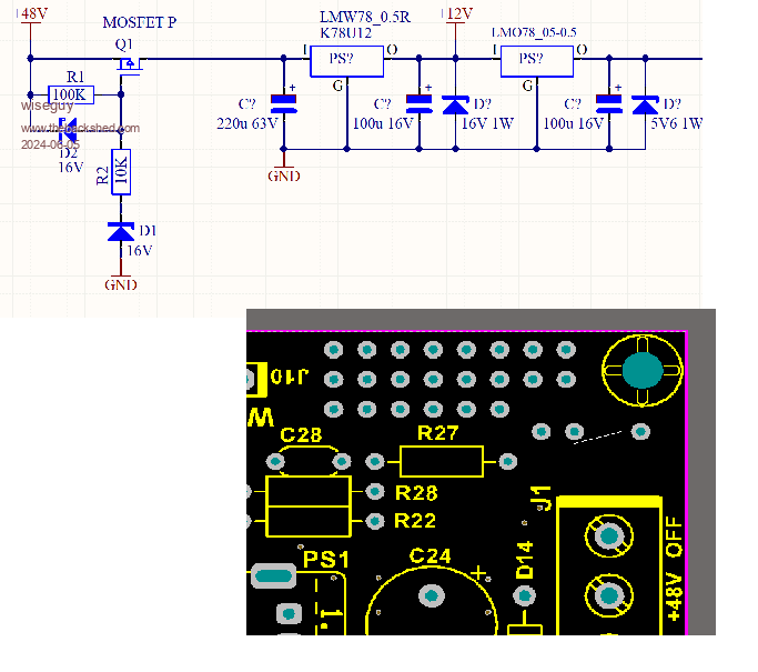

I may have a solution so I'll throw it out to the forum for comment.  I want to start by saying how much this sucks that the boards are in production and we now find out about this glitch at the 11th hour.  I expect the boards will be despatched (back to me from JL) late tomorrow.
So to the problem, everything is fine at 16V or more, below 12 and closer to 6 we have issues.  Whilst considering creating hex code to upload to the Nano as the fix I am still nervous about what I have seen and the possibility that there might still be random things to go wrong.  Maybe the final solution will be code and hardware mod ?
With all this in mind what if we could turn on the power from the 24/36/48 whatever, when the input voltage is above 16V. with this in mind my simplest solution I can think of is in the attached picture. Please note the bread-boarding area right adjacent to the 48V and regulator was a last minute addition - just in case.  I would also probably cut the track such that the 220u is on the source of the FET to ensure the regulator switches off as fast as possible.
So above 16V - probably closer to 19V the P channel FET will turn on and supply the battery input to the 12 & then 5V regulators. The second zener protects the gate voltage from being exceeded.  Below 16V input the FET is hard off.

If I could suggest anything, to be sure to get rid of the pulsing, I would do it on the 5V line.
For example, SCR (with resistor in series) on the 5V line to ground and its gate controlled by uC - maybe pin A7 could be used for this? In the turning off phase, Nano monitors the dc voltage and when it sees that it drops below 20V (or any voltage you programm), it activates the scr gate and discharge everything what is on way.
Or just simply use 7805 in place of PS2. nanos in mppt brain boards are done this way at my config (dc-dc converter -> 7805). No problems with flickering and amnesia, but litle more heat.

For a long time, I have coded the Nano to consider the Power OFF state as:
Low battery cutoff voltage / 2. With a minimum of 18v whichever is higher.
At that point, the Code does nothing.
I have thoroughly investigated the Pin status of the Nano under this very low noise voltage. The pins are not glitching, even when I forced all lEDs to flash < 4v, and even if they did, it can do nothing to the inverter at these low voltages.
A main inverter DC voltage of 5 volts or less can do nothing to the physical Inverter.
This leaves only the worry that the Nano code might get corrupted because of noise on the 5V rail at cutoff, and effect startup.
I doubt it, but that is only an opinion, so it means nothing.
If the code was corrupted, I seriously doubt the Nano could even start the inverter, again an opinion.
I have a day away, so I can't do a simple test I was planning until this evening.
I am 100% confident that my inverter, without a booloader in the Nano, will not fail because of the 5v rail noise as the regulators cuts off.
I'm not suggesting that we don't at least have look at it and clean it up a little.
I admit that the stability of the this Nano microprocessor in the field is an unknown for me.
So I'm trying to tread very carefully here - these are just my thoughts, but they are based on many years of older industrial micro controller programming -  including writing bootloaders that don't do what this stupid bootloader is doing

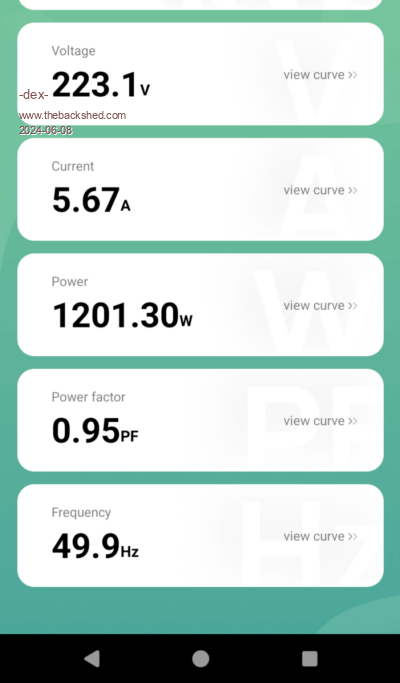

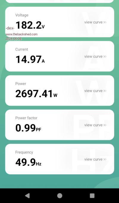

Finally, I managed to connect the target battery set: 16x 280Ah lifepo4. This time there was no fire
I will soon send some photos of how it was done
So far, I have tested everything on small loads, now I can go further.
Oops.. no I can't. It turns out that there is a problem with voltage collapse under load. It appears that the relationship load/voltage drop is linear.
Below is what I managed to catch on the meter in the application.
When the voltage drops this low, the inverter turns off.
Voltage regulation with a potentiometer on the controller board works properly, currently I have it set to 230V. No load/tiny load sits on ~ 230V. Small load small drop, large load large drop.
Currently the KeepIS code is loaded, but I also saw this problem with the Poida code earlier, it's probably not a problem with the code, but with my configuration.
I also know that in the case of KeepIS build the AC voltage is very stable.
There is a problem with my build, but I have no idea what is causing it. Do you have any suggestions?
One final note: measurements taken when all MPPT were off.

wiseguy
Joined: 21/06/2018
Posts: 1336
Posted: 10:14am 08 Jun 2024
I am sorry Dex you are in KeepIS's hands here I have no idea what the code is up to.
The only query I have is did you ground the Nano pin A7?  In the Poida code we had a similar issue but a dummy read of A7 between the Amps reading and the VFB feedback reading solved it.
The fact that KeepIS has an inverter that is very stable indicates that there must be a difference between his PCB and yours.
One way to prove the point easily is to disconnect the current sense transformer and then load it up to 15A again and check the AC voltage - I suspect it will be fine.  Don't leave the current sense unplugged like that but lets know the results of that test.
Edited 2024-06-08 20:17 by wiseguy

KeepIS
Joined: 13/10/2014
Posts: 2287
Posted: 10:28am 08 Jun 2024
You have a problem with voltage loss somewhere in the inverter or toroid, choke or filter wiring loss..
1: measure the voltage across the DC input terminals on the Inverter Power board.
The voltage under that size load should hardly drop, mine would see a voltage drop in the 100mv or less range.
2: Voltage loss across the chokes or toriod problem, but what we need to know first is the % of PWM in both cases, it should only change a few %.
That would mean either DC voltage is falling to the inverter or a toroid / choke problem, both could cause the inverter PWM to hit the max 99%.
I assume the info above is from a dedicated AC monitor. Even the $36.00 ones I use are surprisingly accurate.
The only other thing is something not right in the feedback circuit or the Toriod winding ratio is having trouble with some voltage drop and cant maintain regulation, again 99% PWM
This is just off the top of my head - and I'm tired, so I may be off base on a couple.
