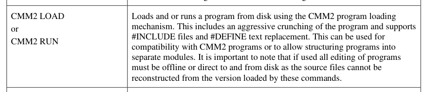

  Quote  PicoMiteHDMI USB 2350 V6.00.01 ...
That's not a PicoMiteVGA or a Game*Mite but I'm still interested in exploring what happens if you've got time to test; I don't have that hardware myself.
Try running using the command:
CMM2 RUN "robots.bas"
Edited 2025-01-28 06:05 by thwill

I didn't even know this command.
I went back to the study to test it
[1953] Select Case MM. Info(PS2)
Error: Syntax
Footnote added 2025-01-28 17:53 by homa
Looked it up in the manual this morning:
Your learning never stops!

That's happening because by default the version of the code on GitHub uses MM.INFO(PS2) to read the keyboard, there is a flag USE_PS2 that you can flip so it uses INKEY$ instead which would allow it to get further.
