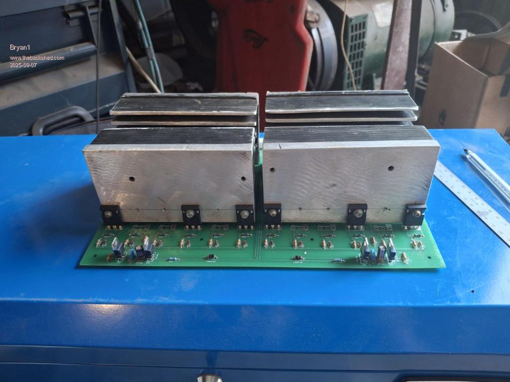

Anyway dusted all the cobwebs of the inverter board and the driver board and had jacked red back to contend with
Now as I do have the HY5608 fets I'm only going to 3 on each leg to start as if I do blow them it's only 12 fets gone to fet heaven.
Got all the passives soldered in and this morning put all the 5 watt resistors on ready to solder in.
Now with the fet spacing for the heatsinks it has been that long the grey matter has kicked in so if one does have that measurement  it could save me from doing it more than once due to incorrect spacing.

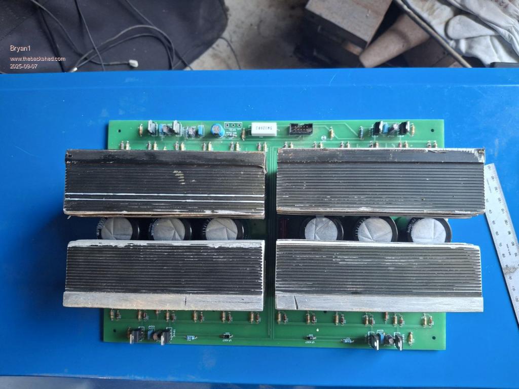

Well finally got the main board all finished   now silly me after drilling didn't take the heatsink off the mill and sure enough on the 11th hole broke a tap   O'well my 3mm taps have lasted well over 20 years   so from then on took the heatsink off and deburred it and got the rest of the holes tapped. On one heatsink the original mounting hole on the Aerosharp got in the way but eh there is no real need to use 6 HY5608 fets each rail.
I still need to make some brackets to clamp the heatsinks and it does say the low side has to be isolated but this black duck doesn't know what side that is   so once I do know I can join the heatsinks on the high side.

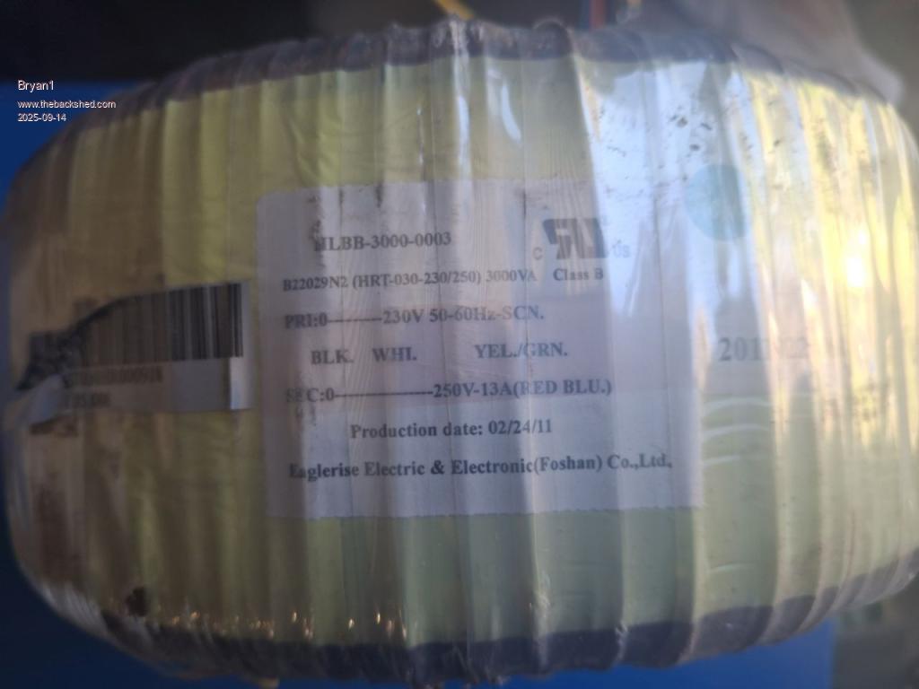

Well finally got those 2 aerosharps home and man are they heavy so tomorrows job is opening them up to look at all the goodies and get the toroids out. I reckon I will use one of the cases for this inverter project too as the case looks to have plenty of room to fit everything.
Edit: Well got the first toroid out
Now for a bit of cleanup and do the other one
Edited 2025-09-14 09:49 by Bryan1

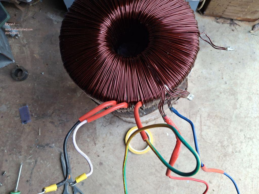

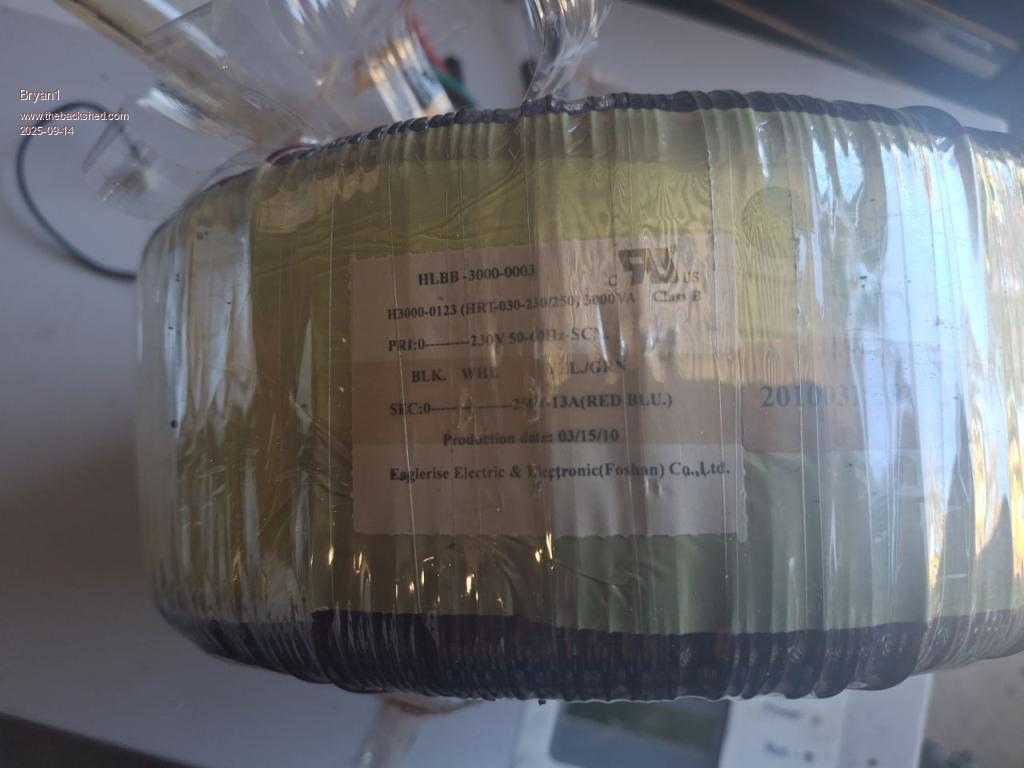

Well got the second toroid out and while stripping it I did notice it was different to the first one with the large choke being a potted one.
Now doing an ohm's check on both secondaries the difference betwwen them was 0.01 ohms where the first one was 0.26-0.27 ohms and the second 0.27-0.28 ohms
As one can see each grid tie has different build dates so I don't think it is worth the risk of stacking so just one toroid will be used.
Now once I do get this Madboard inverter finished and working the other toroid can go one one of Mike's inverter boards where I still need to get a heap of parts for that build.
Regards Bryan

It's a shame that the 250V windings are not the first winding on the cores, in any case I've started huge loads in testing with my own test aerosharp setup, using the 230v winding and 14 turn input winding, again, constant power level is only limited by the 230V winding size and how well you control the maximum core temperature under high constant loads. Of course if you decide to rewind from a bare core then you remove most of the limitations.
Very Nice cores

So now each member that has one of these toroids has the information.
Regards Bryan

G'Day Guy's,
           Well got all the insulation off the 2010 toroid to show the connections and it does look like it is wound 3 inhand.
So now the task of unwinding the 250 volt wire and will update pic's as I go.
Regards Bryan
Edit: Well so far unwound about 60 metres and the tummy bones are singing out stating feed me
So to be continued in the morning
