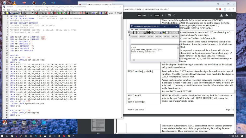

I tried running some code written in mmedit and click the running man and it saves and gives error messages which I've got to read data to array... it says - error array dimensions. I don't have a clue what's wrong.
Posted: 08:07pm 05 Aug 2022
cannon is not dimmed.
If you provide code with an error, please provide the line number of the error.
Edited 2022-08-06 06:09 by lizby

And why do you have the command DATA after the READ command? Not needed.

> RUN
[8] Read data,sp1(ptr)
Error : Array dimensions
OPTION BASE 0        ' 0 based arrays
OPTION DEFAULT NONE  ' Don't assume a type for variables
'OPTION EXPLICIT
OPTION DEFAULT INTEGER
dim sp1 integer (255)
for ptr=0 to 255
 read data,sp1(ptr)
next ptr
data wh,bl,bl,bl,bl,bk,bk,bk,bk,bk,bk,bl,bl,bl,bl,wh
data bk,bl,re,re,re,bl,bl,bk,bk,bl,bl,re,re,re,bl,bk
data bk,bk,bk,bl,re,wh,bl,bk,bk,bl,wh,re,bl,bk,bk,bk
data bk,bk,bk,bk,bl,wh,bl,bk,bk,bl,wh,bl,bk,bk,bk,bk
data bk,bk,bk,bk,bk,bl,bl,bk,bk,bl,bl,bk,bk,bk,bk,bk
data bk,bk,bk,bk,bk,bk,bk,bk,bk,bk,bk,bk,bk,bk,bk,bk
data bk,bk,bk,bk,ye,ye,ye,bk,bk,ye,ye,ye,bk,bk,bk,bk
data bk,bk,bk,ye,bk,bk,bk,bk,bk,bk,bk,bk,ye,bk,bk,bk
data bk,ye,ye,bk,bk,bk,bk,bk,bk,bk,bk,bk,bk,ye,ye,bk
data bk,ye,bk,bk,bk,bk,bk,bk,bk,bk,bk,bk,bk,bk,ye,bk
data ye,bk,bk,bk,bk,bk,bk,bk,bk,bk,bk,bk,bk,bk,bl,ye
data ye,bk,bk,bk,bk,bk,bk,bk,bk,bk,bk,bk,bk,bk,bk,ye
data bk,bk,ye,bk,bk,bk,bk,bk,bk,bk,bk,bk,bk,ye,bk,bk
not a clu and amazed mmeditworked, well seems to.. running man button to save and run.
Posted: 09:02pm 05 Aug 2022
sp1 is not an array. You've defined an array named "integer".
Posts: 12185
Posted: 09:04pm 05 Aug 2022
  Quote  dim sp1 integer (255)
Read the manual for DIM. This is meaningless.

Posted: 09:56pm 05 Aug 2022
for ptr=0 to 255
read sp1(ptr)
next ptr
you were reading two values on each pass, one into a variable called data and the second into the array.

Posted: 10:24pm 05 Aug 2022
It's not
READ DATA,...
but just
READ ...
Posted: 11:20pm 05 Aug 2022
If oyu insist on using MMEdit, use the help.
click in the READ word and "F1" for a short one line hint
Hold Shift while pressing F1 key and the full help for the READ command pops up.
The demo in that help should help.
