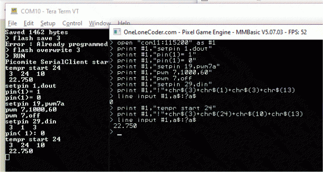

Posted: 11:46pm 27 Feb 2022
The addition of the EXECUTE command makes a Picomite serial client almost trivial. All regular basic I/O-related commands can simply be sent over serial and EXECUTEd. The only commands which need special handling are those which return values: DIN, AIN, CIN, FIN, PIN, TEMPR.
' serialClient.bas acts on serial messages
' if first character is "!", text data is to be returned, CR terminate
'   otherwise, single command is to be run with "EXECUTE"
OPTION AUTORUN ON
dim integer msg(3)
dim string cmd
pause 2000
print "Picomite SerialClient starting"
SetPin 22,21,com1 ' setpin 21,uart0tx:SetPin 22,uart0rx
open "com1:115200, 256, SerInt, 4" As #1 ' interrupt triggered with 4 characters
DO ' the program loops forever
WATCHDOG 2000 ' this will recover from errors
LOOP
SUB SerInt ' received a message
msg(0)=asc(input$(1,#1))
if chr$(msg(0)) <> "!" then
  pause 30 ' allow all characters in command to arrive
  line input #1,cmd
  cmd=chr$(msg(0))+cmd ' input$(255, #1)
  print cmd
  EXECUTE cmd
else ' function call will return data
  msg(0)=asc(input$(1,#1)): msg(1)=asc(input$(1,#1)): msg(2)=asc(input$(1,#1))
  print msg(0);" ";msg(1);" ";msg(2);" "
  if msg(0) = 3 then ' the command must be 3
    if msg(2) = 10 then ' DS18B20
'        s$ = mid$(str$(tempr(pin(msg(1)),3,3) + Space$(12),1,12) ' get the temperature
      s$ = str$(tempr(pin(msg(1))),3,3) ' get the input on the I/O pin

This is run from MMB4W.
Not implemented, but EXECUTE "GOSUB somewhere" would be very valuable.
For the commands which return a value, 3-byte sequences (plus CR) are sent (following Geoff's I2C protocol), but using only the binary 3 value for the first byte to indicate that a return value is expected. The pin number in binary form is the second byte, and the third byte is "don't care" except that for the DS18B20 the value must be 10. These 3-byte function-type commands are preceded by "!"--anything that does not have this lead character is sent straight to EXECUTE.
This simple program provides pretty good I/O for a PC running MMB4W or MMBasic DOS or a device running MMB4L. The code is easily expanded to provide more features as required.
Picomite on FruitOfTheShed
Edited 2022-02-28 13:21 by lizby

  PeterB said  Good morning Jim (and everybody else)
Thanks for your help.
My problem now is I2C is DATA & CLOCK while USB is D+ & D- so how does that work?
Peter
It doesn't. They are two entirely different things. :)
What lizby has done is modify the I2C code originally written by Geoff in the "Getting Started With the Micromite" manual. He's left the original code in but commented it out so that you can see what he's changed. I2C isn't actually used. For the  communication link lizby has used a COM port instead. This is, of course, just serial digital on the PicoMite so you need to connect it to a PC using a USB/TTL(3.3v) converter.

Posted: 07:42am 28 Feb 2022
Thanks Mick.
It's amazing what difference a ' makes and I'm sorry I'm a bit slow but we might still get there.
