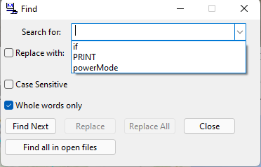

Find searches are now remembered between sessions.

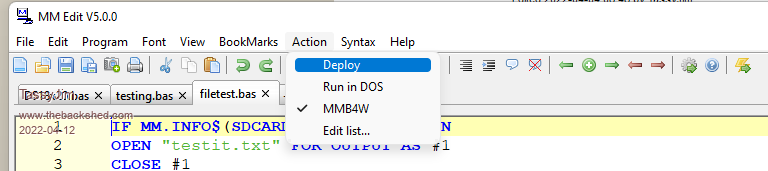

Hi there,
with the fresh version 2022/04/19
I do not see MMB4W option in Action menu.
Sorry, solved
Edited 2022-04-22 16:17 by Kabron
Posted: 06:17am 22 Apr 2022
  Kabron said  Hi there,
You have to add it.
MMEdit has no idea where you put the exe.
Kabron
Joined: 30/11/2017
Posts: 65
Posted: 06:20am 22 Apr 2022
I have to launch mmb4w via cmd file, containing mmbasic.exe 0.
How in this case to pass file argument to mmb4w?
Solved:
mmbasicw.exe 0 %1
Edited 2022-04-22 16:28 by Kabron

Remembering the file searches in Find is great, but out of interest, how do you clear the list?
Brian
