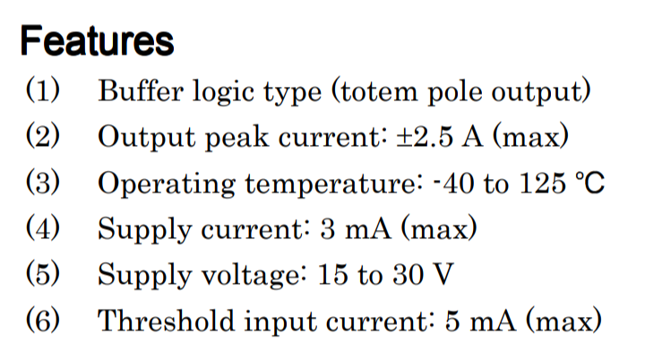

Just had a look at the data sheet. Interesting chip, but the output power dissipation is only 260mW. The output seems to drop about 2.5V (which seems high to me). If that's true then the *continuous* output current is only about 100mA, even though it can handle over 2A peak current. I couldn't see a continuous current rating anywhere on the data sheet. It's a nice driver but won't give the voltage to overcome Vgs in this case. It would be fun to try one but it might cook. :)

Refer to Note 2 in the spec sheet, these are not suitable for driving a large current for a long duration.

Check out the conditions for the 2.5A (note 2)
Note 2: Exponential waveform. Pulse width < 0.3 us, f < 15 kHz
If I'm not badly mistaken, both the TLP350H and VOM1271 are drivers not load switching devices. The VOM1271 may be able to drive Bob's MOSFETs but not drive the load directly. Beware, if you let the magic smoke out it won't go back in.

TLP350: those ratings are specified for driving a capacitive load with a very short duration, not for constant load. Its all in the spec sheet.
Note 2: Exponential waveform pulse width PW < 0.3uS, f < 15 kHz
Expected current pulse duration less than 300 nS
They will blow up running the led lights directly.

Posts: 3430
Posted: 04:22am 06 Aug 2021
" Its all in the spec sheet."
Yes, that goes for all semiconductors. The Max. ratings are Not the working ratings.
