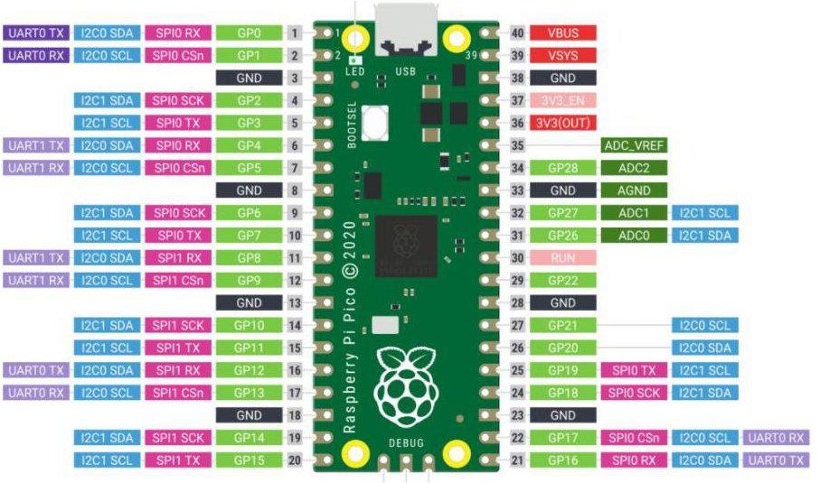

Posted: 10:39pm 06 Sep 2021
This 6-digit HC595-driven module would probably not be too hard to control.
Do you have this pinout image:
You do have to do some work with the picomite to figure out which pins to use, which will depend on whether you roll your own or use one of the PCBs available.

It would also be easy to use a MCP23017 I2C port expander to directly drive 7-segment LEDs. One of the PCBs linked on the FruitOfTheShed page provides for a MCP23017.
