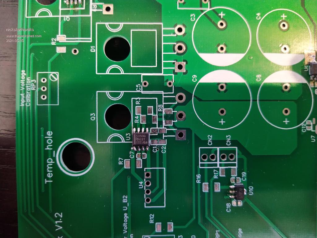

Nicks: I reworked the picoverter PCB in accordance with your guidelines.
It made it a lot easier as things got more complex.
Also I think the board looks far less messy.
0.3mm tracks is more sensible too.

PCB coming along well. Had a quick look at your schematic. I think Nano Pin 11 should go to pin 2 of the on off header. I think there is a 1u missing from pin 3 of the LM358. I haven't studied it for all errors though. I see you have found the ground plane function - aren't they great !

When I learnt PCB design, you either got a colleague to check your work or you get the PCB back with faults that annoy the crap out of you. With the cost & cycle time that we used to incur it taught you rather quickly to check and recheck. Then I started with a commercial company with deeper pockets, the engineering manager had a mantra of "if you got the PCB back with no errors you spent too much bloody time checking it". He believed there was always going to be something wrong or an unforeseen issue, or an addition of something to make it better, so get your prototype back fast get the bugs etc out of it and then send out a more serious version with most/all bugs ironed out.
Today, cycle times and cost are quite minor so the penalty for a mistake is relatively small. I cant see any drastic issues with the PCB or the schematic. You have a generous number of vias and track side changes that a lot could easily be eliminated but it is probably my old school thinking and of minor consequence.
What I would try to fix is the tracks that do not enter the component pad at right angles. The creation of sharp angles (less than 90) should be avoided if possible. I'm not familiar with EDA but usually when you set up a snap grid of 25mil and use "hotspot" connect, these off centre exits shouldn't occur ? I was always taught to not use 90 degree changes of direction when running tracks, and use slanting lines (like you have in some areas) again probably old school thinking.
Other than that it looks good to go.

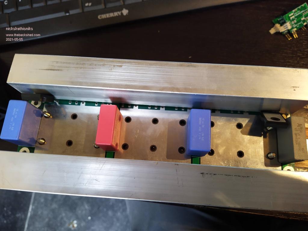

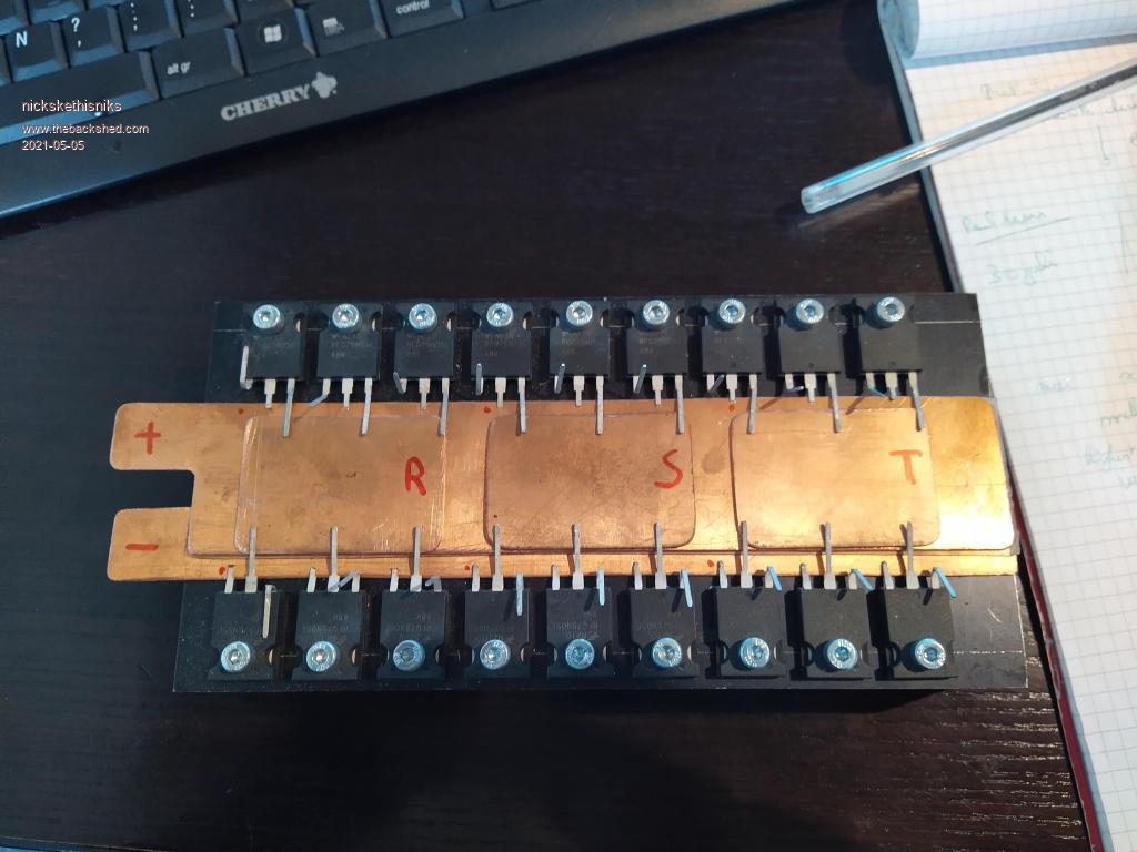

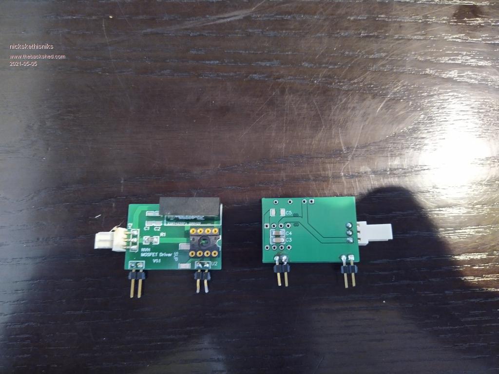

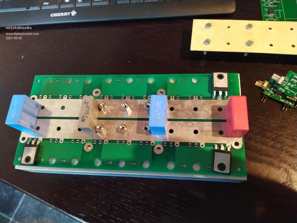

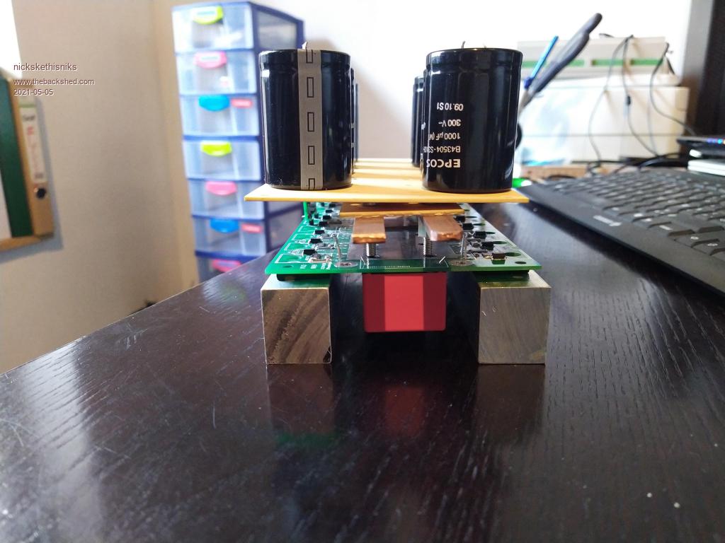

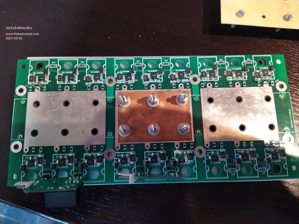

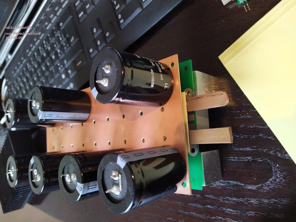

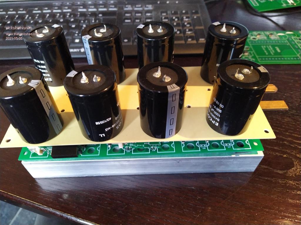

First were some designs I was playing with for a laminated busbar, caps with the right dimension could be placed under the busbar, if the mosfets were placed on an aluminium bar to allow space, like in a design further in this message. The copper could be glued with some solar eva foil, possible creepage issues when voltage to high. You can see a layer of EVA between the + and - plate. Not yet under the AC copper plate. Electrolytics could be placed on the input, compensating the wire between the battery and inverter, the pp should only be there to compensate the pcb inductance?
It's also possible with pcb material.

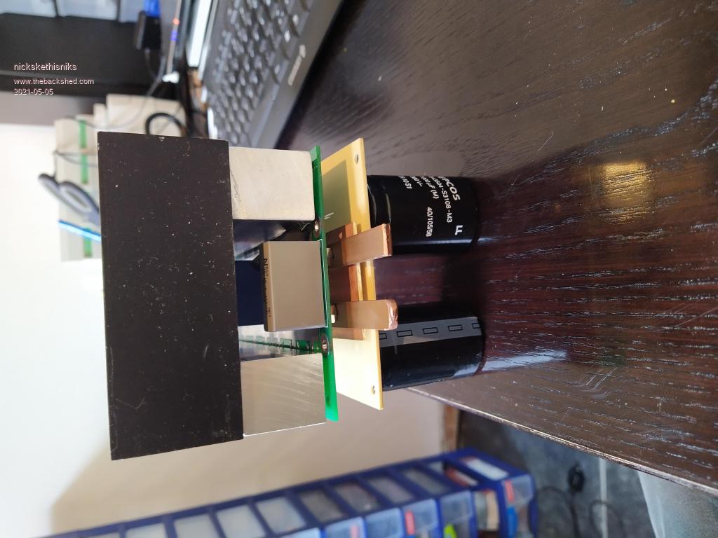

Then I wanted to make a pcb, but I made the mechanical part somewhat complex, if I just had swapped the AC side with the batteryside, it would've been so much easier.

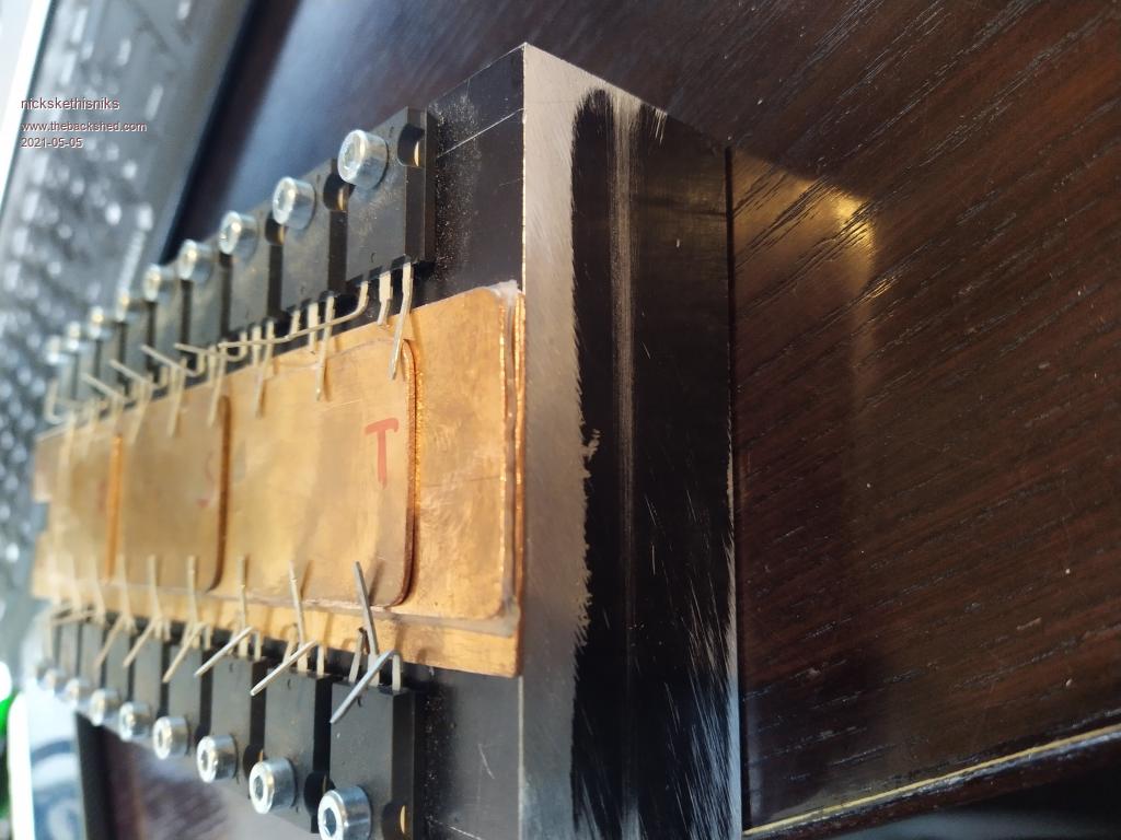

I would like to develop a version with mosfets on the other side of the board. It's already some time ago but here are some examples I was (wanted) playing with. So in the meantime there are things to improve. I'm still searching, maybe we can find something togheter.
The same board but the fets on top:

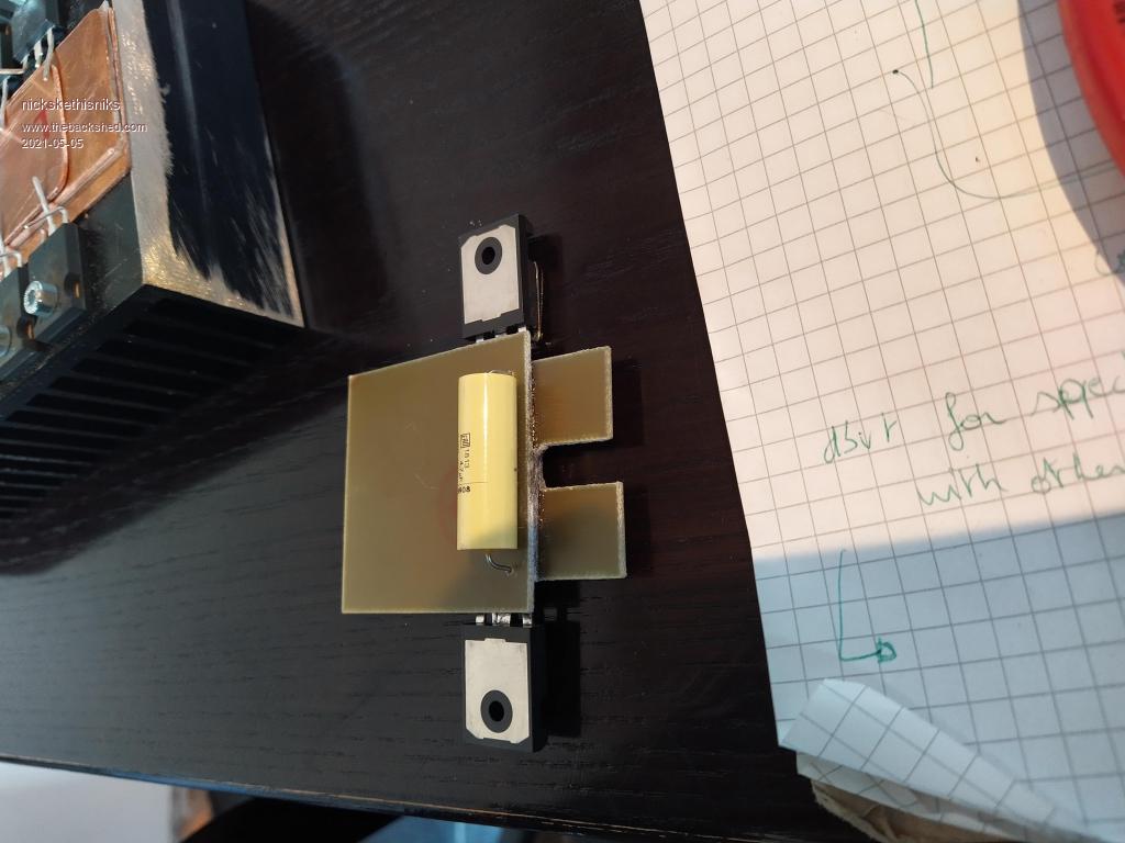

This was the little driverboard: maybe that ground plane is not necessary, a separate driver board gives some space on the board itself, placed under 90degree with the power tracks should make it more immune against noise. And makes experimenting easy.
You can easily fit an totem pole drive on such a pcb.
Peter this is maybe how you could place the mosfetdriver, I could've used smaller resistors.

nickskethisniks
Joined: 17/10/2017
Location: Belgium
Posts: 499
Posted: 08:58pm 04 May 2021
Maybe we better start a new thread? Peter I don't want to pollute your thread or is it allright?
Sorry I am cherry picking, you are right, I knew I was on slippery ice when I was looking at your design thru a magnifier. Next time I will change my tone by asking you why you made certain decisions instead of making assumptions, sorry, I must have overlooked it in your building thread.  I was trying to examine your pcb layout based on the things I've read and learned so far. That way learning the do's and don'ts, ok, you however, you have the ability to bent the theoretical rules on a clever way by using a disadvantage, for instance the internal resistance deviation, in your favor.
I'm in the stage to interpret the theoretical rules and trying to implement them, I know practice turns out differently because of compromises you need to make. Today I learned something new, I don't have the experience you have, I'm building my knowledge and making my notes. But for starting it's good practice to start with a symmetric layout. I also know there are other aspects that contribute to the current sharing, temperature for instance will probably work in our favour.

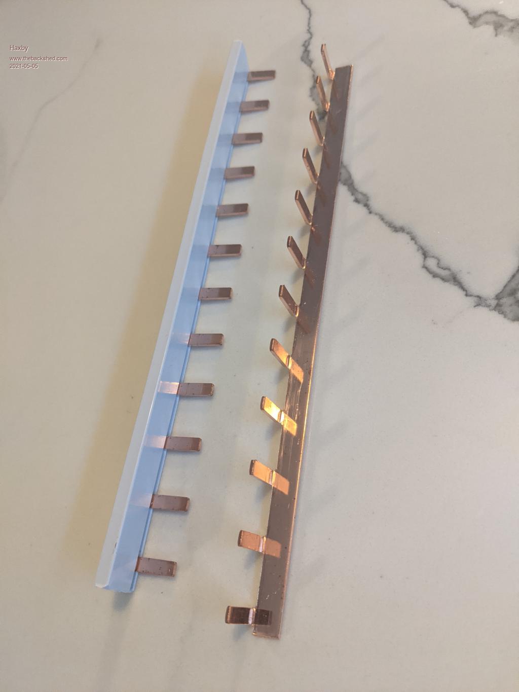

Haxby
Joined: 07/07/2008
Posts: 427
Posted: 09:53pm 04 May 2021
Good to see lots of people tackling the same problems in different ways. And it's good to see higher power automotive designs where all the nuances are amplified.
The Chinese boards use a piece of copper dipped in solder to create a PCB based bus bar. I tried that approach on my boards but wasn't very happy with it. Looks messy.
I like your stacked busbar design nickskethisniks.
If we design a board for other members to recreate, maybe basing the busbars on easy to get materials could be a focus.
I picked up some bus bars that are commonly available world-wide in the electrical trade.
These copper pre-cut and bent bars are marketed to connect multiples of single DIN rail modules (breakers) together quickly instead of wires.
They are rated at 63A for that purpose.
I'm contemplating a redesign of my power board to use these busbars and maybe others here could consider them to fortify their high current PCB tracks.

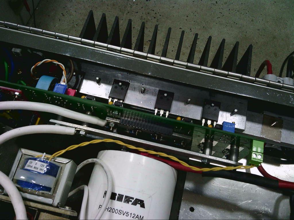

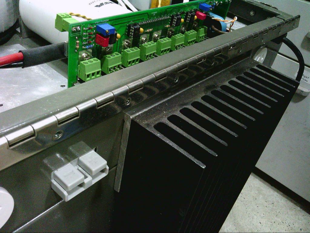

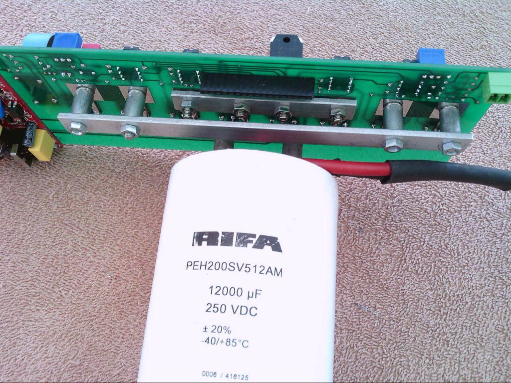

Posted: 12:00pm 08 May 2021

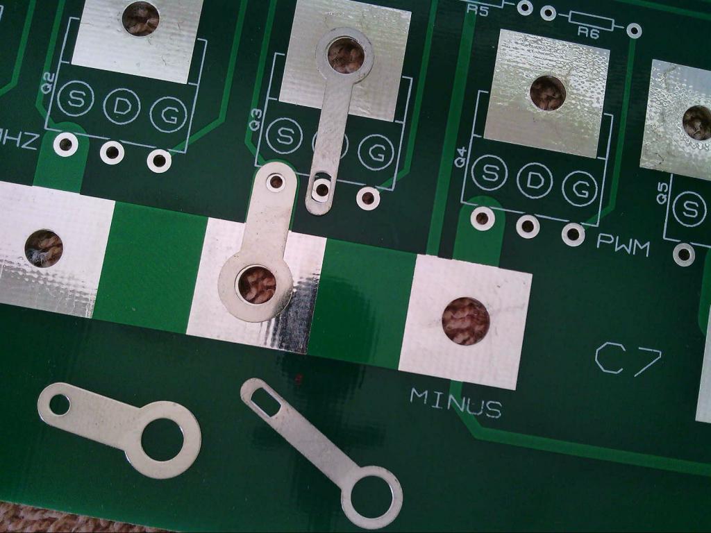

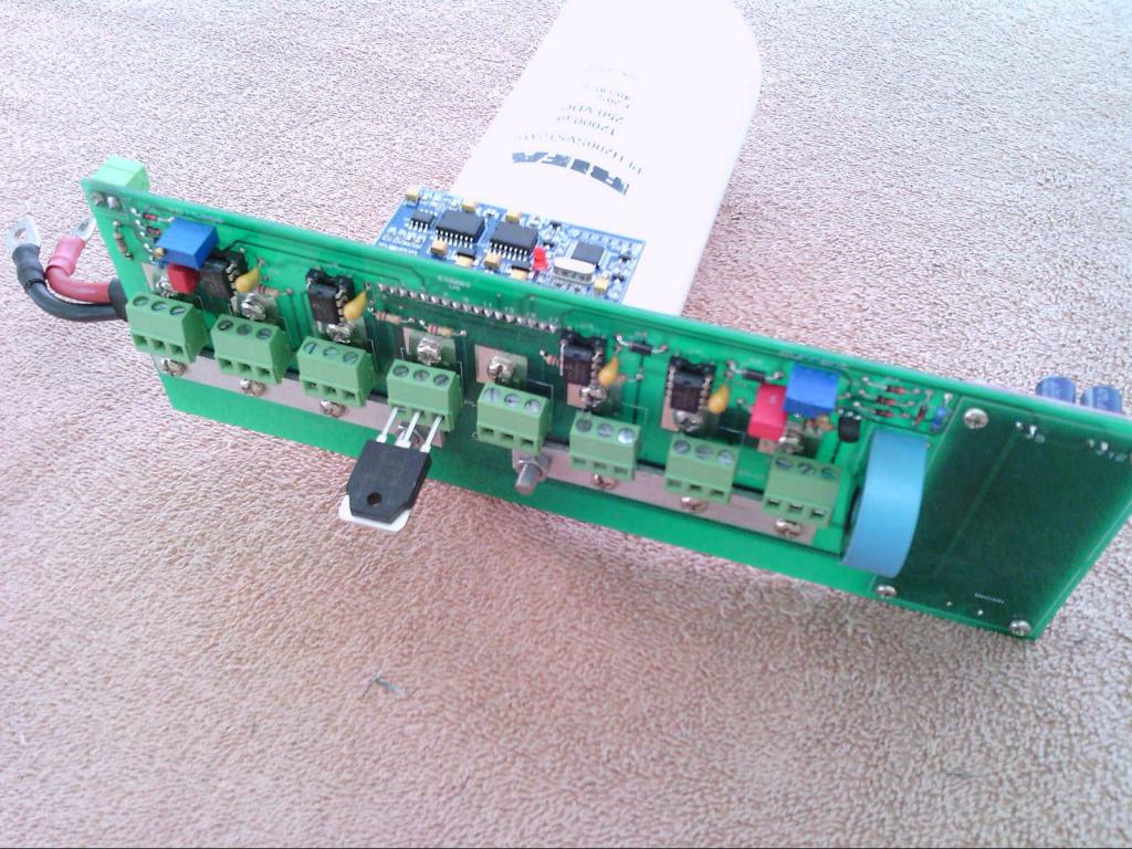

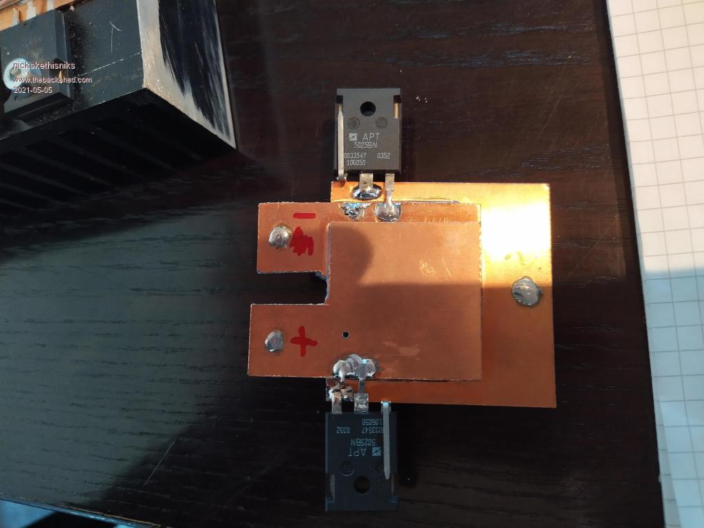

While we are kicking around a few ideas for hardware layout, this is the very last PWM inverter I built, just over three years ago.
Its now become a pretty dated design, in that it uses an old EGS board, but this was just a design exercise to try out a few different mechanical and thermal construction ideas.
It also uses four ten amp gate driver chips mounted up fairly close to each pair of mosfets. Each chip has short direct gate connections to each pair of mosfets in an attempt to get cleaner more direct gate drive signals as discussed in this thread.
It also bears a slight resemblance to Nicks laminated busbar idea. Not quite so neat, but it uses busbars bolted to the circuit board  to carry the heavy current.
This is the dc side with +ve and -ve busbars and the single low esr electrolytic.
The ac side busbars cross over.
Its only a one ounce board, but source and drain connections are reinforced with solder lugs, so that if it ever blows up the pcb tracks are just about indestructible
Installed in a metal enclosure with still only half the mosfets installed. The mosfets are inside, but the heatsink is outside the enclosure.
A large piece of 6mm thick L section conducts the heat to the outside heatsink. That seemed to work quite well.
I don't know if any of this is of any interest to anyone, or even relevant, but I thought it might spur a few ideas.

Looks very professional, how well did those drivers (TC4452 comes to mind) work driving two mosfets.
Mike
Posted: 10:51pm 08 May 2021
Its not something I spent a lot of time looking at, but the gate waveforms looked fine from what I can remember.  Sorry, but I never recorded a picture of that.
