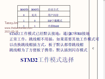

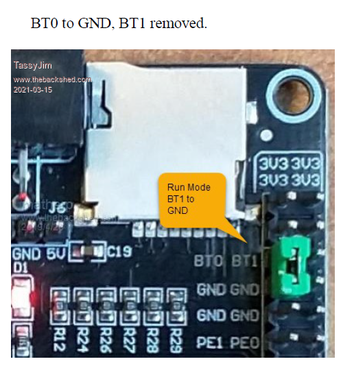

I went through my small collection of F407 boards.
The ones with STM32F4VE and Ver: 2.1 on the back work as expected with one jumper required for flashing and all jumpers removed for normal use.
I do have one board that has STM32F4XX and V2.0 on the back.
It does definitely have a STM32F407VET6 processor.
On that board, I have to have the two jumpers in place for flashing and the BT0 to ground jumper in place for normal use.
In other words, that board does NOT have the pulldown resistors shown in the circuit diagram and mentioned in the manual.

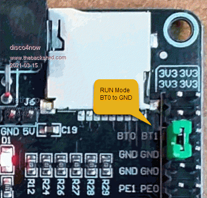

If you are having trouble getting the serial to work once flashed, try with a jumper from BT0 to GND
I don't have any jumper on BT1
The text on the photo (taken from the manual) is incorrect. It should read BT0 to Ground
disco4now
Joined: 18/12/2014
Posts: 1162
Posted: 10:59am 15 Mar 2021
Fixed next release.

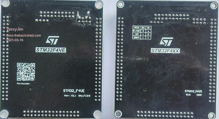

Posted: 12:17am 16 Mar 2021
This is the rear of my two versions.
The V2 board one requires the jumpers in place for firmware programming and also normal running.
I measured the resistors and that ARE in place and the correct values. Something makes the jumper to ground required on that board.
Note that the jumper settings on the silk screen differ from the jumper settings in the circuit diagram supplied here.
I believe that the circuit diagram supplied here is wrong.
I have a Chinese version of the circuit:
I have some more units on order. It will be interesting to see what revision board they use.
If your V2.3 board doesn't work with the jumpers set as per the images in the manual, I don't know what else to suggest.
Having the jumpers on will not cause any problems on the 'good' boards.
While BT1 shouldn't need a jumper for normal running, I would try both positions.

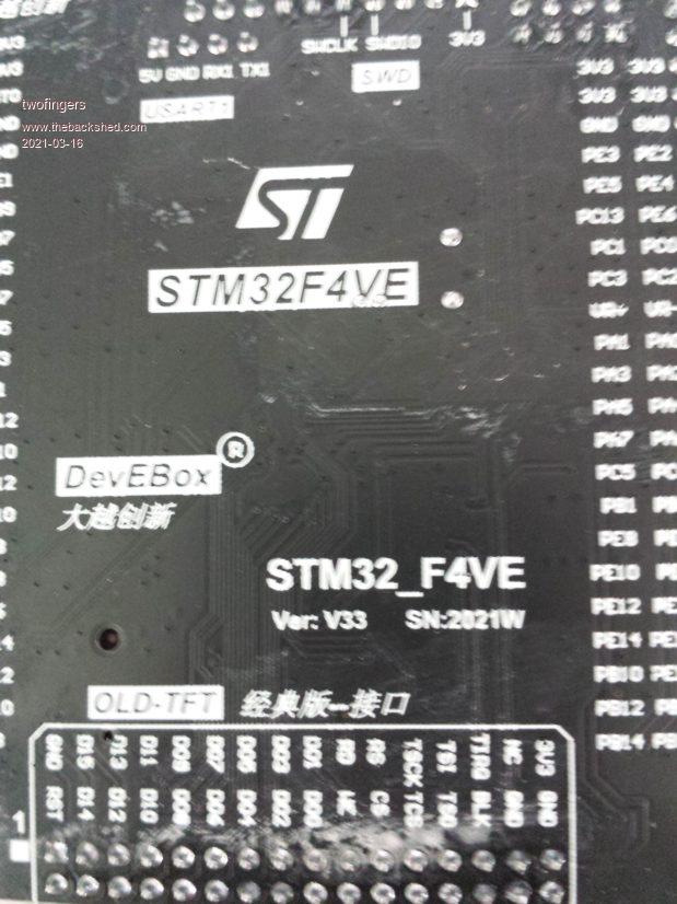

My board (STM32_F4VE Ver: V33  SN: 1911Z) reads some cards and not others. Even for cards it can read odd things happen. Eg the FILES command lists up to "Press any key to continue" then locks up, but only when OPTION LCDPANEL CONSOLE enabled.
TassyJim's photo a few posts up shows 6 10k pullups connected to the SD card socket. R12, 24, 26, 27, 28, 29.
My board doesn't have them, nor pads to fit them, relying on weak pullups in the chip. I think that could result in slow rise times and/or crosstalk between PCB tracks.
I will order some SMD resistors an try fitting them directly to the SD socket pads.
If anyone with SD problems and resistors on hand could also try it and let us know what happens.
Pins 1, 2, 3, 5, 7, 8 use pullups.
EDIT
Salvaged an 8.2k X 8 SIL package from a dead motherboard and connected it to the SD socket and +3.3V and now all SD cards work error free.
The schematic PDF for the board shows pullups all over the place that my board does not have. If any one has issues with any hardware compare your board to the schematic, it could save a lot of head scratching. Cost cutting gone too far I think.
Edited 2021-03-16 17:01 by phil99

  phil99 said  Re SD Card issues.
Thanks Phil, good to know. Same issues here (with V33) ...

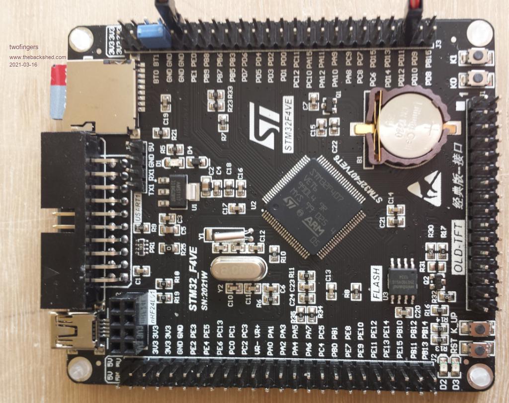

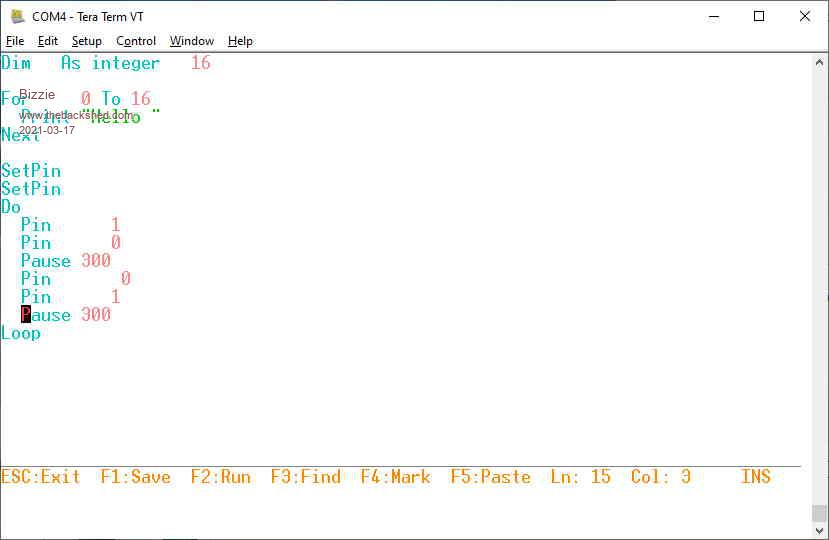

I took delivery of an F4 (STM32_F4VE) today Ver: V33 SN:2021W, loaded it with the bin above put a Transcend micro 2GB card in and files worked straight off. I do not have any other cards to try at this stage.
A problem with the editor in colour mode though. See below
I am using Tera Term so assume all should be OK.
