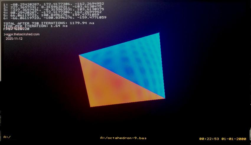

Posted: 02:56am 12 Nov 2020
Thank you lizby
This is my best time until now: 1179.94 ms
Adjusted time (x 1.18): 1392.32 ms
Firmware RC17
480MHz CMM2

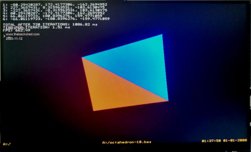

Posted: 04:15am 12 Nov 2020
Ok, I believe this will be my final version, I cannot see any new optimization, the code is very small, 64 lines only.
Total time: 1086.82 ms
Adjusted time (x 1.18): 1282.44 ms
Firmware RC17
480MHz CMM2

  LeoNicolas said  Ok, I believe this will be my final version, I cannot see any new optimization, the code is very small, 64 lines only.
Fantastic. I cannot get mine below 1287ms (1518ms adjusted). I can't see any further optimisation I can do. (480mhz). Mines is 147 lines of code, but I could probably get it down to 100 by removing comments and stacking lines. My actual loop only has 20 lines of code in it. That's 99% of my time, and I'm not sure what else I can do to refine it.
