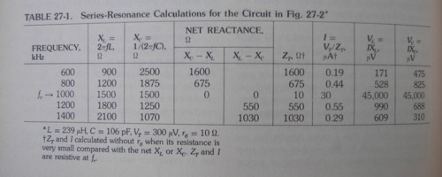

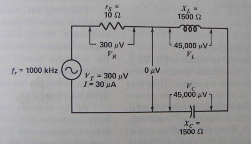

To put some perspective on cap voltage at resonance.
reference circuit.
values at Fq.
text excerpt.
Cheers Gill _Cairns, FNQ
