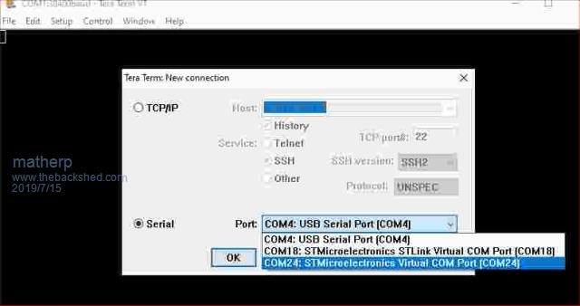

The code uses the standard STM supplied libraries and I can promise it works fine. What version of Windows are you using? STM provide a driver for versions other than W10 which doesn't need one.
Given that you programmed the board (presumably over USB?) we know the clocks etc are fine and the wiring is OK on your board.

Posted: 06:02pm 15 Jul 2019
Serial port I get USB\VID_0483&PID_5740
DFU bootloader device I get USB\VID_0483&PID_DF11
Always worth trying a different USB port for the different modes of use.
Are you using a laptop? USB power issue?
Edited by matherp 2019-07-17
