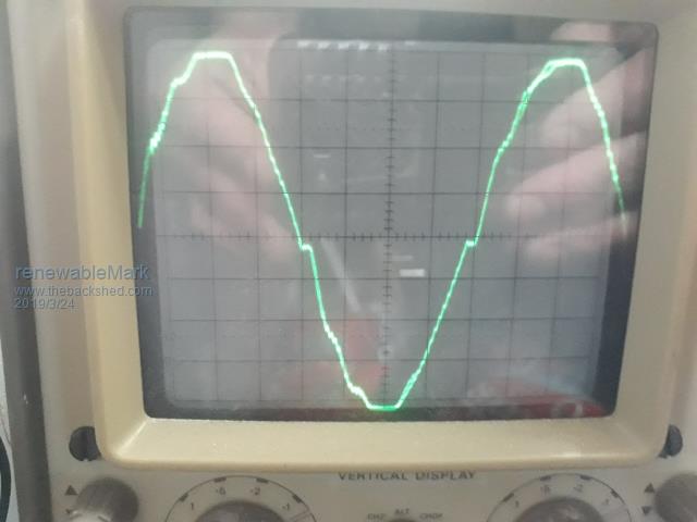

Mark, apart from the waveform, does the inverter sound happy enough and the air-cond functions ok?
I've been running a 3.5k Mitsubishi inverter air cond off a Latrontics for years, I've never looked at the output though
cheers
Andrew

Yeah it does Mack, you wouldn't know unless you looked at the wave on the scope.
It does look horrible though.
That worried me.
Just had the oven on for 1.5hrs, the torroid heated up to 35c, fans kicked on.
Sine is perfectly smooth as you could want on every other load.Edited by renewableMark 2019-03-24

Posted: 09:05am 23 Mar 2019
Update,
still running house nicely.
Perfect wave, fan control works well, kicks in and out at setpoints.
No flickering of lights.
Only problem is the inverter air con.
Cheers Caveman Mark
Off grid eastern Melb

It could be that All inverters would give the same waveform loaded by that Air Cond.

what temperatures are the heat sink and the toroid running at?
I also wonder about the current draw of the aircon.
Since it's an inverter, maybe it has a primary DC bus supply that is
using a switch to suck current at short intervals, about 9 times
each 50Hz waveform. The period or duration it draws current is variable, depending on
how much power it needs. A switch mode power supply as it were.
I'll bet the aircon draws huge amps, 9 times each 50 Hz but not for a long duration.
(Mark, if the aircon supply is via a 10 or 15A plug, I could come over with the
mains current and voltage sense box, and we feed these signals into the CRO.
We would see how the aircon current varies with time. I expect 9 big pulses each 50Hz)
This switchmode DC primary supply might also have some power factor correction
stuff going on.
Anybody got a schematic for this or similar aircon?

Poida,
I set the nano to turn on at 35c and go off at 28c.
This is very low but I wanted it to trip so it could be checked for operation.
Had the Ac on basically all day, then the oven was on for 1.5 hours.
Heatsink and torroid didn't go past the 35c, the fans kept them within range.
BTW when the air con is on full fan/power setting the wave just has a small blip at the crossover, it only turns the wave to crap when it's on a lower than full fan setting 1-4, on 5 it's fine.
But of course. someone just has to keep turning the bloody thing down don't they.
Explain it 50 times that it upsets the machine, turn it back up, go out to garage to monitor then WHAM crap wave starts again.
Go back inside, and well, what do you know the air con turned itself down again!!!
Must have been a fairy?

Had another idea, as this has sync, I could finish off the second nanoverter or build a warp/cascade inverter to sync to.
Maybe the extra grunt of two machines running would dampen the effect.

Well well, tried eco mode on the air con, that has a lower fan output setting.
Wave is still crap, but probably clean enough not to cause too much of a worry.

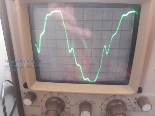

And here we have the wave while a microwave is running.
Looks like someone is building a Warpinverter next.
I never thought to check the wave with different things running, when you do you see how horrible they perform.
I should be able to get a second nanoverter built fairly quickly and sync the two together, heatsinks and second torroid are ready, but waiting for ferrite beads to fit on the fet gate legs to assemble another board.
A Warpinverter will be a while off.Edited by renewableMark 2019-03-26

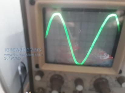

And the dryer, a big but gentle load on the machine.
There are also various plugpacks through the house charging various crap, but the big double stacked torroid with 4 secondaries of 128 turns doesn't seem to be worried about that.
Cheers Caveman Mark

Just out of curiosity I looked at the little oscilloscope on my inverter output while the microwave oven was running.
I see the exact same waveform, shown above, when the microwave cycles on. The inverter growls a fair bit too then.
But it runs, no bang, no smoke.
Then I tried that with the small split A/C on, the sine wave did not noticeable change from the usual nice output wave.
Ditto when I turned on the induction cooker (at 1KW) - no difference to sine wave.
Just live with it Mark - it works .
