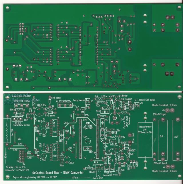

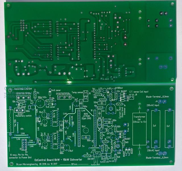

Gaspo, wiseguy,
For clarity, and for others following this thread but may not fully understand. Regards whats on the 8010 sub board pin out, here is the OzControl board rev12bb.
This board originates from Oztules original simple design layout 2015/16 period. Since then there may be changes around the peripheries of the board, but the 8010 sub board pin out has not really changed.
I believe there are a couple of hundred boards out there with this pin layout.
For clarity...... (Photos are limited to 1.5m)
Edited by Clockmanfr 2018-09-25

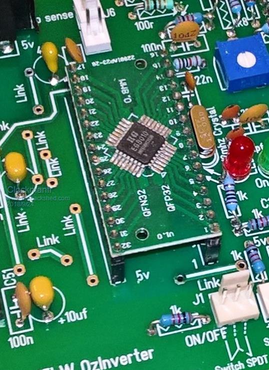

  wiseguy said   Not trying to be argumentive Gaspo but did I miss something ? As it stood with pins 10 & 11 unused, if the crystal is fitted & used on the adaptor board there is no modification to the control board. If the adaptor board has no crystal or capacitors fitted & pins 10 & 11 are linked there is still no modification to the control board ? What modifications were you referring to that could otherwise be necessary for the control board ?
Wiseguy, what I intend to do was not put permanent tracks from pins 10,11 on 8010 to connectors but to place jumper pads on the board. So instead of soldering wire links from 8010 pins to connector one would just solder jumper pads together with a drop of tin. A lot simpler then to mess around with soldering tiny wires.

Gaspo I was responding to what you wrote which was:
Tinker, I should be able to connect tracks from the crystal pins on the 8010 to the corresponding connector pins.
This sounded permanent, If it is now planned to be done with solder pads and not a permanent link I think it is a good solution - keep up the good work!

Wiseguy, yes the jumper pads will be used, sorry for the confusion.
