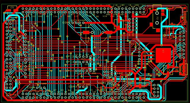

Daughter board ideas.
Grouped connections for SPI, I2C & COM ports, power as well. This way it's easier to add other types of serial boards and SPI devices.
For power maybe 2 rows of 10 pads, ground and 3v3.
Or/and add extra 35x2 connector pads, top and bottom, labeled for ad-hock wire connections. Or all the other pins that aren't SPI, I2C or Com?
A free pad area square for miscellaneous parts. Group by 2 pads with a route in between. Example:
O-OO-O
O-OO-O
O-OO-O
O-OO-O

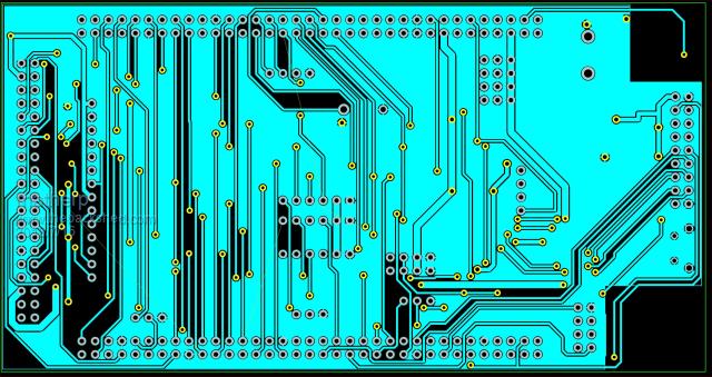

Posted: 04:03pm 15 Jul 2018
I've tried to incorporate the various suggestions for a daughter board. Here is the routed version and a view of the bottom showing the ground plane fill

but a special thanks to Peter and Geoff, I already have a maximite tft and micromite extreme, simply fantastic.
Regarding the pcb I wanted to ask if you expected the fixing on the back of the tft (in this case dimensions and fixing holes).
If then this display was a 7'' maybe there may be space for other connectors (nunchuck, mikroe etc ..) always that we can and that reflects the concept of this card.

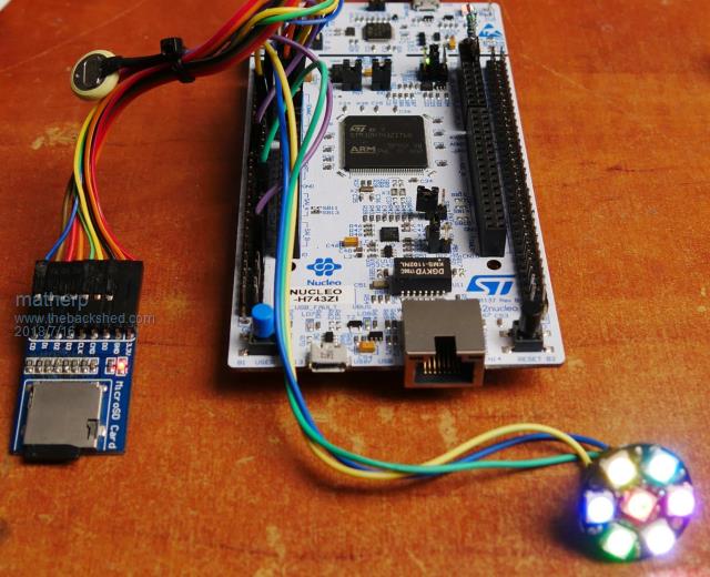

If you still have an LCD panel set up please could you test the various drivers with the attached and let me know the results
2018-07-16_222031_Armmite.zip
This version also includes a new command
WS2812 pinno, array_of_colours%()
This sends the correct pulses to light WS2812 leds. The array should be of the exact length of the number of LEDs. The pin needs to be set as an output.
So my test program for 7 LEDs is
Option explicit
option default NONE
dim b%(6)=(rgb(red), rgb(green), rgb(blue), rgb(Yellow), rgb(cyan), rgb(magenta), rgb(white))
setpin 1,dout
ws2812 1,b%()
Edited by matherp 2018-07-18
