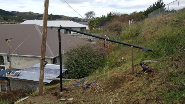

Got the mast pole, cut it in half, added a hinge arrangement and a lock. Fabricated the motor mount, and the mount for the drive cog.
Over the weekend we got the mast pole base concreted, pole is removable, hinged 2.5m above the ground, and then about 3.2m above the hinge. Pole goes into the ground just under a meter. It's a 76mm OD medium wall black pipe, about 3.6mm thick or so.
Got the guy wire supports in the ground.
Installed the 3 12mm eyelets into the pole for the guy wires.
Devised the winch system to raise and lower the mast today, that works well.
Measured all the lengths for the wire rope for the supports after getting the mast fully raised up, so will get those bits ordered tomorrow. Will be using 6mm galv wire rope, turnbuckles, wire gips, etc. Should work out well.
All going pretty well really.

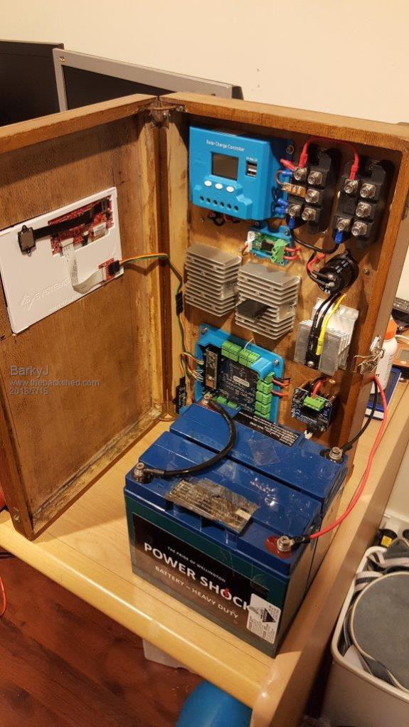

Been building the more final controller, which is taking shape, few more bits to add to it plus more testing to do, more code to write, but going well.

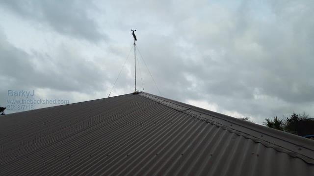

Got the wind vein and speed sensor installed on top of the control shed, a stone throw from the windmill itself, along with 20W of solar to keep the controller's batteries charged during the day.
Few progress pictures.

Only issue I can see that might cause problems is having the sensors on the shed- you have a bit of a hill behind you by the look and surrounding houses etc, the wind at the shed level might not be anything like the wind at the genny- I would think having the sensors near the top of the mast might be less of an issue
Been ages since I played with wind gennys, but anything nearby (trees/houses/hills etc) can cause turbulent air flow around them
I know a genny system on a yacht to provide power when moored, they had one at the top of the mast, one at the bow and one at the stern, all three often ran at different speeds and different directions- sometimes facing opposite each other- all this with a length of 45 ft between them max and a height difference of about 80ft...

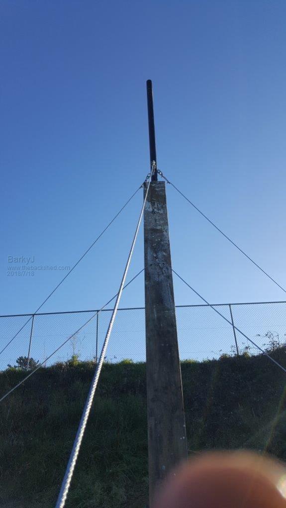

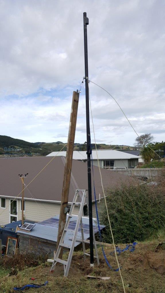

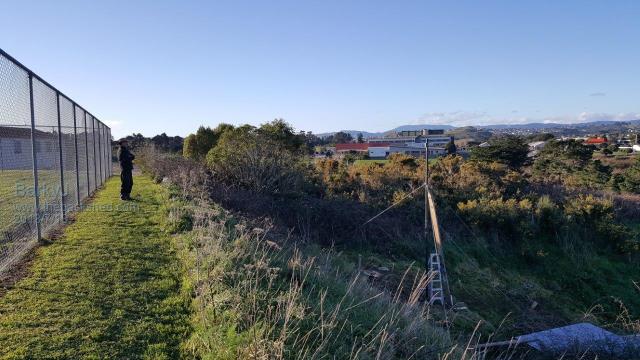

Posted: 06:42am 18 Jul 2018
Boppa - you were quite correct, the shed turned out to be a flop in terms of location for the sensors. So today I rebuilt the mast and put it up on the house roof, which clears the hill now. And now I have a northerly and its nice and stable.
Got it up just before dark.

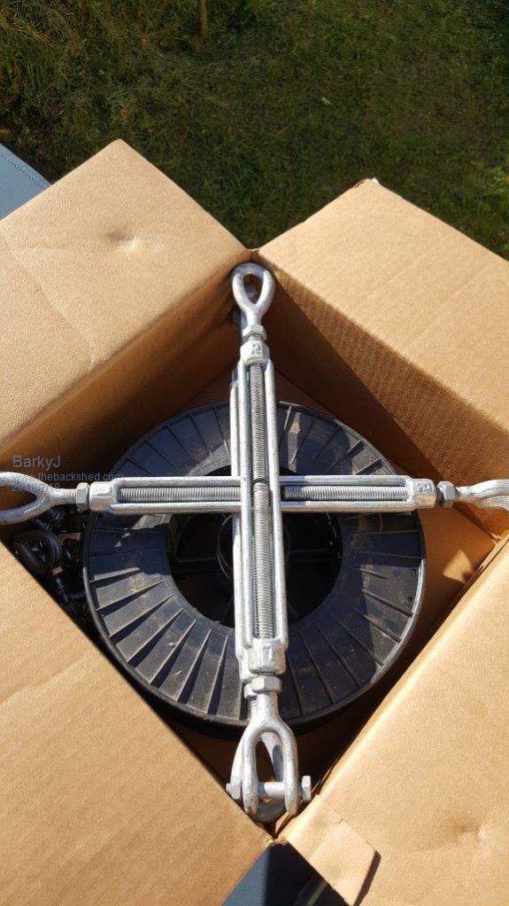

Got a box of presents today too, so got those installed (I should have been working...), but now the windmill is secured with 6mm steel cables.
Lifting plank is still in the pictures, that will be lowered down and removed obviously.
Pictures likely come out too small on the forum, hopefully they are still visible.
Making progress :)

So the hill where Dad is standing in the last picture is about level with the rope eyes securing the mast. So there is about 1.6m above those to the top of the pole, so 100mm or so to the centre of the blades, and then 1.4m to the top of the tip of the blades. So it should work out well. Quite a difference in air when standing up on the hill, compared to down by the shed.
Time now to focus on the Turret again, get that rebuilt after painting it, get it installed with the motor, and then onto the blades.... gulp.

Its certainly a fairly difficult site, but it may not be all that bad.
The wind coming over from the sports ground may be a bit turbulent, but if there is enough wind, it should work fine.
In the other direction, steeply rising ground is actually quite good.
I have never built a wind turbine system myself, and live in the yuppie suburbs so never will.
But a long time ago I worked for the Victorian Solar Energy Council, and was part of the team responsible for planning and monitoring some government funded wind turbine sites, so this project is of great interest.
Boppa is spot on about monitoring at a position as nearly identical to the final turbine position as possibleEdited by Warpspeed 2018-07-19
