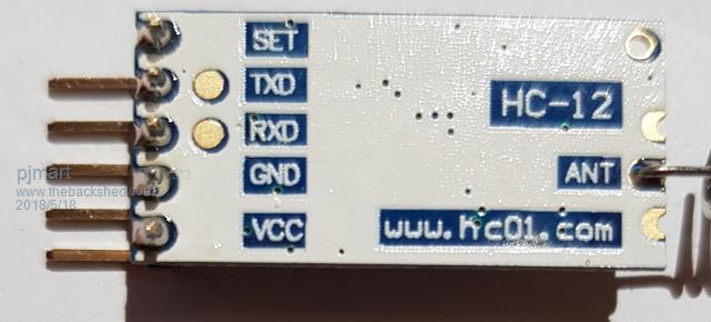

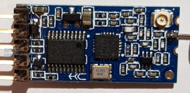

Some further information.
I purchased 3x HC-12's back in 2016 which meet the criteria as original(T300 crystals, heavy white silkscreen on the back).
Earlier this year I purchased 3x more from a different source only to find they will not communicate with the older ones but work quite happily with their own batch as previously reported by Grogs and others. The silkscreen on the back is quite thin and the crystals are marked 30.000MHZ so I assume they are clones. I don't have any other means of checking frequency.
Just after this discussion started I purchased another 3 as replacements, doing as much checking as possible beforehand and they arrived today. On inspection they all have metal encased crystals marked as 30.000MHZ but the back silkscreen is very thick as per my originals. I have now tested all 3 and all talk perfectly with the originals but not with what I think are clones.
This now suggests that the T300 marking on the crystal is not an absolute go/no go criteria although the heavy silkscreen coating is.
The latest batch was purchased on Ebay (Seller: colortop9).
I have just received replacement T300 crystals from Element14 (thanks Grogs) and will try upgrading the clones in the next few days.
Posts: 10116
Posted: 10:53pm 17 May 2018
Welcome to the forums.
That's interesting, and the first report of a 30.000MHZ marked crystal actually resulting in correct operation. I got the impression that the genuine ones all were marked as T300, as also backed up by the info Boppa has got out of hc01.com
However, it is still useful information to have, so thanks for posting.
Can you please look on your ones marked with 30.000MHZ and the thick silkscreen, and see if the Vcc pad is square on the top, but ROUND on the bottom? Genuine seems to do it this way, clones have a square pad top and bottom for Vcc - as well as the thin silkscreen.
As the RF chip can be tweaked to suit the crystal in use, hc01.com COULD still use the out-of-spec crystals, provided they tweaked the registers in the RF chip. They may have done just that. The cloners will not have, which is why a direct copy of the original does not work correctly with the out-of-spec crystals the cloners used.
Base on your post, I will stop paying as much attention to the crystal from now on, and just concentrate on the thick white silkscreen as being more likely genuine, and if you have a milky see-through silkscreen, they are likely clones.
pjmart
Joined: 13/11/2016
Posts: 9
Posted: 03:09am 18 May 2018
The Vcc pads are certainly rounded on the underside and the topside is now obscured by the header. I did look before attaching the header and think that the top pad was rounded although cannot be 100% sure.
Have attached photos.
