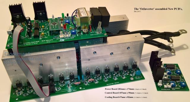

Clockmanfr
Joined: 23/10/2015
Posts: 437
Posted: 09:19am 30 Jan 2019
LadyN,
Regards Schematics........
From my latest Book, on the brief introduction to the OzInverter PCB's.......
The New Power board has been developed using known existing technology’s and improved. It matches the new 8010 OzControl board.
As I have said before my Philosophy, keep things SIMPLE, ROBUST and COST EFFECTIVE. With that in mind our Power Board, OzControl Board and the OzCooling Board PCBs are of as simple design as possible, with through hole components that are easily obtainable, the only exception is the SMD 8010 Chip on its own sub board.
For builders across the World we made it a deliberate policy to make Robust boards that were also easy to assemble and easy to repair in the future. We also kept the OzControl PCB and the OzCooling PCB as single sided for home etching.
The PCB’s were deliberately designed for extra-large tracks and large copper areas around component pins so to avoid substrate separation problems when repairing. All component values are printed on the PCB’s, a sort of Painting by numbers. The Power board has double copper thickness and large tracks and added copper to elevate pinch areas.
What we are doing goes against the modern day concept of SMD components and Multi PCB’s that are small as possible, However this is real Power Electronics, so we have put a lot of thought in getting a good long life out of the OzInverter.
Please note, and before you ask, ….. like ‘Oztules ‘ I do not create schematics drawings anymore as modern PCB design software means that you can build the circuit in real space. It is very important that some of our components MUST be as close as possible to other components, and therefore a schematic is insufficient to explain this

Posted: 06:28pm 30 Jan 2019
You CAN do it that way, but it is never done like that by professional circuit board designers and for very good reasons, it becomes far too error prone when the circuitry becomes very large and complex.
A professional design always starts out with a hand drawn circuit diagram, or series of circuit diagrams.
The next step is to enter that schematic into CAD software which not only generates the familiar schematic, but does a number of other things as well.
Each component is precisely defined, not just by the well known symbol on the schematic, but the footprint on the PCB, hole sizes, pad sizes, component value, function of every pin, and full characterization of the electrical characteristics. That can become quite involved for integrated circuits.
Creating a new component for the component library can be very time consuming, so it can sometimes take days to create a schematic that has a lot of new or unique parts.
That information is complex enough and the software smart enough that you can then do an electrical rules check, and the software will tell you if you have screwed up. Any unconnected floating pins or errors such as missing grounds or missing supplies, or accidentally linking two output pins together, will bring up error messages.
From the schematic a net list will be generated. That is a list of all the nodes on the schematic that connect directly together, along with defining specific track functions such as power, ground, signal etc. Later this can be used to set different track widths.
The schematic and its component libraries are also capable of full dynamic circuit simulation using "spice" or other circuit simulation, and you can look at various nodes with virtual test equipment. Its almost like building the whole thing on a breadboard and being able to view waveforms on a virtual oscilloscope, measure dc and ac voltages, view spectrums in the frequency domain, etc.
All you need is a correctly entered schematic to be able to do all of that.
When the schematic is known to be completely error free and passes all the required automated tests and checks, its time to start on the actual board.
Major components can first be manually placed if required, and any ultra critical tracks or features then manually placed.
Things like controls and indicators for example at one end of the board, location of connectors at the other end perhaps.
Then you hit "auto place" and every other non critical component is automatically placed onto the board in a very logical way that ensures minimum track lengths. This takes about a couple of seconds to place a hundred or more components all very neatly placed and spaced for a pleasing result.
If that all looks o/k, you then hit "auto route" and every single track on the board will be run, thin ones for signal, thicker ones for power and ground. That might take about ten to twenty seconds for a board with a hundred or more integrated circuits and several hundred minor components.
And you can be absolutely certain that the circuit board will be totally error free, but only if the components specified on the schematic have been entered correctly with the correct footprints, dimensions, hole sizes and so forth.
For a nicer final result, and to make it much easier to fault find later on, its possible to edit all the component designators on the PCB so that R1 is next to R2 which is next to R3 etc. And all the IC's line up U1 then U2, and so on. When the PCB component designators are edited, it automatically oes back and changes the component designator on the original schematic.
If you have ever looked at a really complex motherboard that is a foot square trying to find R168, its a lot easier if the components are physically grouped in some kind of numeric sequence.
Saying that schematics are no longer required is simply not true. Laying out the schematic and correctly specifying individual components is about 95% of the work.
The actual physical circuit board layout is then just about totally automated these days.
That is how the professionals do it. And circuitry is now so complex with tiny surface mount parts both sides, and maybe a dozen layers of tracks between, its just no longer possible to do it error free by hand. Once you have used design software like this there is no way you would ever go back to doing it any other way.
Once its done, the software will also print out a full parts list again without any errors or omissions. It can even produce a three dimensional picture of the final board so you can see what its going to look like from any angle. Amazing stuff !
And absolutely EVERYTHING relies completely on the original schematic you entered.

Posted: 08:50pm 30 Jan 2019
High frequency power electronics share many of the same problems of RF design, in that physical layout and component placement can be critical to success.
A schematic might suggest that just just joining up all the components any old way that is convenient should work just fine, but sadly that can lead to difficulties.
Using a proven circuit board such as Clockmans gets you off to a very good start, but there can also be difficulties beyond the circuit board with grounding and magnetics design, as well as cooling that can come into it as well.
The higher the power level the more difficult it can all become, especially for a novice. And some of the concepts can be difficult to explain in a simple manner.

Posted: 10:24pm 30 Jan 2019
LadyN,
1. I know that 'TinyT' did the schematics and they seemed okay. Putting them in the 2nd edition?..... Maybe 'Tinyt' might approve of them being used, I just haven't got time to do them myself. Note, I spotted a couple of missing bits when I first looked at those schematics first thing this morning.
Electronic copy, yea hmm, I have seen scams and work sold onto others with out acknowledgements, that were generously given by others. So not at present.
If they scan it they scan it, but each page is copyrighted and my books have official ISBN numbers, look on Amazon for ISBN 978-0-9935903-0-6
And besides so much easier when making stuff to have a A4 size booklet with large colour photos that explain things more than words can sometimes. And to get coffee mug stains on, like my ever faithfull 'Hugh Piggotts' 'Make a Wind Turbine' A4 booklet.
Warpspeed.
I am not against schematics I used to work with them in the late 1970's, Heathkit days, gosh everything was so clunky. In the mid 1980's I did some prototyping stuff with DOS software, I hated rat nests, and operating the software became a whole profession on its own.
After that I stuck with my CAD and Micro engineering profession and work with mechanical manipulation of metals from 40mm to 4 micron.
In 2015 I purchased some 'Target' PCB software, it was all I could find at the time for a reasonable cost that would integrate with my CAD, and just got on with it to create the OInverter PCB's. Funny to see that nothing has really changed in the in-between years, and the pin layouts are still in divisions of an Inch and more jargon introduced.
And yes, the 2nd edition will be more specific, about How to, where and how things are placed and fitted in regards cooling, cable layouts, positioning of main components etc etc. And the Don't stray from the road that works sentences.! Edited by Clockmanfr 2019-02-01

I have actually finished that chapter, but it would be nice to add schematics of the Power Board and the OzControl board, so I will add/push another page in. I get stuff printed in colour so colour tracks, if that helps.
I will look closely at your schematics.

Tinyt,
Obvoiusly you are 4 FETs with 4008.
I have checked the 2nd and 3rd schematic you originally posted. Both seem okay... for the power board I will put a note that 'check the IDC cable is correct' and probably those 2 10nf 250v suppression caps that go to the boards fixing holes.
The control board needs those decouples 10uf and 100n caps, bypass/alongside the 1k resistor that comes from the ON/off switch to ground. Pin 6 is super sensitive to switch contact bounce, and the cable sensitive to other nearby cables and can/could pick up parasitic's.
Here is the OzControl board for the US at 60HZ.
