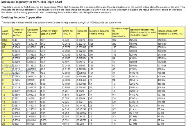

Was reading on AC skin effect on copper in one of the AWG chart in the web, it shows that at 21KHz the 100% skin depth is 0.91186/2 mm or 0.0359/2 in.
So, it seems that to make effective use of the copper wire(s) for the windings, they should be stranded or (x-in-hand). And the diameter of each wire strand should not be larger than 0.91186mm or 0.0359 in. Should this be observed?

Yes that is quite right about the skin depth, the actual formula is 66 divided by the square root of the frequency in Hz.
Skin depth works out to 0.43mm at 23.4 Khz, and the optimum wire diameter will be twice that.

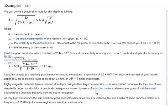

I tried the approximation formula found in wiki:
And I came up with a skin depth of 0.449 mm for 21KHz. I think the 0.449 mm is the radius, so the diameter is twice that or 0.9 which is close to what the chart says.
And should the multi-strand also apply to the secondary (230VAC)?

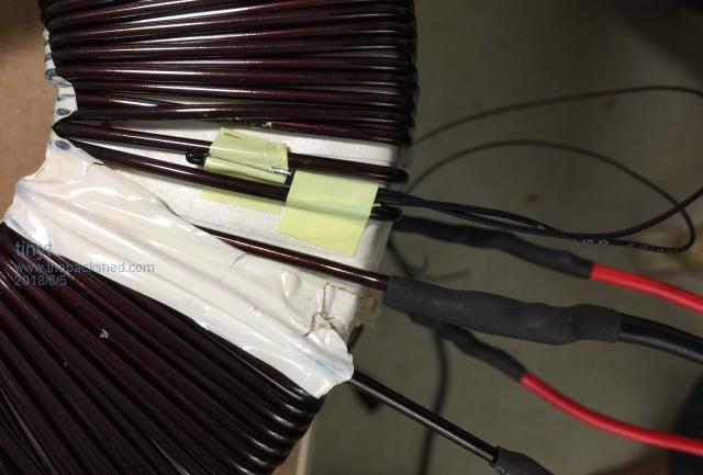

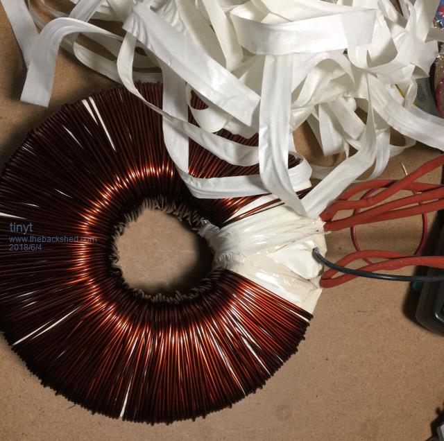

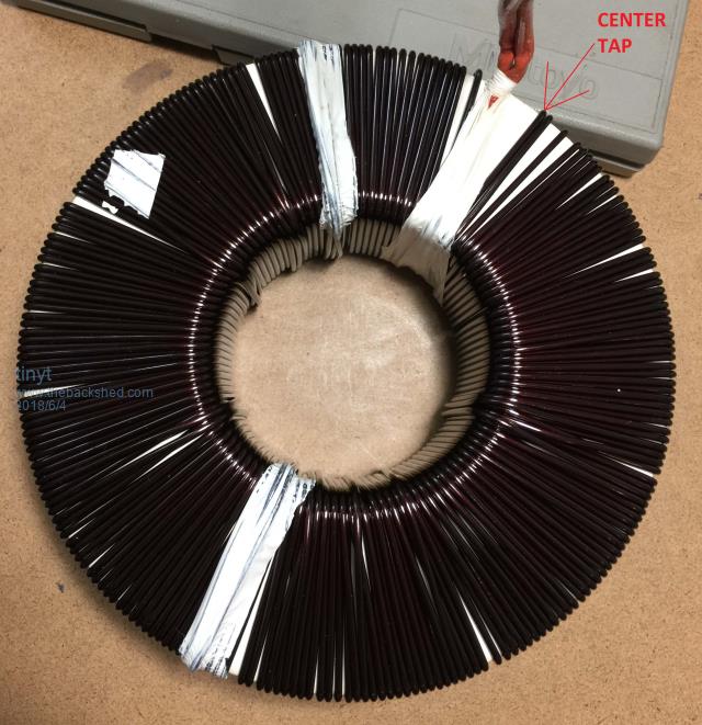

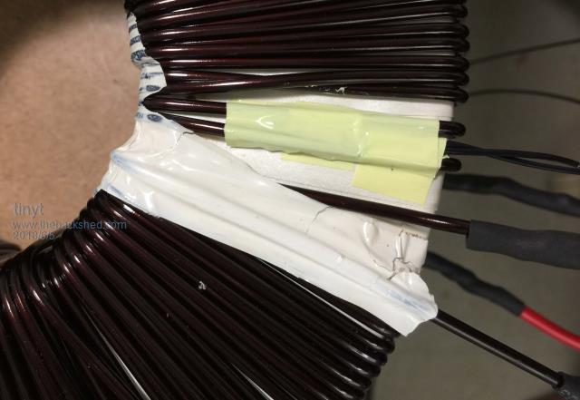

Started working on the datatel elektronik toroid. It has the following ratings: 153V 50-60Hz, 230V/9.6A. (2.2KVA?). Using a variac and temporarily wound 20 turns, I calculated that it has 1 turn per volt winding.
Started de-mummifying:
The 153 vac outer winding is 2 in hand awg #12, followed by an electrostatic shield and finally the single layer 230 vac awg #11. I removed the outer and shield windings and retained the inner 230 vac winding. Applying 100 vac to the 230 vac winding, I located the center tap by looking for the mid-voltage with a voltmeter connected to one end of the winding and the other voltmeter probe attached to an X-acto knife blade. With the sharp tip of the blade, I poked thru the insulation of the magnet wire looking for a mid-voltage reading. The center tap measured 50 vac, but the wire beside it measured 99 vac. I think the winding is split-return type as the center-tap is close to the start/end of the winding. See picture.
I cut the center tap giving me 2 isolated and equal voltage windings which I can configure for 115 vac or 230 vac. For 115 vac, I will connect the two in parallel.
I guesstimate that the core has the following dimensions: ID = 3.5"(89mm), OD = 7.5"(190mm), HT = 2"(50.8mm) giving a core cross section of 2" x 2" = 4 sq. in. (2580 sq mm), maybe my estimated dimensions are a little bit conservative. The toroid ID with its exposed 230 vac winding is about 3.125"(79mm). If I add the 26 vac winding now, there will be a lot of wasted space in the toroid ID. So I plan to add another layer(s) of two 115 vac windings and adjust the cross section area of the 26 vac wire.

So, I am guessing that the core will be able to handle higher power output than 2.2KVA before saturating. The 60 Hz instead of 50 Hz will probably also help.

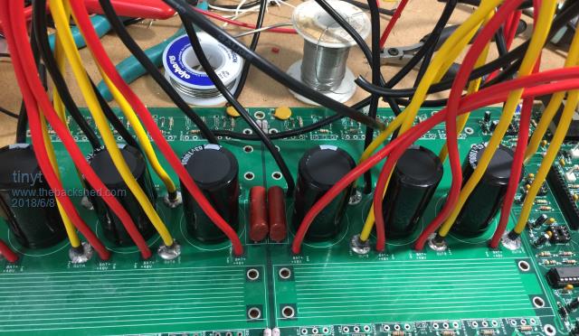

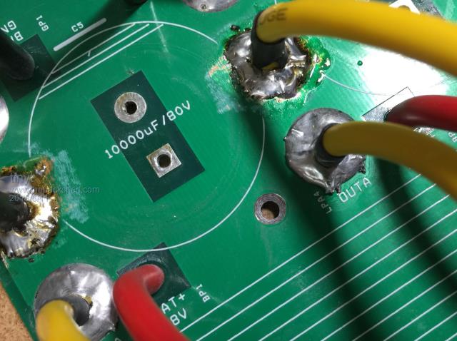

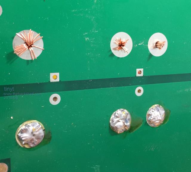

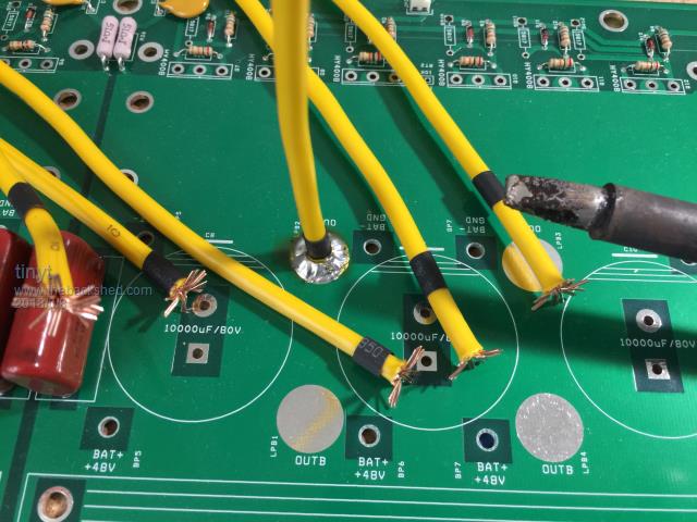

Started to solder awg #10 wires for the transformer connection. The black heatshrink is to prevent the strands from spreading out during soldering.
Doing the bottom for the battery wires. Notice the creepy crawlies coming out of the holes.
Top view shows the forest of wires, all of them are awg #10 (2.588mm, 5.26 sq.mm).
So for the 6 group of the yellow wires for each of the transformer primary connections, the total cross section is 31.56 sq. mm, equivalent to 6.34 mm dia.(awg #2)
The battery wires are 8 each ( 8 red for +, 8 black for -), the total for each polarity is 42.08 sq. mm, equivalent to 7.32 mm dia. (awg #1)
tinyt

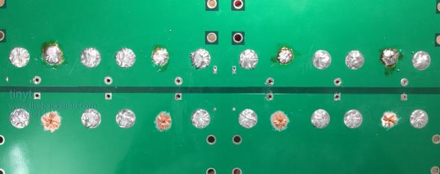

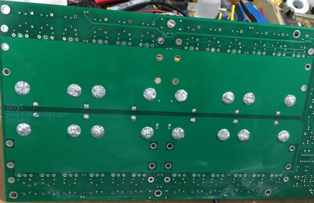

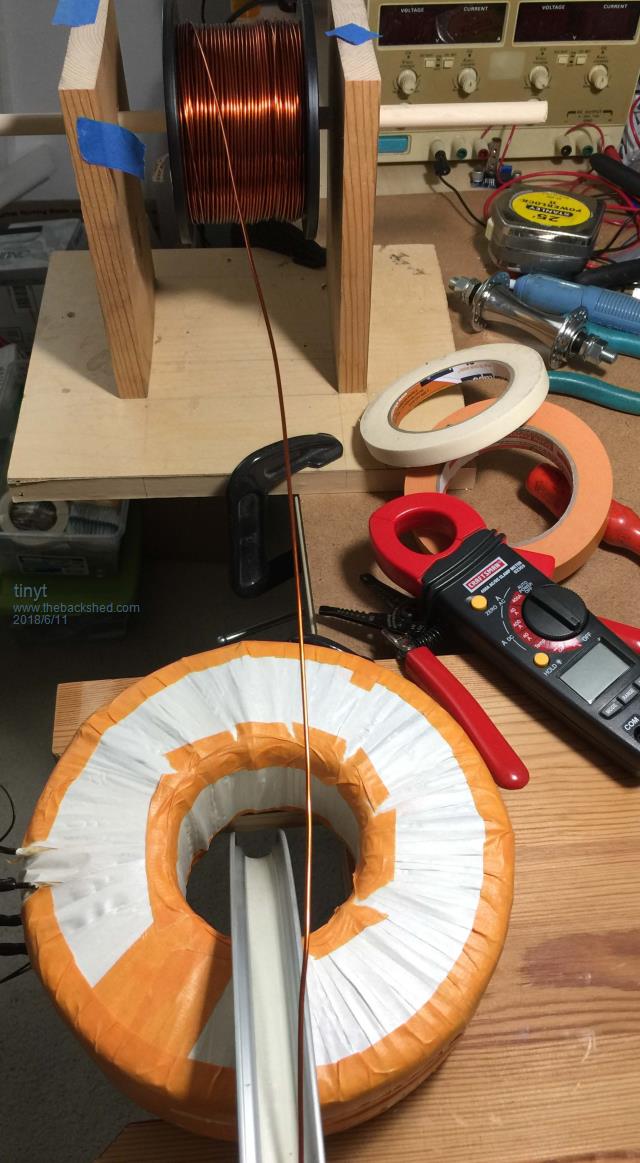

Added more awg #10 wires. Drilled new holes for the battery wires with the top counter sunk to prevent shorting the top and bottom layers during soldering.
Yellow wires for tranformer connections are now 9 and the battery wires are now 12 for each polarity.
So the equivalent cross section areas are:
Yellow transformer connections: 5.26 mm x 9 = 47.34 sq. mm or 7.7 mm dia. (between awg #1 and #0)
Battery connections each polarity: 5.26 x 12 = 63.12 sq. mm or 8.96 mm dia. (between awg #0 and #00)

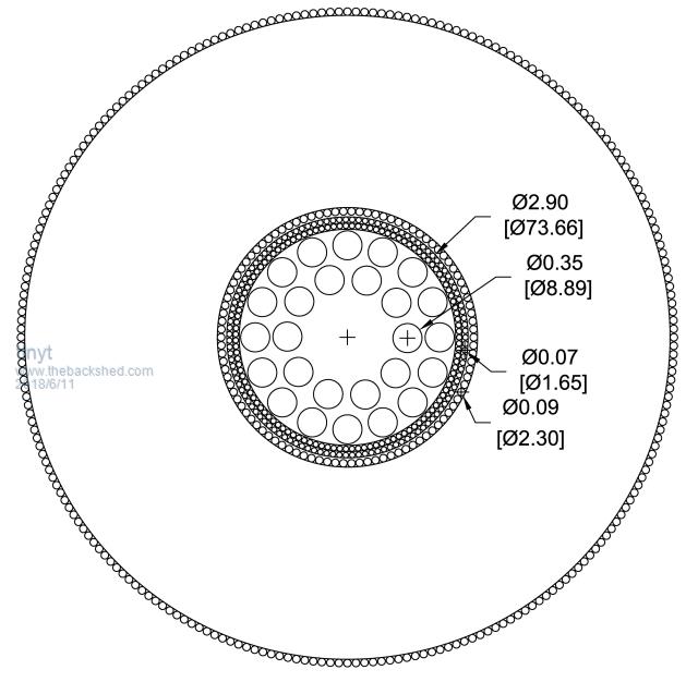

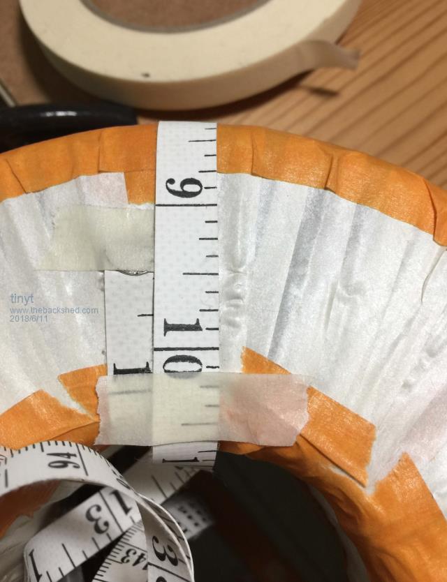

I re-used the white insulating tape that I un-wound earlier and used my wife's flexible measuring tape to approximate how long each turn of the first layer will be.
The toroid ID for the added first layer is about 2.9 inches (73.66 mm). I sketched in autocad the layers and found out that if I re-use the awg #12 that I un-wound earlier, the primary will not fit. Since I have awg #14 left over from an earlier project, maybe I can use it. From the wire table, this makes the equivalent cross section area of the 230vac wire to be 4.17 + 2.08 = 6.25 sq. mm. The primary should have 9 x 6.25 = 56.25 sq. mm or 8.46 mm. dia. (0.333 inch) I re-drew the sketch with the new dimensions and looks like everything will fit (I hope).
So I am now loading on the bike tire rim the awg #14 wire. I might have to buy more for the second 115vac winding.
