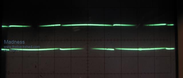

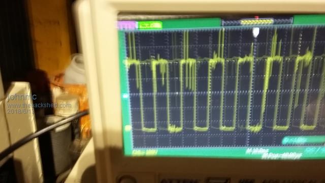

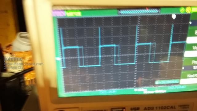

Posted: 11:19am 13 Jun 2018
  johnmc said
Good Day all
As per Madness list above,
Tests 1-4 all good
Test 5 SPWM not quite symmetrical
With 4 fets fitted toroid fitted and no restriction to the 50v power supply
sinewave as previous post
Test 6 all 24 FETS fitted no capacitors,
15 ohm resistor in series with 50 v battery supply
No toroid fitted in the following pictures,
Picture of powerboard low side Fet output
toroid low side Fet output
Picture of powerboard high side Fet output
Has any one taken pictures of the powerboard with no toroid as there stil appears to be too much hash and as I have now destroyed 170 Fets I am going to be more cautious .
cheers john

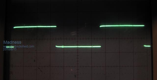

John that does not look right to me, the square should be very clean and crisp with virtually nothing other than the horizontal lines on the CRO. What I have done before is connect the 18VDC on a control board to the output of the 2 diodes from the VFB transformer near the centre of the of the PCB. You can then adjust the voltage trim pot till the EG8010 is happy with the feedback voltage and it will run with no power board. You can then use the square wave output to apply the square wave gate drive to the input of the power board gate drive circuits individually.
There should be just an extremely faint line between the high and low of the gate signal. I have seen a full brightness line there which was a fault in the PNP half of the Totem poles.
Should be like these.

Gary, it is failsafe. I have a remote switch box (it houses all the on/off switch & reset plus all the LED's) and if that is not plugged in at all nothing happens.
You see, that permanent 10K to ground from the SPWMEN input (pin 6) stops all mishaps in case of switch or reset malfunction.
Your last CRO pictures of the EG1810 wave form is exactly what I observe. That overshoot on John's pictures needs investigating, perhaps he has a few decoupling caps missing?

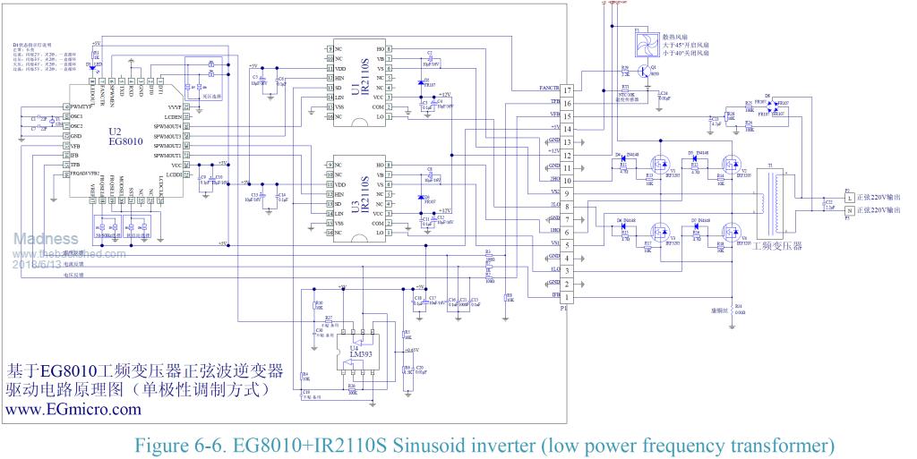

BTW, When I did my control board I copied something I saw on the original EG002 boards. These had a 5K1 pulldown (to ground) resistor at each of the 4 SPWOUT pins (27-30) of the EG1810 chip. Not sure exactly what they do but the trace always looks good.
Posted: 02:01pm 13 Jun 2018
Interesting, those pull down resistors are not on here and I can't see a reason to add them, just ordered another 50 PCBs 5 minutes ago anyway.

Posted: 01:00am 14 Jun 2018
cheers john
Using a picture of the powerboard, where is the 'scope ground and 'scope probe connected for your pictures.

Correct. I was referring to this diagram: first page
There are also interlocking transistors shown, which I did not include.
Posted: 09:15am 14 Jun 2018
  Madness said   Interesting, those pull down resistors are not on here and I can't see a reason to add them, just ordered another 50 PCBs 5 minutes ago anyway.
Well, your board seems to work anyway, I just wanted to mention what I did differently...

Posted: 10:47am 14 Jun 2018
Good Day tinyt
The scope pictures were taken with the 50v negative attached to the to the power board negative PCB rail and the 50v positive attached to the positive rail via the FET heatsink.
The scope earth lead connected to the negative supply ( the scopes earth led is isolated from the 240vac scope supply
The scope probe was connected to the inverter output, that would have gone to one side of the toroid ,
This hash is found on the control board output, with out the power board connected.

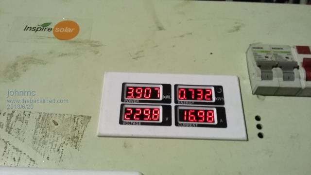

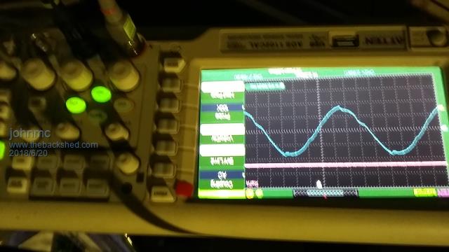

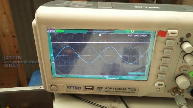

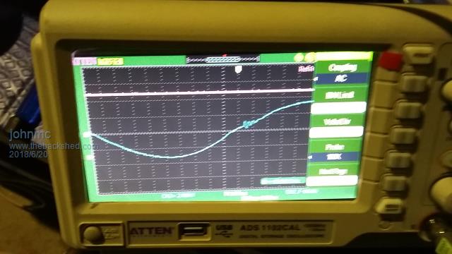

Posted: 10:33am 20 Jun 2018
Good Day All
Managed to get the inverter up and running with a full complement of fets and capacitors and driving 4 kw of heaters
The no load sine wave has a small oscillation
the enlarged view of the oscillation
the transformer has very little noise under load from 1 kw to 4 kw the wave shape does not alter but it is not ideal either, could this wave form be because the transformer choke /inductance coil is only on one leg?
The over current SCR was reset as with out drama thanks madness.
Having trouble shutting down the control board, at present the only save way for me is to disconnect the 48volt supply to the power board then the 14 pin plug from the control board.
Have managed to blow all the fets twice now when I try to use my inverter welder which has a rating of 3.6kw.
This is still a work in progress cheers john

Posted: 10:46am 20 Jun 2018
Good to see you are making progress John, the choke only needs to be on left bridge as you look at it from the 10 pin connector side of the power PCB. That is the side with the 20KHZ SPWM, the other side is 50HZ square wave.
The wobble at zero crossing is most likley to do with your choke, what are you using? The distortion at the peaks is something I have never seen before.
Switching off should be no drama, the centre pin of the switch connector on the PCB is switched to 5V for on and to ground for off. Is there possibly a bad ground connection there and did you follow the mods required for the switch in the word document I posted?
