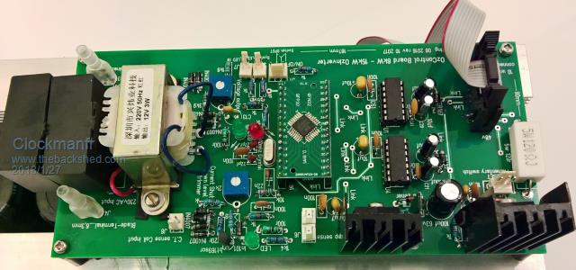

Notice the word HOT on the sinks..... this is the one that will heat up the most under heavy load.... so it is to remind me to put the fan at that end... It rarely gets over 40c in practice.... so keep that in mind when designing your cooling, it is the spwm end of the board, the other end is 50hz.

Have you got a reason why this one should heat more than its neighbor?
Might be worth while to choose that one to mount the NTC sensor on too if that is so.

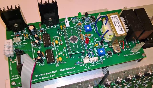

Another tip Mark, plug both of the SIL carrier strips to the little 8010 board and solder it to the control board as a unit.
This keeps both SIL sockets lined up correctly. If you solder them individually they might end up a little sideways and make plugging in the little board much harder.

"Have you got a reason why this one should heat more than its neighbor?
Might be worth while to choose that one to mount the NTC sensor on too if that is so"
Yes Tinker, that is the one I use for the temp sensor.
It is the SPWM end, so the switching losses are higher than the 50hz end. The high side should be worse, but isn't, and shares the heat sink with the colder high side 50hz.... sorta averages out I guess.
The drive signal on the high side seems to be so good as to be about the same losses on both the high and low sides.
So the smallest heat sink with the highest frequency gets warmer than the other three quadrants.
Once the fan system is installed, it rarely gets much over 40c, unless your really driving it hard, but that is generally for short periods ( 10 mins or so ). Unusual to run more than 4kw for extended periods.... unless your backfeeding from a big GTI.
Periods extended over 5kw will activate the 20amp breaker after a time interval governed by the breaker curves. They are pretty generous, but 8kw for more than a few minutes can trip it.
........oztulesEdited by oztules 2018-01-27

Here is a link to the latest boards that are all component populated.
http://www.echorenovate.com/the-ozinverter.php
Trust this helps.

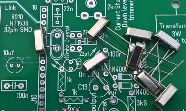

[quote]...oh, and make sure there is clearance for the crystal above the board ( say 1mm air gap )[/quote]
This may seem like a very minor point, but it is not.
The metal can of the crystal can quite easily short to the two pads underneath if there is zero clearance, and that would cause an instant major inverter mosfet blow up if it ever happened, without the cause being obvious.
There are special crystal isolating insulators available on e-bay, or use a pair of really tiny fiber or plastic washers, or punch a couple of pin holes through an insulating sheet of "something". It may save a lot of tears.

Yes Warpspeed is correct.
Be careful with the crystal can when installing.
The can package to legs insulation is small and could easily short to a leg wire solder pad.
As this is a via pin on both sides of the board, reducing the diameter could lead to a weakness with the pad and substrate. And solder flows and does a neat upwards cone around the wire legs.
A Moisture installation environment could be issue with the OzInverter, and I have done wide spaced out tracks to elevate this, with reasonably free space around each component.
I tend to have the can positioned with 1mm to 1.5mm above the board, ie the crytall legs can take the load of the can weight.
See photo of crystal can legs length, that one has ben removed from a previous PCB board.
