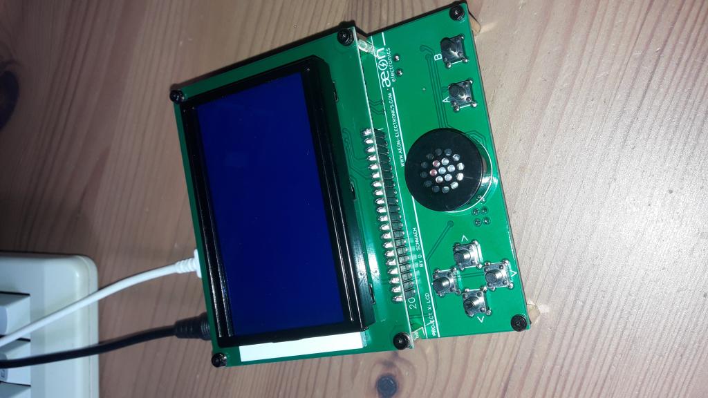

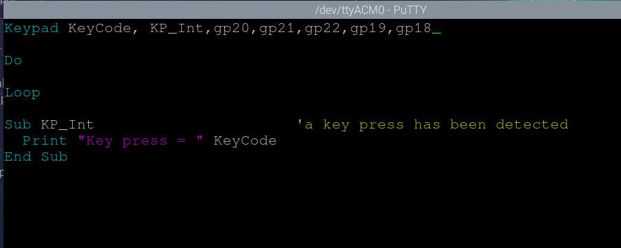

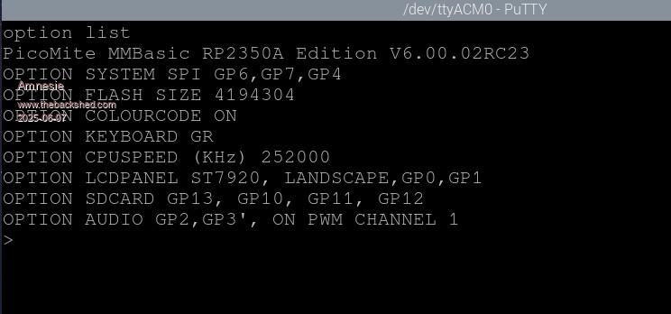

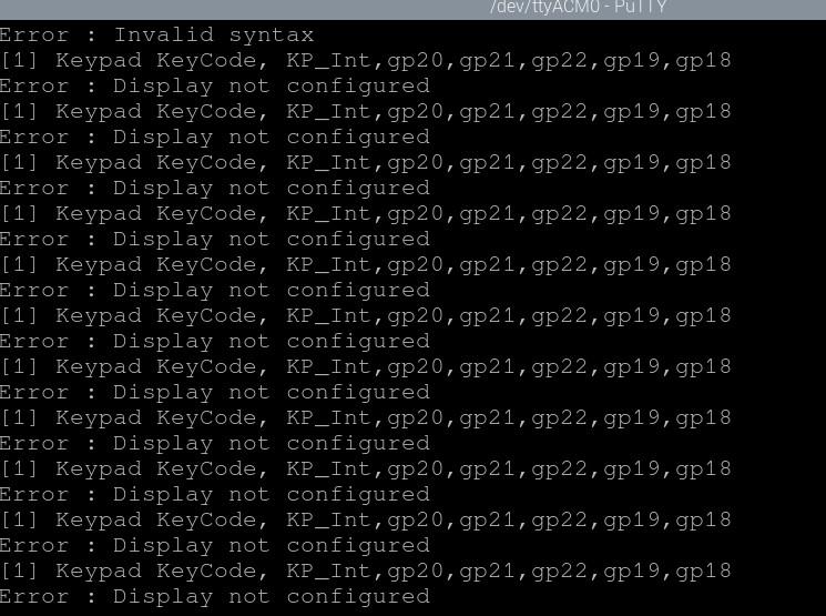

Hello, I think I found a bug...
can anyone confirm this? I was trying the Keypad feature, see for yourself:
I tried also tried a different syntax, always the same. I am using as you can see a 128x64 LCD...
Because of the "display error" in Putty I also tried to do something like:
option display 24,80
Problem persists. I have a 2 row by 3 column keypad.. I don't know what I am doing wrong.

Posts: 12176
Posted: 03:22pm 06 Jun 2025
Obviously the error isn't right but manual page 55
  Quote  The PicoMite firmware supports either a 4x3 keypad or a 4x4 keypad

Posted: 03:28pm 06 Jun 2025
Hello Peter,
thank you a lot for your reply! Ahh this is my bad. My PCB is already designed for an 2 by 3 row Keypad... Hm.. Ok. Then I have to do a redesign. I assumed, that it would be no problem to allow a smaller keypad. Sorry my bad
Or is there a work-around possible?
I have some pins left, that I initially wanted to use for GPIO...
Greetings
Daniel
Edited 2025-06-07 01:34 by Amnesie
Posts: 12176
Posted: 03:35pm 06 Jun 2025
If you have two unassigned pins then just include these in the keypad command and your PCB will work fine. Otherwise just run the scan in a timed Basic interrupt
Edited 2025-06-07 01:36 by matherp
